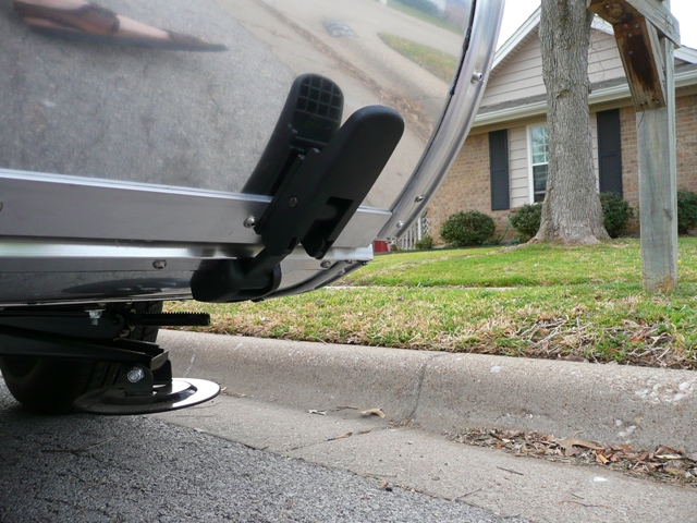

Can you provide a link/source for the black units shown below that you use to close your hatch?
I like them better than the metal draw hasps.
Thanks for sharing this build.
aggie79 wrote:
In hindsight, I ended up placing a piece of flat aluminum on the hatch to cover the gap. The aluminum projects beyond the edge of the hatch. I probably would have been okay just placing a seal on it rather than using the double P-seals. I don't have a good picture of the flat other than this one that shows the hatch closed and the rubber latches that I use to keep it closed while in transit.

Hey ukwarrior - that photo isn't my teardrop - augie99.

IIRC Tom (aggie79) got his draw latches from McMaster-Carr; perhaps these.

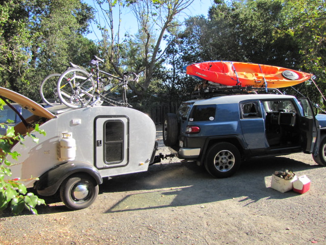

Just back from a two week trip around Oregon: Crater Lake, Smith Rock Climbing, Hood River, Coast with a final night at Jackson Wellsprings in Ashland. Great trip, tear drop and Fj performed flawlessly! I just added the small propane tank and mounting along with a new Partner Steel Stove. Really helped to have more propane for the trip.

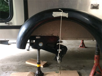

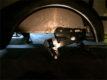

I am replacing my stock suspension with Trimbren HD 2000. I went with the 4" lift version to get some higher off-road clearance. Removed the old axle and springs. The hardest part so far was cutting away the overlapping wood and aluminum from the frame. Both sides are mounted, now I need to add a cross member. The HF trailer has a cross member, but I want it to be extra supported.

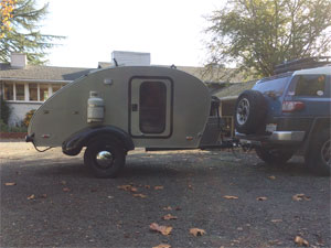

Postby drewh1 » Sun Dec 03, 2017 5:28 pm
Came out well, 18" of clearance with the 14" wheels. I was able to center the wheels in the fenders better. I can get a couple more inches with bigger tires and wheels but for now, i'll live with it.
