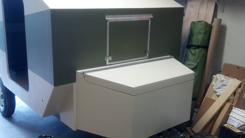

The lid fit back on the tongue box surprisingly well, there's just one 1/2"x1/2" area that is rubbing at one of the forward corners that I'll fix over the winter.
20140921 tongue lid fit small.jpg (101.98 KiB) Viewed 2515 times
You can also see how close I played it with the tongue box vs AC door, and when I built it, I'd thought of using a piano hinge and hadn't thought of how high a hurricane hinge sticks up above the surface...

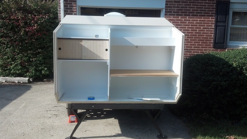

Then I moved over to the galley doors, I really should have thought ahead and rabbeted the shelves for the sliding door track, because screwing the stuff in is not easy, both getting it flush with the edge and also countersinking the track just enough to recess the screw but not blow a hole through the track are not very fun things to accomplish.
20140921 galley doors small.jpg (144.5 KiB) Viewed 2515 times

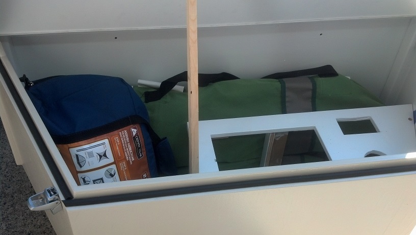

Next up was mounting the power panel on its new legs and making sure that it fit nicely. Turns out I was right about our chairs and the dog's tent being able to fit inside. :D
20140926 tongue box fits small.jpg (91.53 KiB) Viewed 2395 times

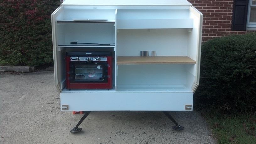

I put two barrel bolts on the lower hatch to hold it closed before the upper hatch can be lowered and overlap it. The oven's drawer isn't installed, we needed it out there to decide on the Formica pattern for the counter top.
20140926 lower hatch small.jpg (130 KiB) Viewed 2395 times

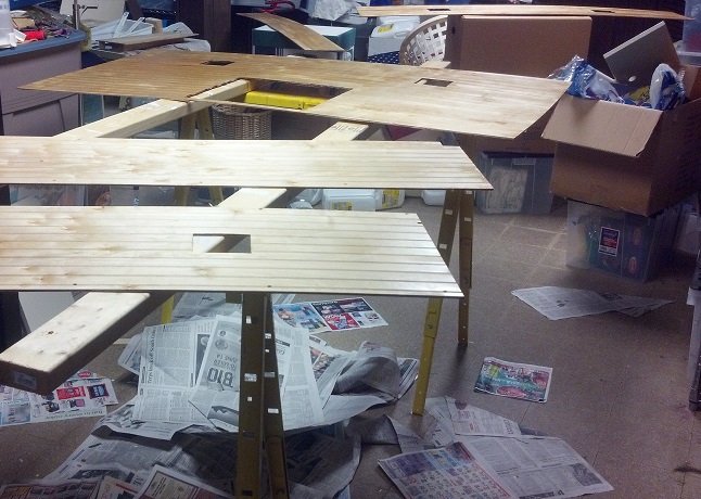

And then I finished up the day by putting the first coat of varnish on the ceiling panels.
20140926 ceiling varnish small.jpg (134.98 KiB) Viewed 2395 times
I really don't like how much work has to go into polyurethane, but I think the light color of the wood will really lighten up the cabin.

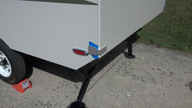

I need to figure out the prop rod, I'm thinking a piece of 3/4" plywood pivoting near the top of the galley divider, going into a pocket made from 3/4" ply on the inside of the hatch with a pair of aluminum angle bracketing it and a push-button quick release pin going through both pieces of angle and the rod to lock it into place. The 2x4 is cut to hold the hatch where I want it when resting on the prop. It's low enough to be opened when stored in the garage with about 2" clearance from the bottom of the garage door (I store the tear with the hitch in so it can go under my table saw and save a bunch of space), but the garage door must be open in order to open the hatch, I'm about 6" short on garage space for that. That should make loading the tear easier in the rain, the only time we'd have to get wet would be while turning the tear around and hitching up.

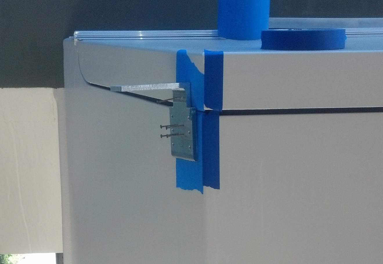

Then I attached the latch plates, I'll have to trim the body sides of each to not interfere with the marker light and I'll need to relieve the inside of the hatch piece that overlaps the body so that it doesn't rub on the paint (there's a ~1/16" mismatch on one side of the camper) which will probably be done with a file vs making a trip to use the milling machine.
20140928 hatch latch small.jpg (146.67 KiB) Viewed 2253 times
I cut the two halves of each plate apart with a hacksaw and I'll break all the edges later this week with a file.

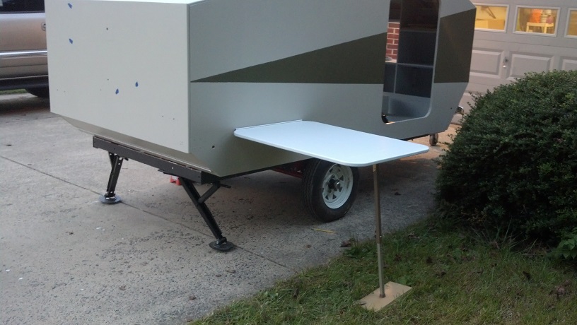

I also put the first side table on.
20140928 side table small.jpg (122.19 KiB) Viewed 2253 times
All of the blue tape is point out imperfections in the paint that I'll need to go over again. The other side table will be mounted with the long side against the wall and two legs so we can put the cooler on it, but I can't decide if I should put it up at the same height as this one (top of the table is 30" high) or drop it down 6" to make going in the cooler easier.
