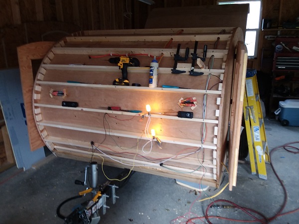

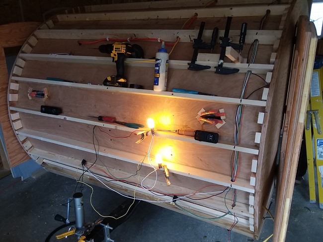

Took some time today to temp rig up the LED bulbs for my FLW interior lamps. I bought a pricey electronic dimmer for the LED's that I wanted to test. I also wanted to check the color of the LED light itself. I don't like the cold blue or harsh white. I bought warm white to get close to incandescent light if possible. So I twisted some wires together, attached some jumpers to the battery and gave everything a test. I'm as happy as can be. The dimmer works great and the color of light is what I hoped for. The picture may not show it well, but I can control the light from a mere glow to full blast.
A couple pics below with lights 1/4 lit and 3/4 lit with dimmer.

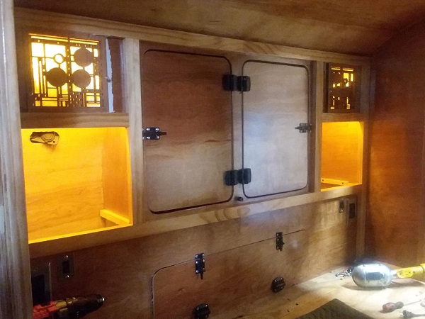

Thought I would post a pic of the first test of the FLW lamps in the headboard. I just cut a chunk of a canvas drop cloth that is for the PMF exterior use. I stuffed it behind the FLW lattice and tried it out. It makes for great lighting in the camper for 90% of the time. However I did not find it bright enough to read by. So I ordered up 2 aircraft style ceiling mount swivel spot reading lights to install overhead on each side of bed.
The picture does not do these lamps justice. The effect is not at all harsh light like it seems. The dimmer works great as well. You can really adjust the light for a nice feel to the cabin. I'm happy with the results.
You can see the hole in the back of one cubby hole under the lamp. That's for the 12v usb/lighter style outlets for that side of the bed. There is one on the other side in same location as well. So I am at about the half way point of completing my wiring. I intend to keep chipping away at it while the weather holds up.
