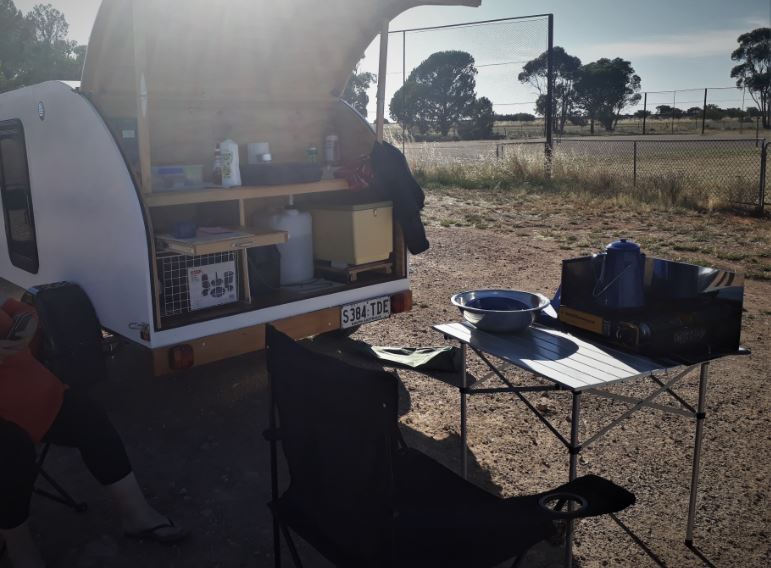

Washing up after breakfast.
washing up after breakfast NYD.JPG (74.43 KiB) Viewed 2856 times

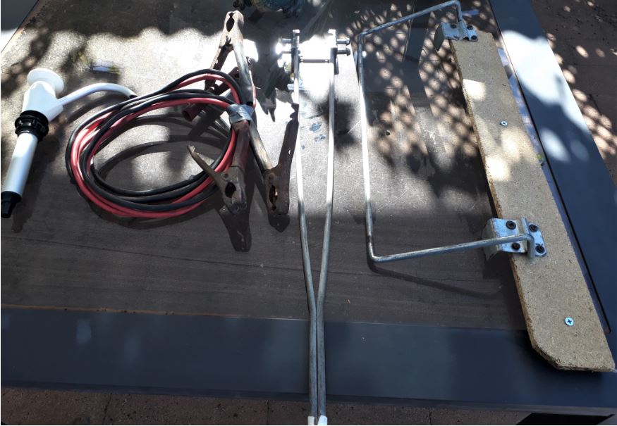

Pretty happy with the compact 2 burner Primus stove for $5. After cleaning it, I took it around to my mother's and hooked up her little propane bottle.
Turned it on and sprayed all the joints with soapy water. No bubbles, so I took the risk and lit the burners. Worked perfectly.
Also scored a brand new old stock manual sink pump for a caravan, a serviceable set of jumper leads, and a fold down leg and bracket from a convertible caravan dinette table/bunk set up.

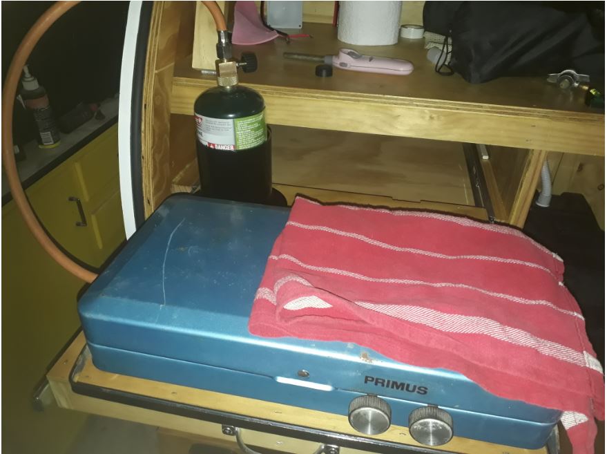

Took the missus to the Smoke for another doctor's appointment today.
Picked up this nifty little gadget for $12.98
Adapter valve.JPG (43.16 KiB) Viewed 2532 times
So now the heritage listed vintage primus stove runs on a Coleman bottle.
It lives.JPG (73.73 KiB) Viewed 2532 times

Today I got around to actually installing the stove.
I got some UPVC DWV pipe, glued on a floor flange, drilled it for mounting screws and painted it black.
Screwed to the drawer slide at the rear, it holds the 1lb Coleman bottle upright. At the same time, you just can't slide the drawer shut while the bottle is installed.
It's behind the heat/windshield/lid of the stove - I'm not expecting excessive heat.
Bottle holder.JPG (78.73 KiB) Viewed 2442 times
