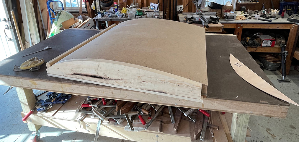

I had built a form to use to drape form the plastic.
It was nice and flat when I built it last week, but has since developed some slight sagging between the supports. Quite a drag. I can try and fill it in with bondo and try to sculpt it back to flat.... or maybe put a sheet of aluminum over the curve on the trailer and drape the plastic over that. Still thinking about it.

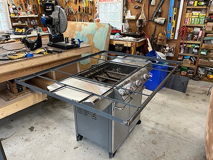

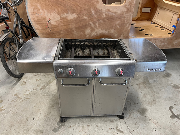

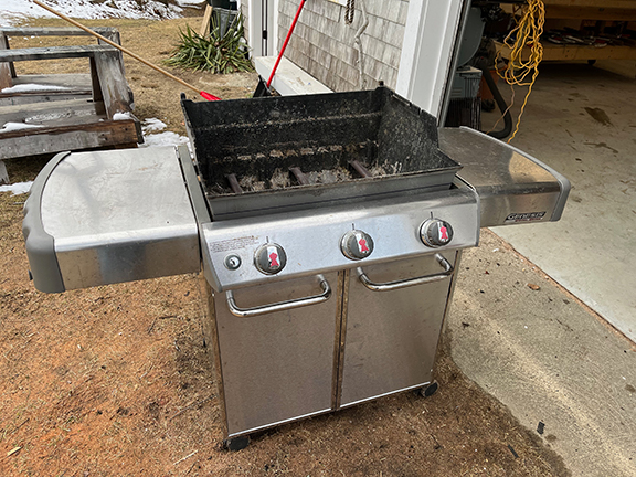

Also, I had planned on using a local powder coater's oven to heat the plastic and do the draping. But, I think I'd like to be able to have more control of the situation, and will build "an oven" to heat the plastic here at my workshop. Scored a free Weber grill on local Craig'slist, will slice/dice it up and build an insulated box over the burners. Will see how that turns out. Just need to get it up to 300°.

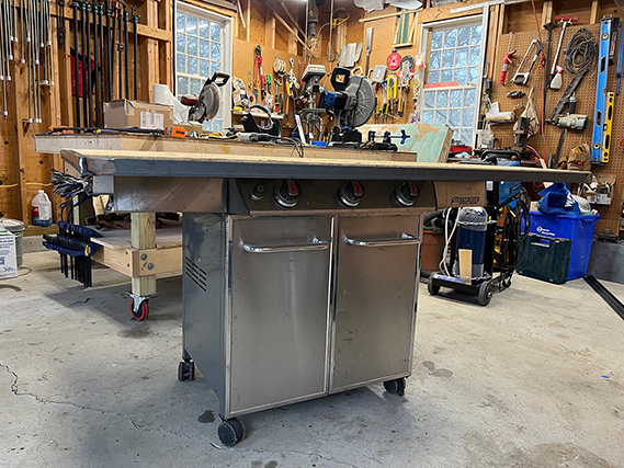

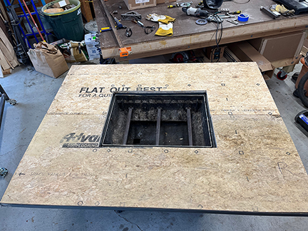

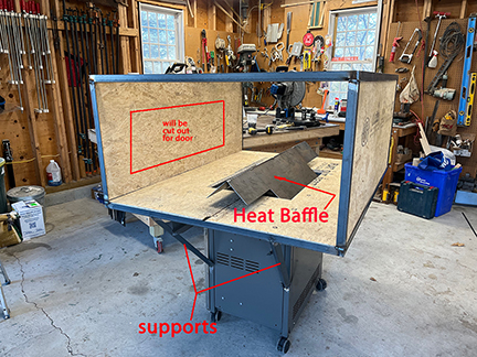

Gee... seems like it's been a while since I've posted any updates. I'm really waiting for the weather to warm up. Need a few 65° days to use the contact cement to install the aluminum, which is what's next up on the schedule....today was 52° so spring is on the way. I did travel to a new sign shop supplier to get a sheet of cast acrylic to heat bend for the windows. This sign shop supplier I found was great. Lots of inventory of different products. Huge warehouse. Wish I had found them before I purchased the aluminum months ago (which, by the way, has really jumped in price so guess I should be glad I got it when I did). I did get a 4x8 sheet of ACM (aluminum composite material) at this new place for some exterior moldings. It has 2 layers of .012 aluminum on both sides with a sheet of polyethylene trapped between the 2 aluminum layers. 3mm thick. Also comes in 6mm. For exterior use. Lightweight and tough. It comes in 5x10 sheets also...... and if I ever built another teardrop I'd consider using this for the sidewalls.
I did start on building the oven to bend the acrylic. Some shots attached. So far the grill was free and the plywood (seems like OSB underlayment) was a also a freebee. Purchased the angle iron and some flat stock for the skeleton to hold the OSB. I also purchased a roll of reflective heat film. I also have some Calcium Silicate blanket I'll use for insulation. It's too bad I'll just wind up only bending 2 pieces of acrylic with all the work to build the oven. Guess I should bend a couple of extra pieces in case needed. Tomorrow I'll weld the uprights and top structure. Hopefully won't burn the shop down.

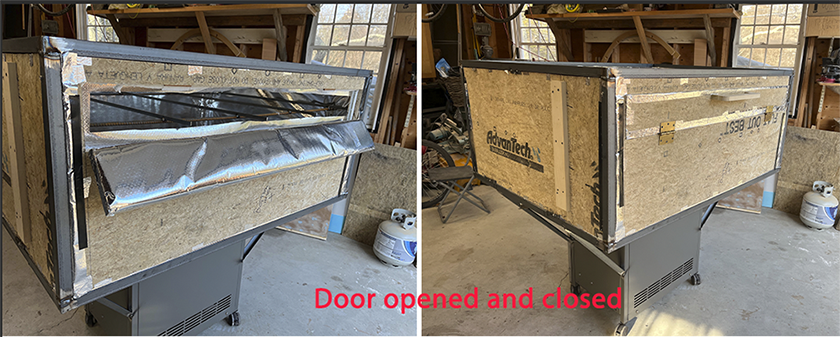

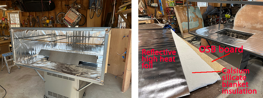

Got a bit more done yesterday on the "oven". I was concerned about the weight distribution (actually the weight of the structure sitting on top of the original grill structure) but it turns out it's not bad......and once I added the angled supports, it's all pretty solid. Think today I'll start installing the insulation and reflective material on the surfaces that are there. Might be a bit easier than trying to lean in there on a ladder if all the walls are up. And need to cut out for an access door.
Once everything is installed I'll have to see how the baffle performs....as in trying to eliminate any hot spots and making sure heat is evenly distributed. May have to add some through holes.

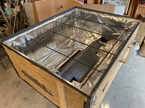

Postby Capebuild » Fri Mar 11, 2022 8:06 pm
Sharing some progress photos for the "oven" I'm building to bend the acrylic for the windows. Almost done. Just need to install the insulated top ply sheets and wrap with reflective foil. Ran out of adhesive backed foil tape.... so all will have to wait a few days to finish. The walls are composed of an OSB panel, with an insulation layer and a foil layer. Will need to get the oven to 300°F and heat acrylic for 15 minutes to 30 minutes.... or more. The suspended rack will hold a sheet of masonite wrapped in felt and the acrylic will sit on that to heat up. A big experiment at this point.

Postby twisted lines » Sat Mar 12, 2022 12:23 pm
I like the Baffle,
Moving that sheet in a noodle stage on the rack "may or will" be a challenge, if it doesn't sag.
My 2 cent's, I would try to use the advantage of the burner's one end to the other.
Get the sharper Radius to go first, lay down straight & flat on a form.
When it starts to move go slow, it takes a long time to start but when it starts it's fast and crazy.
Mick's neighbor used that thin aluminum sign board on his first build and it was fast.
Racking up; And Rapin foam
