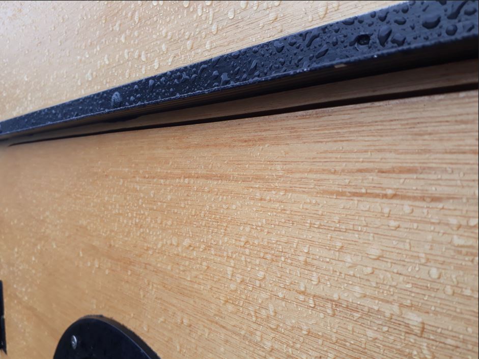

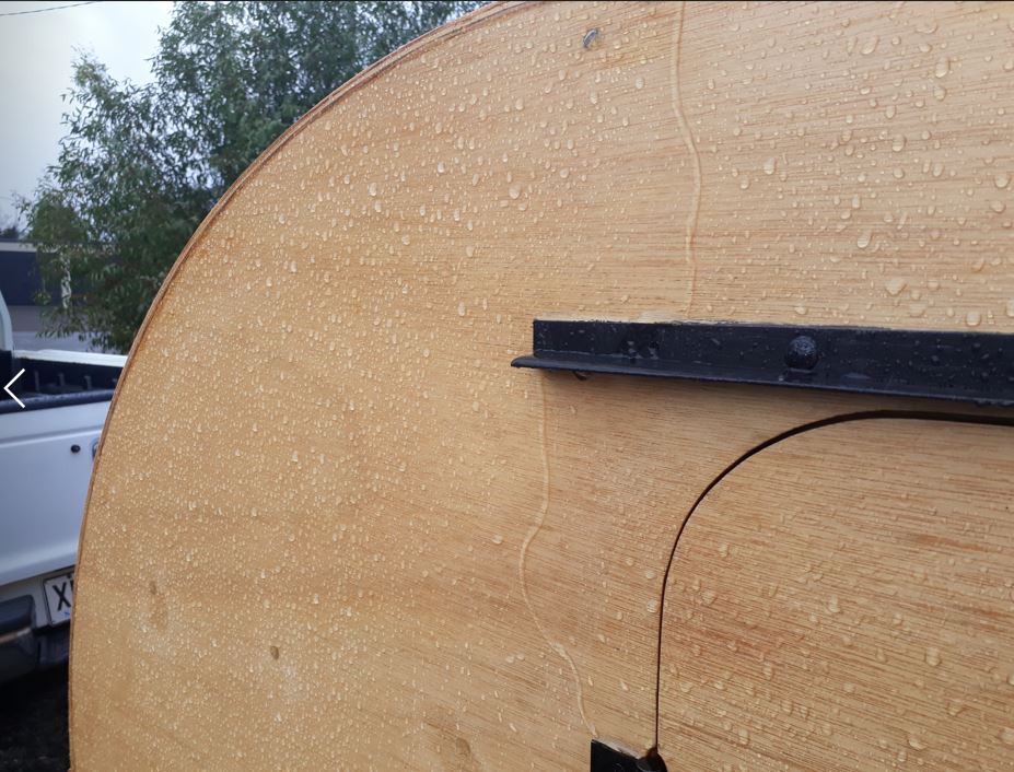

Postby MickinOz » Thu Aug 04, 2022 10:39 pm
Started raining.
Rain gutter could have been bigger, but it is doing the job.
The top of the door is dry, and the stuff running off the roof is being directed past the door and down the wall.
Some went in where it hit the hinge. This ran down the outside of teh door seal and out of the door opening.
No water inside.
Pretty basic, but works fine so far.

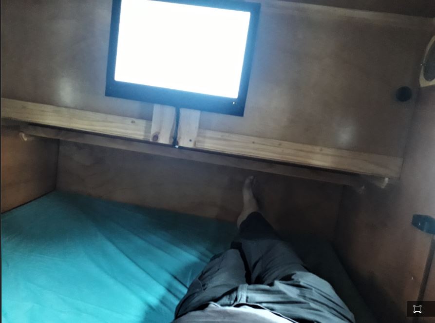

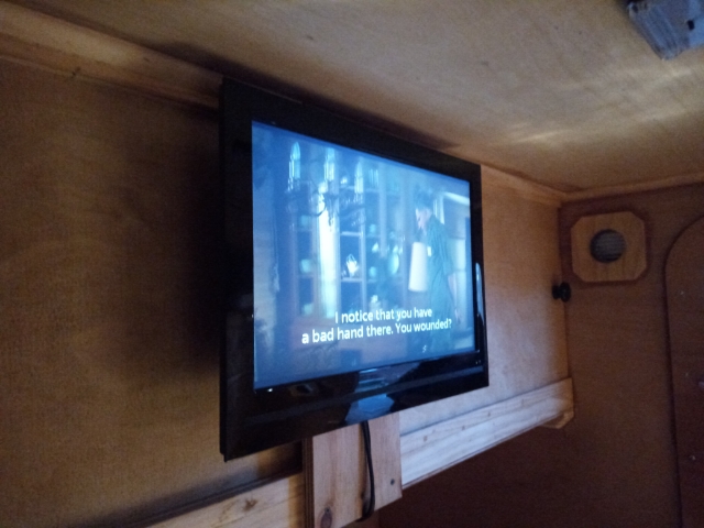

Finished the TV/DVD install.
Antenna is in the cabinets, the wiring has been run and terminated, Apocalypse Now Redux works good.
TV installed.jpeg (181.2 KiB) Viewed 803 times
MickinOz
Posts: 1305

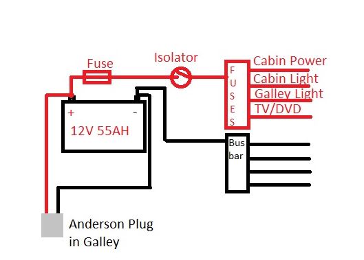

Postby MickinOz » Sat Aug 06, 2022 9:30 am
Yes, just a cheap $50 secondhand Palsonic 19" off Facebook Marketplace.
I couldn't really test it before I bought it, and I strongly suspected it would not be able to handle the newer HD TV codecs, and I was right. Still gets the SD channels. Only a few HD channels are different programming here, quite a few are just HD transmission of the companion SD channel.
I don't think it was used much before I bought it.
I was attracted to the 19 inch screen size. In an 8 foot trailer with the interior cabinets the screen is only about 4 feet from your face. Don't want too big.
The small TV/DVD combos here don't have internal power supply circuitry. They come with "plug packs" - AC mains transformers that put out 12V DC to plug into the TV.
I went to the local Jaycar agent, bought the appropriate coaxial power plug for the job, dug out the soldering iron and fabricated a lead to wire back to the fuse block.
I now have a very basic, but in my opinion all you need, very robust 12V only power.
4 circuits, currently each is fused at 10 amps until I lay my hands on some smaller fuses.
Internal power.
Internal lights.
TV/DVD
Galley and external lighting.
50amp anderson socket in galley for charging or power out.
Don't think it can be much simpler than this:
MickinOz

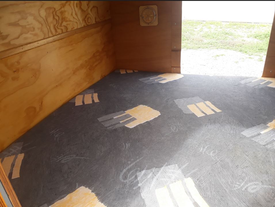

Postby MickinOz » Sat Aug 13, 2022 3:58 am
I'm creeping up on it. We've had quite a few rain forecasts, with a disappointing hit rate.
The 'drop lives at my mum's place, I go and get it when I have time and weather to work on it.
This means running back and forth almost every day.
Thumper the dog loves it - Grandma always keeps doggie jerky for him.
She loves it too - she misses her big dogs (Shepherds), but is getting too frail to deal with a new one, so having a dog she can spoil for an hour then give back is ideal.
And I get to check on her every day.

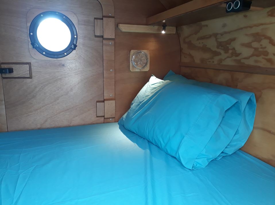

The butterfly vents have been installed.
I put the mattress in today. 6" foam queen size fitted perfectly.
Went to K Mart yesterday. $34 AUS got me a set of sheets and pillow cases and two pillows.
It's surprisingly comfortable for such base level bedding.
So close.
Fitted the new black mudguards/fenders.
I want to splash one more coat of marine grade polyurethane over the outside, then I'm calling it good enough to advertise.
Have arranged to borrow the middle son's girl friend for the sale photos.
A cute girl always helps sales, I reckon.
perfect fir 13082022.JPG (98.78 KiB) Viewed 702 times
Bedding 13082022.JPG (65.88 KiB) Viewed 702 times
foot room 13082022.JPG (53.83 KiB) Viewed 702 times

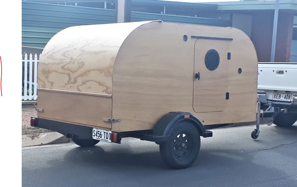

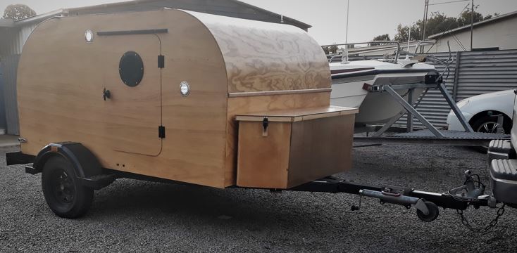

Postby MickinOz » Tue Aug 30, 2022 5:39 am
One year and 5 days after bringing the trailer chassis home, I'm finally calling it done.
If any Aussies reading could tell me exactly where the front white reflector should go, I shall be grateful.
Done 30082022.JPG (53.54 KiB) Viewed 577 times
MickinOz
Posts: 1305
Re: Now the fun starts
Postby MickinOz » Thu Sep 01, 2022 12:16 am
Way back in the process, I estimated the finished width of the trailer.
It's important. If not more than 2100mm wide, you only need amber reflectors on the side of the trailer.
If more than 2100mm wide, these must be amber clearance lights wired in with the taillights. The first amber light or reflector must be no more than 1000 from the rear of the body. At least 1 reflector must fall within the first 3000mm of body length, and must be no more than 3000mm from the tow hitch.
I forgot all about the measurements, and just bolted on the mudguards with the supplied reflectors stuck on the middle.
It is just pure unadulterated arse, as tinny as can be, but I have accidentally satisfied all constraints.
The split from front to back is right, and the trailer is 2099mm wide from the face of one reflector to the face of the other.
Fantastic, otherwise I'd be out there looking for amber lights and splicing them in.
