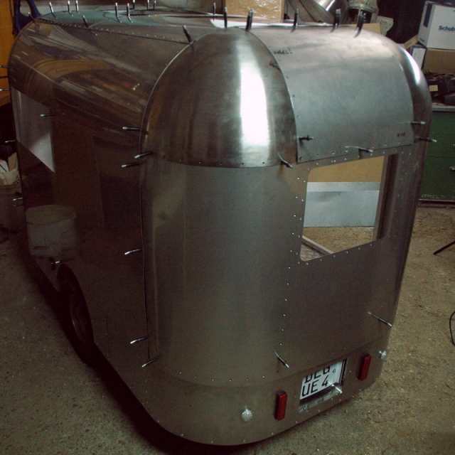

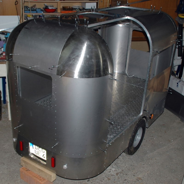

KCStudly wrote:It is looking really nice. :thumbsup:
Do the roof top panels and corners over lap the vertical skins like shingles? In that last pic it looks like they slip behind the vertical skins. It would be better if the panels shed water rather than trap it.
Thanks KC for the hint - yes, you are right, but only here in the front !
The front panel is the "crest" of the whole skin and will overlap the roof and corners.
While driving the big air pressure will drive the rain drops here from the front panel up over the roof to the stern.
From the front to the stern every panel will overlap the panels behind.
The seams I will seal with sikaflex polyurethane glue, so that, when the trailer stands, no water should soak inside that single seam in the front.

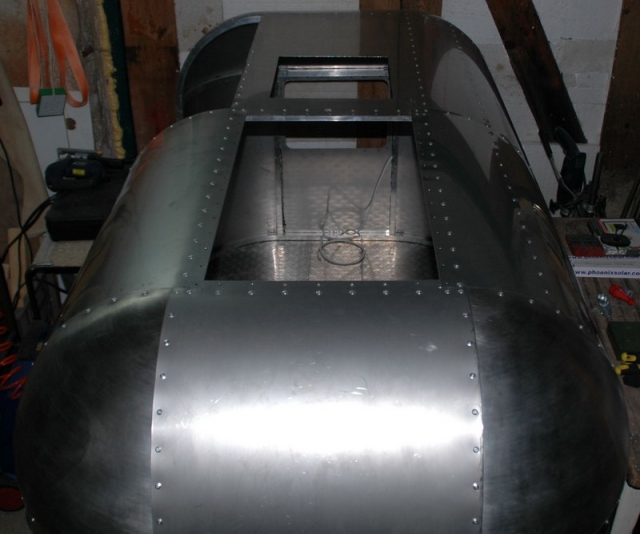

Postby ST1100 » Fri Mar 14, 2014 5:16 pm
@labuski - for the moment I plan no insulation.
Today I cut my last sheet for the skin, drilled the holes along the border and puzzled all together on the frame.
Then drilled all holes thru the overlapping sheets and into the frame.
Tomorrow is the big day, I will disassemble the whole body, deburr all the new holes, degrease frame and sheets with acetone and then ...
... shoot all together again with my rivet gun ! And if I'm successful, I can take new pictures without clecos on sunday !

Postby ST1100 » Sat Mar 15, 2014 4:09 pm
Okay - after disassembling the whole box I had to clean all with acetone and deburr the remaining holes.
Then I sealed the frame under the sheets with sikaflex 221 polyurethane glue and clecoed the first sheets on it, beginning from the stern.
Under every new sheet border I layed a line of sikaflex before fixing it with clecos and riveting me slowly from the stern to the front.

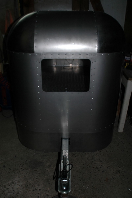

89: Stainless Steel Micro-Airstream behind motorcycle
Postby ST1100 » Sat Mar 15, 2014 4:13 pm
And eight hours later I finished with the front sheet.
TADAH !
View of the roof !

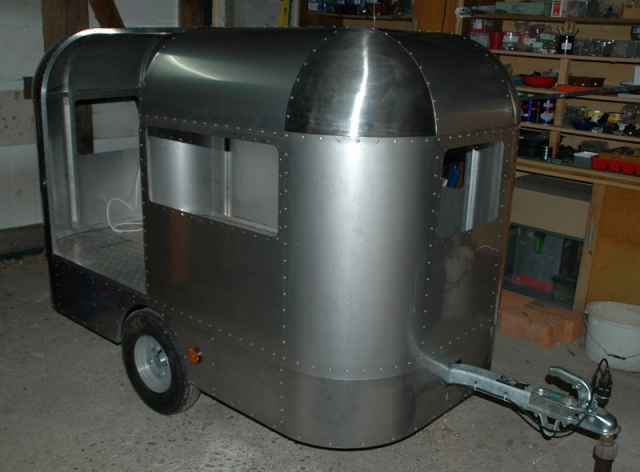

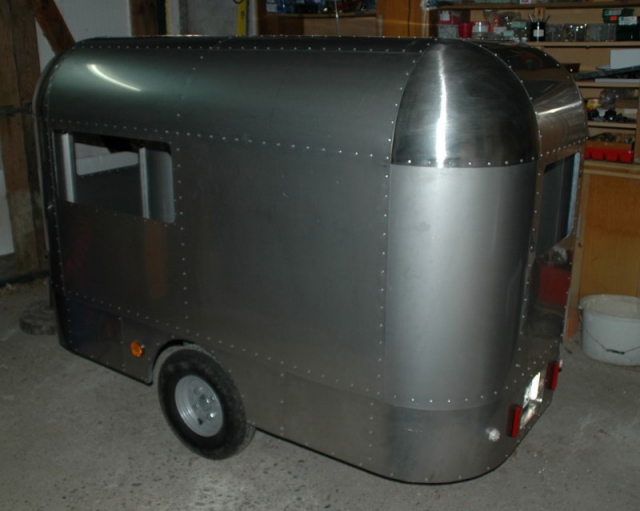

Postby ST1100 » Sat Mar 15, 2014 4:43 pm
And - the best view I think :
and the other side:
A long day with a very satisfying result !

Postby danlott » Sat Mar 15, 2014 10:19 pm
ST1100 wrote:And - the best view I think :
and the other side:
It looks like your corners bottom edges are not overlapping the same way?

Postby ST1100 » Sun Mar 16, 2014 6:38 am
danlott wrote:It looks like your corners bottom edges are not overlapping the same way?
Dan
Thats correct Dan - if I drive in the rain, the water will be blown up the front over the roof, so the front sheet is the "top shingle" of the whole construction.
If I stand still, the gravity will not have the same power to leak inside the trailer as the dynamic pressure of 60 mph speed.
