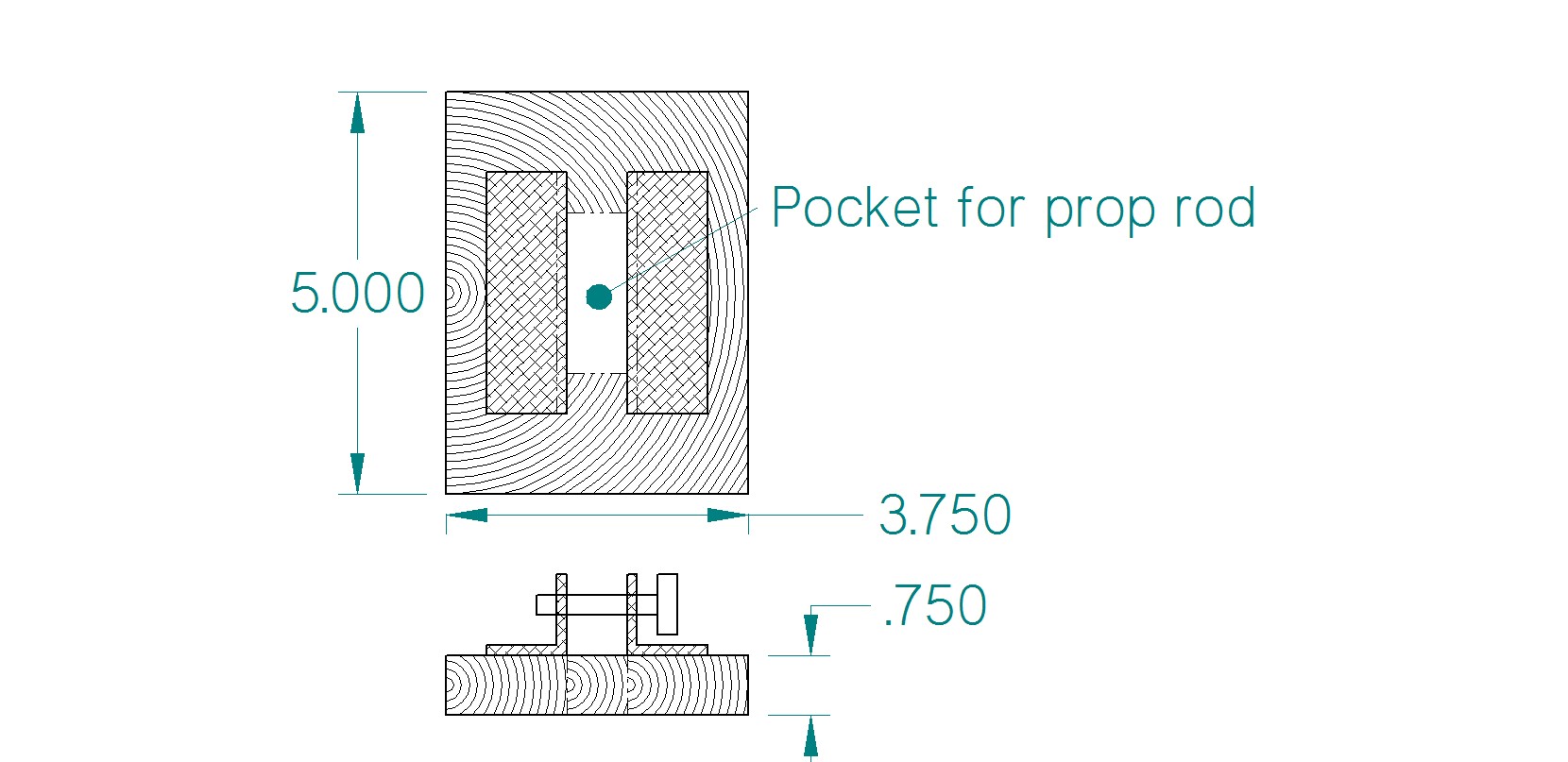

So here's a sketch of the prop rod pocket I may mount on the underside of the hatch.
Prop pocket.jpg (163.53 KiB) Viewed 2559 times

Wondering why you don't use the gas strut approach for the lid, instead of a prop stick. It's simple & does everything you need with very little fuss and has nothing to go wrong or roll around or get misplaced. Just lift to open and it stays up, why not? Apologies if the answer is somewhere in the thread and I missed it. tim

I looked into a gas strut before, but with the two shelves being so high on the walls there weren't any good solutions for the available body/stroke length combinations without hitting something or blocking the oven from opening.

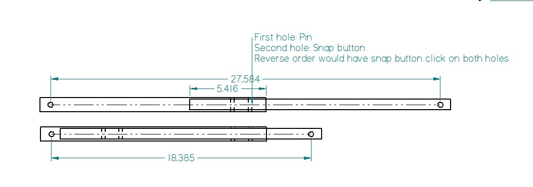

noseoil wrote:Wondering why you don't use the gas strut approach for the lid, instead of a prop stick. It's simple & does everything you need with very little fuss and has nothing to go wrong or roll around or get misplaced. Just lift to open and it stays up, why not? Apologies if the answer is somewhere in the thread and I missed it. tim
Your post actually got me thinking about the problem I had finding a gas strut to fit and I had an idea. Instead of a gas strut, I could use telescoping square tube, with a quick release button (like on an Easy-Up leg) to index the tube at the right location and then another set of through-holes for a pin to lock the tube at the extended position. At that point, as long as the extension distance isn't more than ~80% the length of the larger tube, I would be able to make it work.

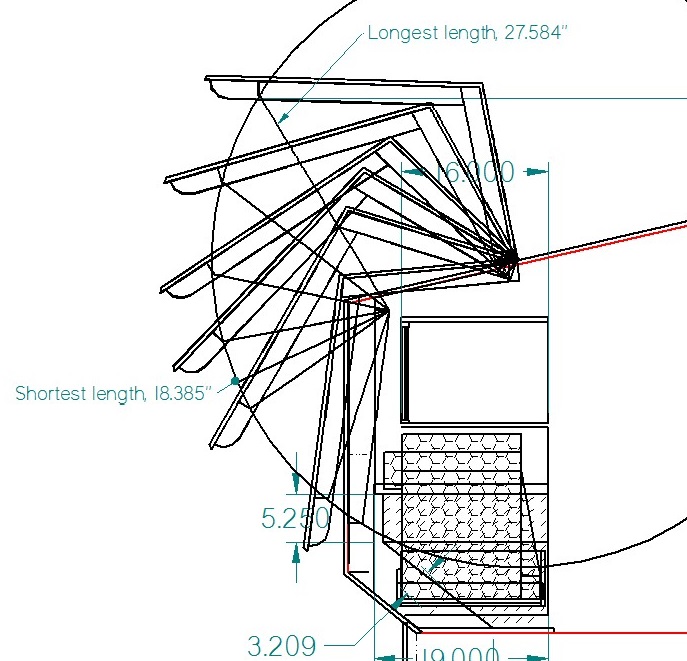

Postby Kharn » Thu Oct 02, 2014 8:53 pm
And CAD confirms it will (can? :O ) work. :D
hatch telescope 2.jpg (133.55 KiB) Viewed 2400 times
hatch telescope 1.jpg (45.93 KiB) Viewed 2400 times
I'm using 0.083" walled steel square tubing from McMaster (if you want to use this on your own build, make sure you buy stuff noted as for telescoping use, otherwise you'll get a weld seam on the inside of the tubes and they won't slide correctly), plus a snap button and 1/4" diameter push button quick release pin. The 0.083" tubing should be much thicker than your average Easy-Up leg, so I don't anticipate any problems holding my ~40lb hatch up. You also definitely need the pin, if the snap should fail you could easily break bones with the hatch slamming closed and would definitely cause some damage to your tear. I've used the push button pins at work, they're much more expensive than the spring-loaded ball detent style alone, but they absolutely won't work themselves out and anyone touching instead of looking is less likely to remove it.

I'm going to stick with the telescoping rod and see how it works for us, maybe I'll go to a strut if we have any issues or don't like it.
