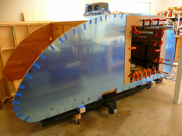

Postby aggie79 » Thu May 07, 2015 10:22 am
Michael,
On my sidewalls, I used a bead of 4200 around the perimeter and around openings to hold the aluminum in place. I "blue-taped" and clamped the aluminum where I could and didn't use any fasteners.
Although I later put trim around everything, I am convinced that the 4200 is more than strong enough to hold the aluminum skin in place - even traveling down the road at 70 mph plus.
