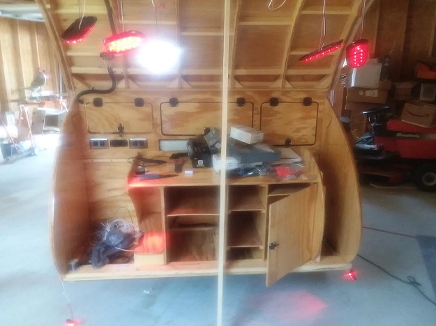

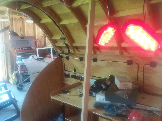

Getting some time in on the teardrop today. Been working on wiring the hatch area. When I was placing some lights inside the hatch for the galley I got a reminder how these campers use every inch of space. Three different places I wanted to mount the galley lights hit something or interfered when try to shut the hatch. Fourth spot was the charm and the lights mounted up great.
It was also to the point that I needed to locate my tail lights to complete the hatch wiring. I can't believe what a big change it made in how I see the camper. It feels like things just got real. As in those are the taillights I need to be on the road with. Didn't expect it, but seeing those 4 lights installed felt like another milestone has been reached.

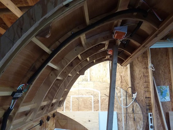

I'm probably at 95% done with the wiring. Then I'll test all the circuits, and hook to the tow vehicle to test all lights. I'll be lucky to get that done because the weather is changing fast. I'm still way ahead of where I thought I would be for this season. So the insulation for the roof will most likely wait until next season.
I was really surprised how long it took to make the hatch harness. With the lights and harness junction block it was 48 connections to set up for. Just never really thought about what it would take until I was underway. I chose not to crimp solder the connections to any of the lights. I want to make them easy to replace if needed. So it will be twist connections with taped wire nuts for those items.

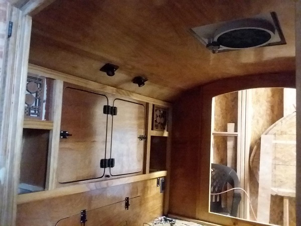

Got my aircraft reading lights installed too. Cutting holes in my newly installed ceiling was a tad tense. I'm happy with how the came out. Here's a pic of when I was first fitting them up.

Don't you just hate drilling holes through the ceiling when it has a nice finish on it , thinking it may splinter or tear some ply loose and chip.
Your lights look good. So does the whole TD. Welcome Wisconsin winter. I've been doing some reorganizing in the garage and the teardrop is just getting shoved around and waiting for its finial rest spot for the winter. Lawn tractor is separated from deck and deck spindles are lubricated so I stored it and brought out the snow thrower. :cry:

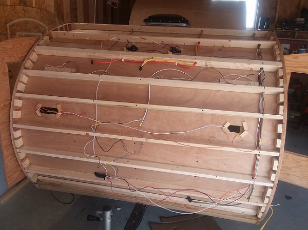

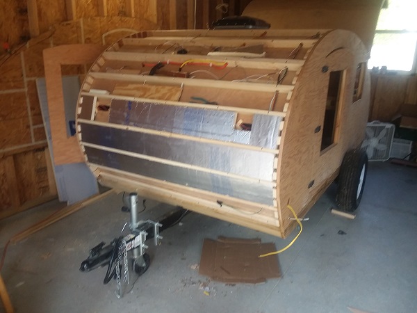

I have decided I'm going to test the full system and all circuits before I add the insulation and outer plywood skin. I'm going to hook up all lights and accessories temporarily. Also going to hook to the tow vehicle and verify all lights, signals, and charging circuit.
Got a tad ahead of myself and cut and popped in a few insulation panels. I'm using 1" rigid foam. I wanted to leave an air gap between the inner wall and insulation. I left a lot of slack in my wires in case future changes or repairs require a tad more wire to get done. I also wanted to be able to pull a new wire if required to replace a bad one. I don't know the likelihood of that, but it's what I did.
A pic of the completed wiring and slack. Another pic with some insulation installed.
