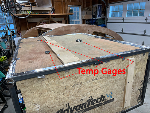

I've got the form for the front window all made and trued up. Just need to get some appropriate fabric to cover it with..like natural felt or flannel of some sort....something without synthetic fibers (that would melt). The form would get wrapped in that as would the masonite I'm going to use that would rest on the metal framework in the oven that supports the plastic sheet while it heats up.
Got the top installed today with 3 temp gages salvaged from some previous grills. I'd try it out today but it's raining pretty hard. Maybe tomorrow. I'd like to experiment with it outside of the shop in case it turns into a fireball. It's burning season here so maybe no one will notice.
Will keep you posted.

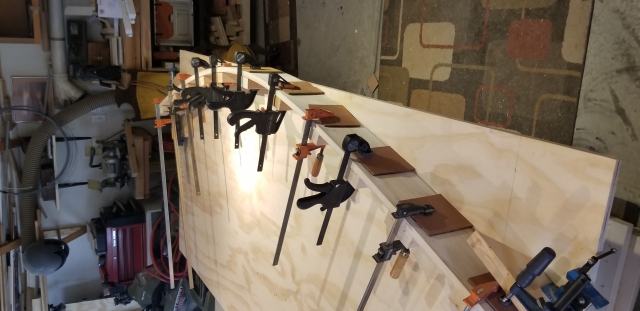

Impressed and obsessed with your build. I have a suggestion with your form which I used when bending some 3/4 poplar. Make some blocks glued and screwed that are perpendicular to the form for clamping. Image

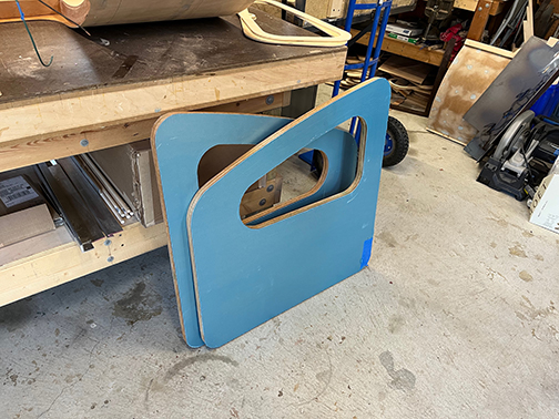

Finally, the weather is warming up (a bit). This past Sunday it hit 62° (which is close enough for me to be 65°, the temp the Wilsonart Contact Adhesive says to use the product). So applied the aluminum sheet to the 2 doors. All went well. Back down to the high 40's and low 50s this week, but come the next warm day will tackle the sides of the cabin.

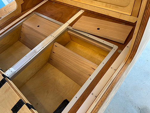

Installed some foot rests/storage bins in the floor. Will urethane them today.

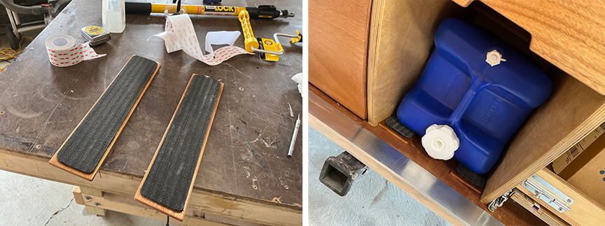

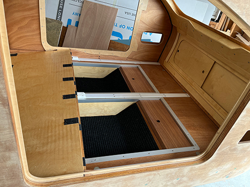

Today... covered the foot wells with indoor/outdoor carpet. Found some nice (and inexpensive) carpet at Ocean State Job Lot (kind of like The Dollar Store). Cut it up to size and attached some VHB tape and velcro on to hold the pads in place. Turns out the back side has a nice rubbery type surface. With some left over scrap attached that to some .250 thick slabs of ply to use under the water jug to keep the jug from sliding around while traveling (thanks Tony for that idea).

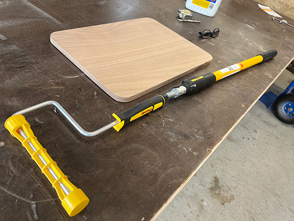

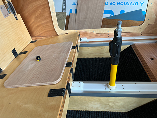

I wanted to create a table of sorts for when the bed is in the couch configuration and was going to just get a piece of pipe to hold a ply top. Went to the hardware store and found this nice Purdy paint roller handle that extends from 2 to 4 feet. There's also a Purdy roller holder that has a quick connect feature that allows it to attach to that extending handle. That handle diameter is exactly what I was looking for (1.250"). I'll cut the tip of the handle off (the part with the quick connect) and attach that to a piece of ply which gets covered with formica (will be the table surface). The extending handle will get cut down so it can hold the table at a minimum of 15 inches and extend up to 17 or 18 inches. The part attached to the table bottom will be off center (front to back) so it will be able to rotate around and have the table either closer to you as you sit on the couch, or .... rotate it 180° and have it be a bit further away from you providing a bit more room between your (our) knees and the table top.
John

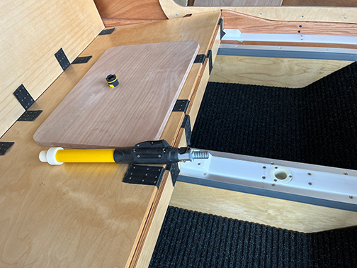

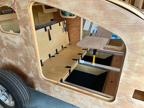

Got the table together. Just need to apply the laminate top and edge banding.
Wish the temps would get a bit higher so I can go ahead with the aluminum application.
John

Postby TimC » Fri Mar 25, 2022 2:49 pm
Very clever. Looks like that mount could be adapted for multiple table locations.

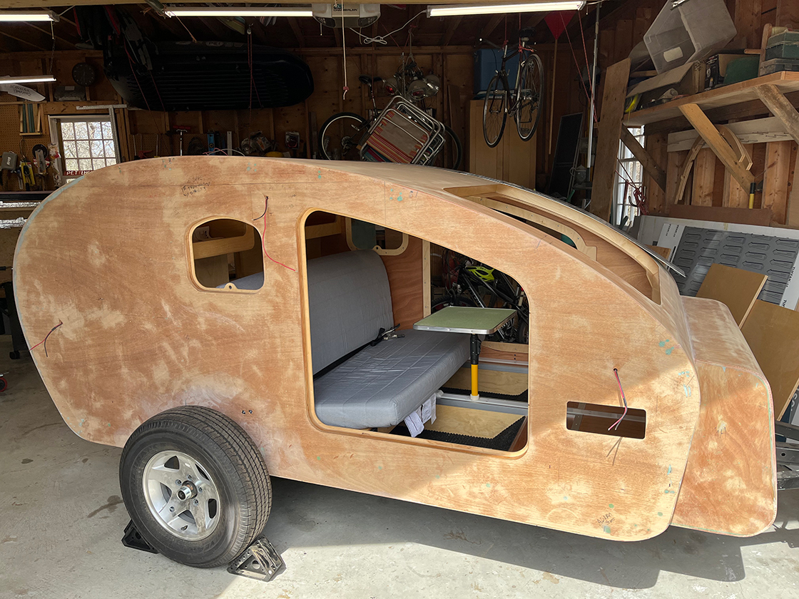

Well, the weather seems to be warming up here, a bit (slowly, at Mother Nature's pace).....so decided to start installing the aluminum siding. Just one piece today. But tomorrow hope to get the sides completed. That will allow me to install the doors, some exterior lighting...... etc.. I have a feeling once I get the aluminum completed things should move along quite quickly to get this thing on the road and see how it performs. One step at a time. Also got the aluminum trim on the couch/table. Finessing the couch/bed conversion with a bungee strap. Need to get a smaller length strap.... on order. And tweak the bed platform a bit.
Today, brought polycarbonate sheet and ACM panel over to the CNC shop to get some moldings and some of the windows cut out.
Moving along.
