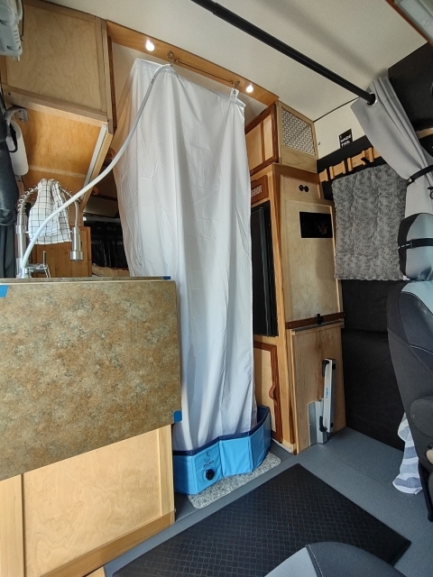

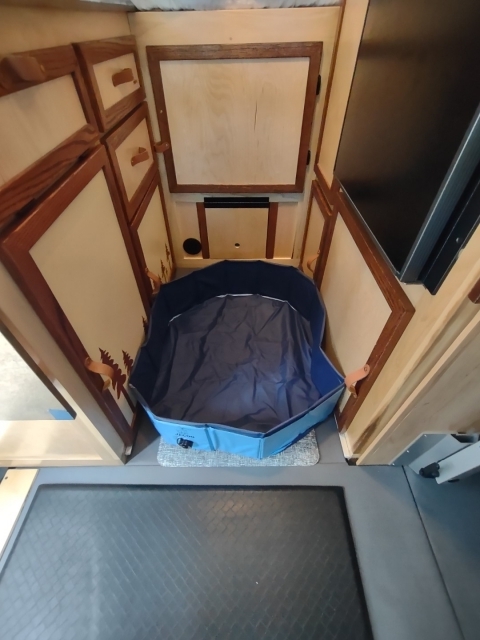

My wife finished the shower curtain for our doggy pool shower. I took a quick shower in it this morning and it works, I used about 1.5 gallons of water. I think the dog pool might have a small leak in it so I'll have to sort that out. I was worried that the shower curtain would leak but it seems to be watertight. I still need to put together a drain line so for right now I'll just drag the dog pool out and pour the water into our grey tank.
The shower curtain tends to stick to you; I don't think I'd want to use it on a cold day.

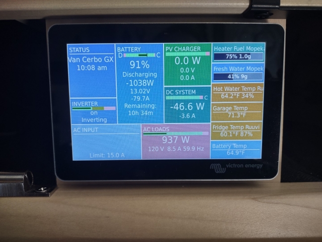

Postby bdosborn » Tue Sep 26, 2023 3:54 pm
I finally got the microwave installed. By some miracle it fit nicely in an upper cabinet; I just took the door off and built a mount for it. I'd like to say I planned it that way but I just got lucky:
I tested it out with microwave popcorn and the results were acceptable. Here's what the microwave draws when its running:

Postby featherliteCT1 » Tue Sep 26, 2023 4:27 pm
Looks great!
Your Cerbo GX shows 1038 watts being drawn by the micro wave.
1. Does the microwave surge and draw more watts at start up?
2. What is the watt draw indicated on the sticker on the microwave?
My “900” watt microwave draws about 1400 actual watts, with no surge.
My “400” watt microwave draws about 875 watts, with no surge.

featherliteCT1 wrote:1. Does the microwave surge and draw more watts at start up?
1. Not that I've noticed but the Cerbo probably isn't fast enough to catch a surge. I have a 2kW inverter.
2. The owners manual indicates 950W draw and 600W delivered. I didn't know they were so inefficient but what are you going to do? :oops:
Honestly though, the hit on the battery isn't bad at all and we probably aren't going to be running it very long. I had some leftover pizza from a restaurant on our Telluride trip and that's what got me off my butt to put the microwave in. They're perfect for that kind of stuff.

Postby featherliteCT1 » Tue Sep 26, 2023 6:37 pm
Thanks for the info. When boondocking, I regularly use my little 400 watt microwave to heat morning coffee for about 2 minutes. Very convenient.

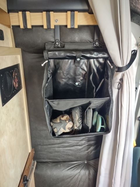

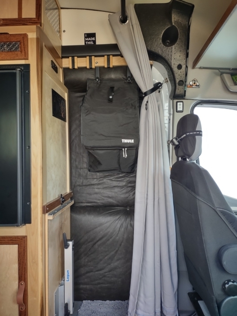

I've been holding off on finishing the space behind the drivers seat till we know how we really want to use it. Every time we camp we'll think of a new way to organize things. We needed a space for our shoes at night; we have a shoe organizer on the back door but that doesn't help for the shoes we're wearing when we go to bed. Enter the Thule Rooftop Tent Organizer. It's perfect for getting our shoes off the floor so we don't trip on them and it hangs into the recess of the wall nicely. Empty it and you can roll up during the day although I doubt we'll do that.
I bet this would hang nicely below a teardrop at night and it's water resistant....

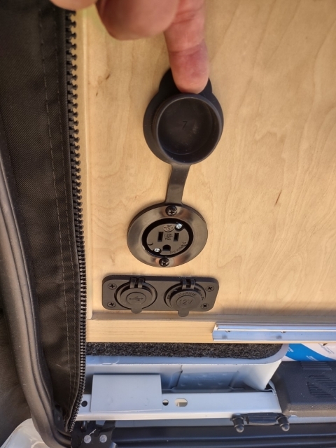

Postby bdosborn » Thu Oct 05, 2023 12:34 pm

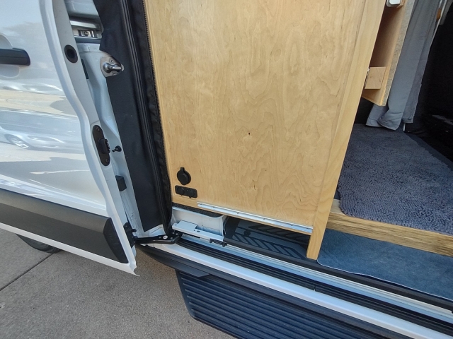

I added an outlet in the kitchen cabinet so we can easily plug in the induction stove while its sitting on the exterior table. These last few additions are in response to a to-do list generated after we've taken a trip in the van. This is why I urge people to camp in their rigs while they are building, its hard to anticipate the fine details but it all becomes clear after you've used it a few times:
Just search for flanged outlet (*not* inlet) if you're looking for this type of a plug. This is inside the van so it won't be exposed to the outside, maybe some splashes of rain if the sliding door is opened. I wouldn't mount this in a location that is exposed to the weather.

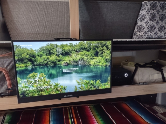

Here's a sneak peak of our 12V HTPC that lives inside the cabinet over the foot of the bed. No rust drives here; 10Tb of SSD storage. More to come when I figure out how to take decent photos of everything

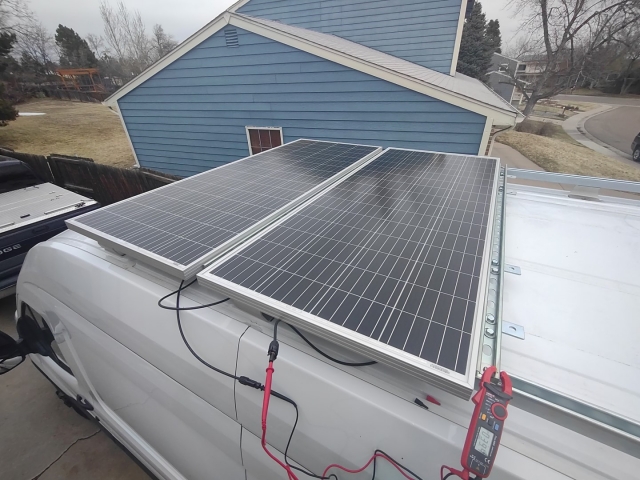

Re: Advanger Build Roof PV Rack
Postby ElwoodWander » Sat Mar 02, 2024 12:51 am
Your build experience is answering a ton of my questions! Thanks a lot.
I have the HR Transit, 148WB, standard-length box and I'm trying to fit a 600W array and a MaxxFan on top.
Do you think your solution would work as well reversed fore/aft -- with the 100W panels and fan up front?

Re: aVANger Build
Postby bdosborn » Sat Mar 02, 2024 9:11 am
It would fit without any issues but some guys on the Transit Forum have had issues with turbulence causing the vent lid to rattle when it's in the front. You might have to put a fairing on the roof rack to settle it down. That's on my list of to dos - I want to add a fairing.
DIYvan has a roof adapter that goes across the ridges in the roof to give the fan a flat mounting surface. Its expensive for what it is but it makes it easy to do a waterproof installation. I used one and would fork out the money again if I did it over.
