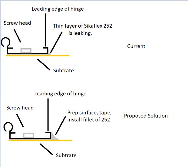

So I opened the hatch for a look.
Water inside!
Devastated.
Closer inspection, it looks like the water is coming straight through, under the forward edge of the hurricane hinge.
Looks like the bond between the Sika 252 and the hinge has failed.
This is a trait I have noticed with this material. It's great when it's a fillet filling a corner where two panels meet, but flat surface to flat surface with a thin layer in between, it lets go of the side with the weakest bond. Very easily.
It's like the movement in the joint is too much in terms of percentage stretch for a thin layer.
I consider unscrewing the hinge lifting it and putting in some more Sika Flex, but I've done it once pretty carefully and it has failed.
So I figure I'll try the easy way first.
So, I'm off out side to remove any squeeze out with a tile tool I found that is the perfect shape for the job.
Then I'm going to lightly sand the surfaces and tape up and install a new fillet of sika.

My "cure" seems to have worked. I installed a fillet of sikaflex as illustrated. I repainted the roof section leading down tto the hinge. Sanded the old paint, put on 1 coat of Zinsser primer, two coats oil based enamel. Seems to have done the job.
It's not raining, but liberal application of rainwater from a watering can seems unable to penetrate.

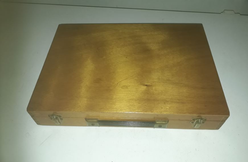

Went to a garage sale today - found myself a nice little timber case I think will work just fine as a utensils case in the 'drop.
$4. Can't grizzle.

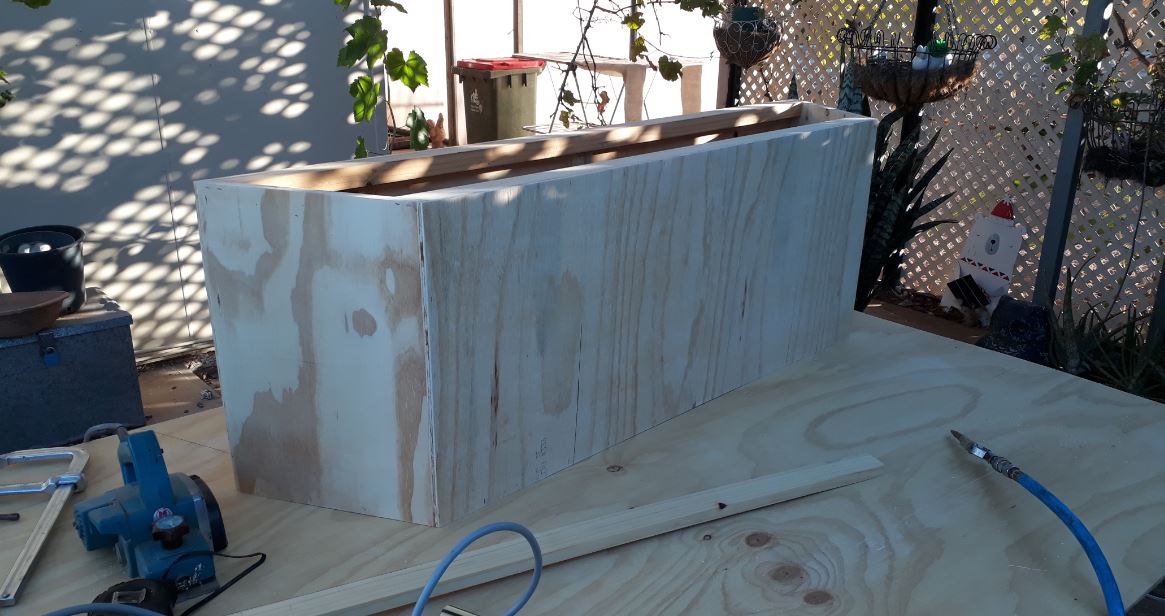

Started a box for the draw bar this weekend.
Using up off-cuts where I can, so the box is around 11 inches wide inside, 53 inches long, and 16.5 inches deep.
Not very big, about 135 litres, but enough for the folding camp table, two folding chairs, axe and shovel, wheel brace, jack, poles if ever I need some, etc.
Lid will just drop over the top and pull down with a couple draw latches.

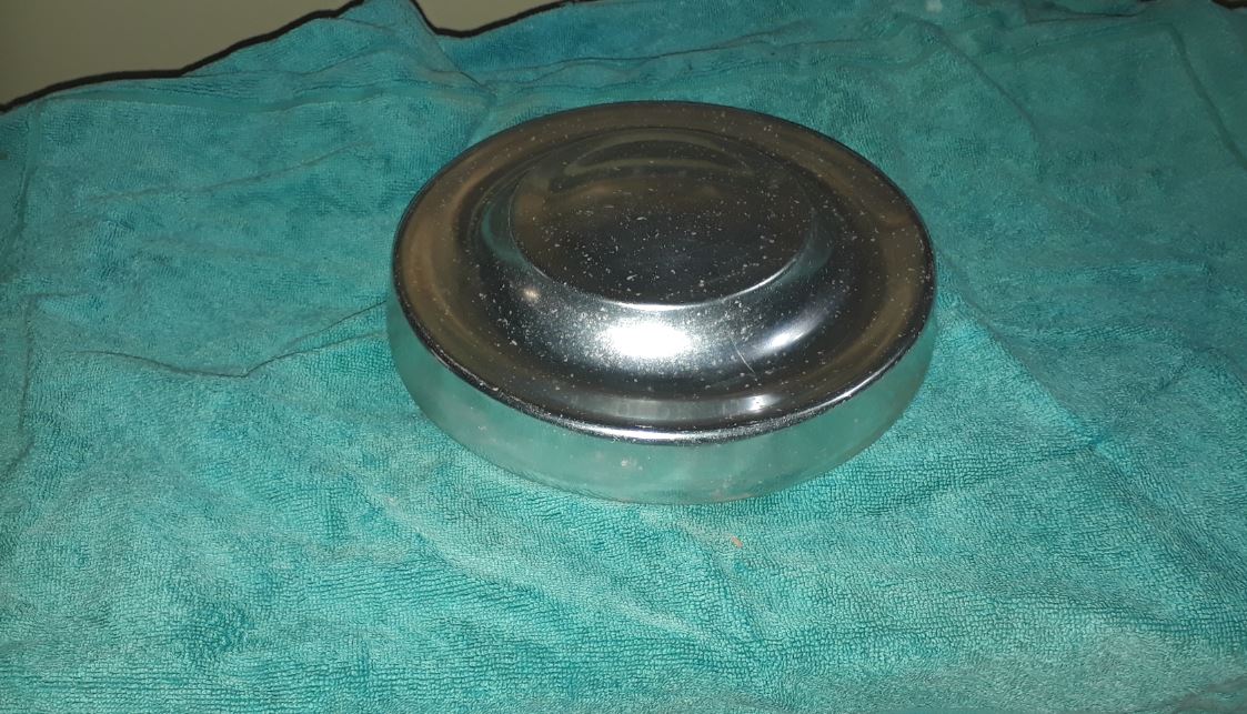

Four ol' skool polished aluminium hubcaps.
Dunno exactly how I will fit them to the modern rims, but I'll find a way.

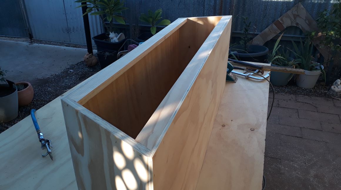

Box is coming along.
Pretty much at the point where I can fill the staples and give it a good soak in the mix.
Lid is made and fits nice. Put some blocks on the side for the latches.
Thinking of leaving it clear finished.
Photos not so good now. Days are getting shorter and by the time I get home from work the light has gone.
