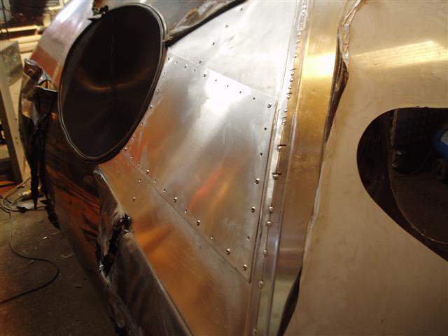

have managed around 6 hours on welding the side joints so far.
its also getting a capping run on the inside too.
the door surround is 1/8"out of line due to the sill i made.
this may get some adjustment if its noticeable after the door is fitted.
will post more piccies when the welding is complete & it gets more interesting.
best rgds dan. :thumbsup:

Postby dandan » Thu Jun 25, 2009 11:36 am
Hello All.
2 hours on it today.
butt welding the sheets together has come back to haunt me.
just not happy enough with the finish.
:cry:
should have gas welded the joints so they would have beaten better.
decided to rivet a joining strip over the top to hide the joint & add strength.
in future, will either lap & rivet the joint or purchase an over-sized sheet.
still have the other joint to do on this side.
its just short of the window rubber so as not to interfere with the seal.
will have to remove again for metal finishing before fixing permanent.
hope to make more progress on it next week.
as allways, your comments are welcome.
