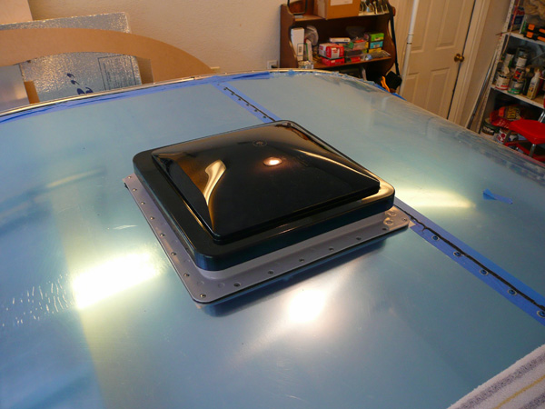

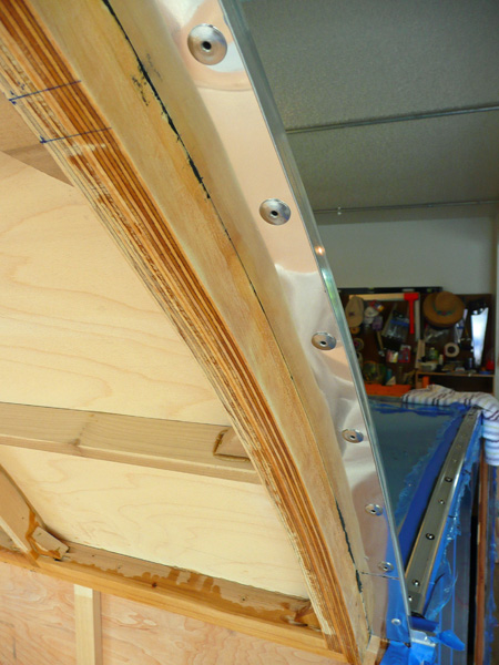

Last weekend, I cut the hole for the vent fan. This weekend, I installed the fan. As has been my mantra, I used 3M 4200 as a sealant (in addition to the gasket supplied with the fan.)

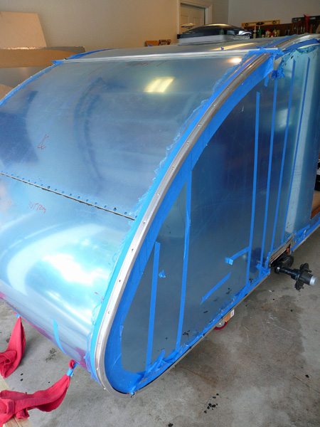

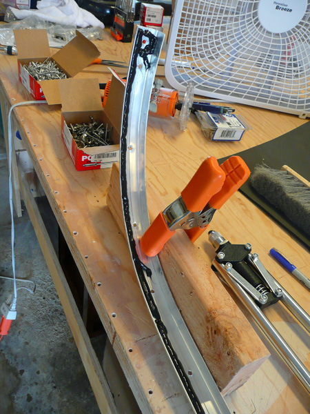

Next up was to install the hatch trim. I had formed it to shape previously, but hadn't installed it. First, a little more sealant.
Then fasten with blind rivets.
The trim is now installed.

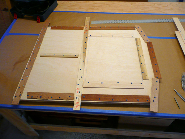

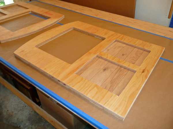

Time to move on to the doors. I had partially pre-built them with my walls, so they've been sitting around for about a year. Good news is that they didn't warp.

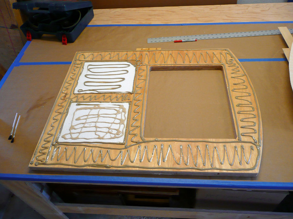

I added insulation and then PL premium.
The 1/8" plywood skin was added. I used a j-roller to distribute the adhesive and flatten the plywood. Then it was fastened with backer strips and screws.

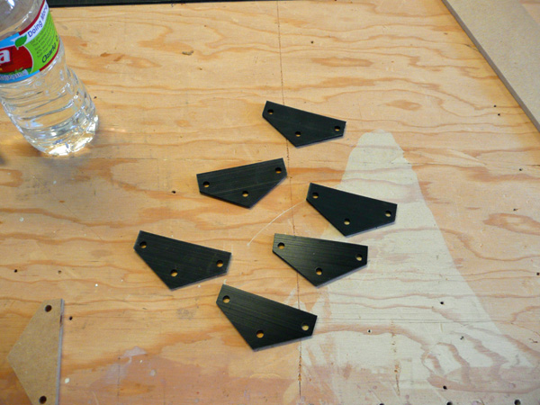

Last thing for Saturday was to make spacers for the hinges. I used 1/8" thick weather and UV-resistant UHMW plastic. It machines very easily with regular woodworking tools.

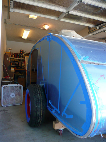

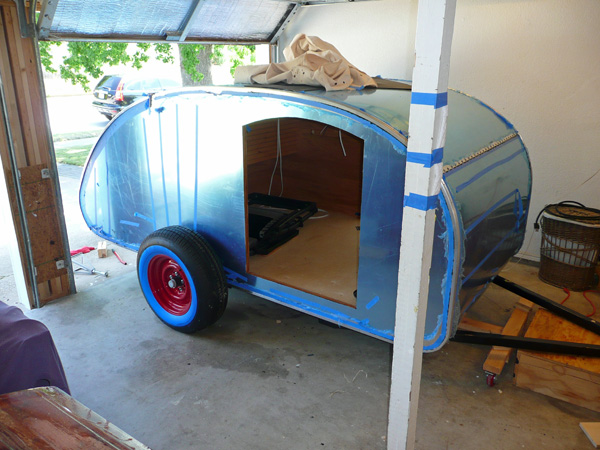

Major milestone reached at Saturday noon - the Beatle is standing on her own two feet:
I've been busy working on my teardrop the last 2 1/2 days and have made a lot of progress. Will post more pics later.

I like the stance of it! I really like they way teardrops look without the fenders for some reason, I guess it looks vintage. It will look great with the fenders on it too tho. Congrats! This is a major motivator! :applause:
