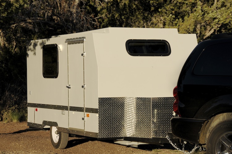

Postby myoung » Mon May 02, 2011 12:50 pm
cracker39 wrote: I like that propane tank "cage". Where did you get it? And, can you tell me exactly what connections you have to connect the tank to your cook top unit? I have a two burner Wedgewppd Vision that I haven't installed yet and have no idea where or how to get the hoses with the right connectors. I suppose I'll go to one of the RV dealers around Lakeland.
The tank is a so-called "Lite Cylinder Transparent, 20 lb. LP Tank" that I purchased from RVupgrades.com for $84. It is fiberglass so you can see the gas level in the tank. The "cage" is an enclosure for the tank that comes attached.
I used standard 2-foot rubber gas hose that I got at an RV store for the first link. That threaded into an iron tee. From one leg of the tee, we attached a 3/4 to 1/2 adapter that threaded into a flexible stainless steel hose that then connected directly to the stove. The flexible stainless steel hose is standard stuff, which along with all the other connectors, was found at Home Depot.

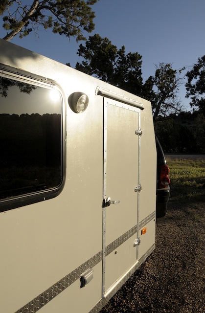

Postby myoung » Mon May 02, 2011 2:58 pm
Woodstramp wrote:Myoung, Outstanding work! Love the roof hatch thing. Looks really good. When you going to start #2? :)
Where did you get the drip rail that you mounted over the door?
Thanks. Yes, the roof hatch always surprises and pleases people.
Don't think there will be a #2 unless I discover some new ideas that can't be incorporated into this platform.
The drip edge is a fairly common item at metal fabricators/suppliers. I've heard of several places around here that carry them. I got mine at a place that fabricates awnings and ramadas and other specialized fabrications.

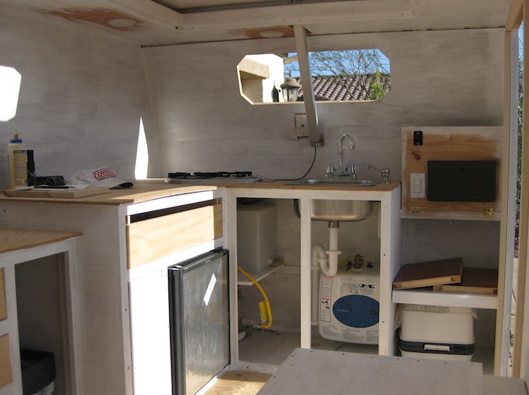

Postby fromeo » Mon May 02, 2011 8:17 pm
myoung wrote:Frank,
Thanks for your comments about the fridge. This one performs worse than the 3-way Dometic in my 1990 VW Westfalia.
The model is Dometic RM 4223 Americana. It does not have a freezer compartment, just a fridge. The ignition is piezoelectric manual. I did get reasonable cooling overnight in our garage with AC, but still not up to my hopes and expectations. Cooling below 20 degrees from ambient air temp seems to be the limit, but even that didn't happen while camped in mid-60s daytime temps and night time lows down into the high 30s.
I set the thermostat to the coldest setting, number 5.
Any suggestions would most welcome. Thanks.
No sweat Mike. I'm sure you can get this thing working just fine. For reference, the temps I had pictures of above were on a pretty warm day, about 85 as I recall.
Since you had the control cranked to the max, how does your fridge enclosure look? Is it enclosed or just kind of sitting in a cabinet? There's some pretty specific guidelines on the enclosure, and if there aren't followed it won't cool well at all.
I took a peek at the manual here: http://www.dometic.com/bd9a3459-6490-4ea9-9fa2-6ce1c53895e9.fodoc
There's also a more generic venting guide which will give some additional insight here: http://bryantrv.com/docs2/docs/dometicventing.pdf
Basically, the cabinet should enclose the fridge completely. The sides should be pretty much exactly the necessary width. There's a minimum height of 22" from the bottom of the lower vent to the top of the upper vent on your model. More is OK (and actually encouraged for more draft), less not so much. Looking at the pictures you have got to be close. If you are actually short in height, the only solution might be a small fan in the upper vent to force the airflow.
You don't want dead air space open over the fridge. If you have some, you want to partition it off, at an angle, from the upper rear corner of the fridge to the top of the upper vent. Basically you are building a miniature chimney here, so smooth airflow makes for good draft.
Another "critical" dimension is the back of the fridge to the wall. If you exceed that one, you can put a small angled piece right above the lower vent to achieve the correct distance. This is illustrated in that venting guide.
Another thought. For your model they spec two different plastic vents, one for the lower and one for the upper. I'm not sure what the difference is between the two, but you might want to make sure you have the right one in the right place.
If you have some pics of your enclosure that could be helpful. Dimensions would also help to figure out if there's an issue with the enclosure. Now if you have the enclosure dead on, and the control is cranked to the max, I'd suspect something is wrong with the unit itself.
Just for some more reference, here's how I wound up doing the enclosure on my build..
From above, the rear of the enclosure top is angled from the rear top corner of the fridge to the top of the upper vent:
The inside of the enclosure:
Here's from outside, you can see how tight the enclosure is, and also see the angled piece to the vent opening:
Let us know how yours looks and we'll go from there.

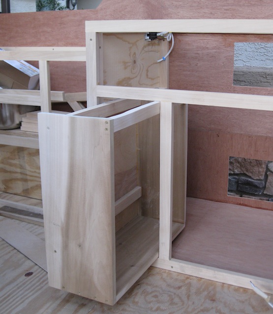

Postby myoung » Mon May 02, 2011 8:46 pm
Frank,
I followed the installation instructions in the manual to the letter. The space for the fridge beneath an under counter drawer is completely enclosed on four sides. (You can't see the enclosure in these pictures, but the sides and top of the fridge are within an inch or less of the box.) I also sealed the joints with caulk.
You can see the openings on the outside skin for the two vents that are standard fridge vents from a Dometic dealer. I asked for two different vents but he said these were appropriate.
At the top of the enclosure and behind the drawer, I added a curved sheet metal piece to direct the upward draft toward the outside. The height of the "chimney" is 30 inches.
The fridge has trim pieces around the front to compete the seal of the box.
I just turned the AC on for an overnight check once again. We'll see how things cool down by morning.
