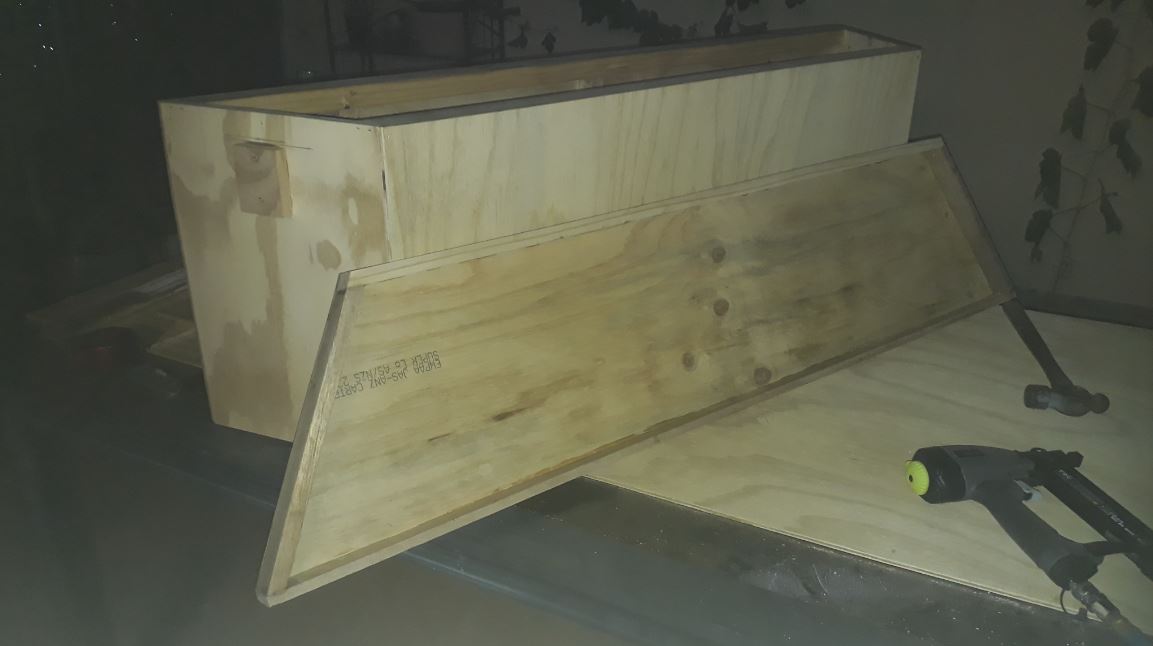

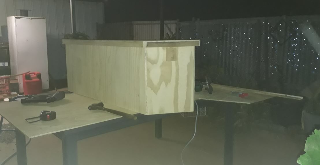

Box is coming along.
Pretty much at the point where I can fill the staples and give it a good soak in the mix.
Lid is made and fits nice. Put some blocks on the side for the latches.
Thinking of leaving it clear finished.
Photos not so good now. Days are getting shorter and by the time I get home from work the light has gone.
Box 3.JPG (54.98 KiB) Viewed 2484 times
Box 4.JPG (50.94 KiB) Viewed 2484 times

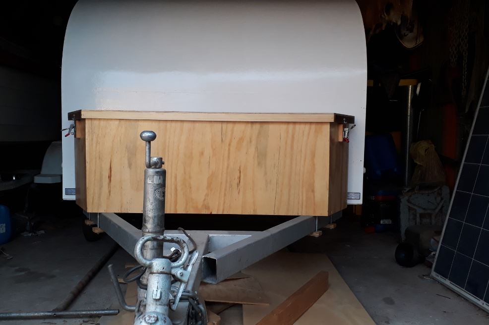

But I realised I hadn't photographed the box on the drawbar.
Drawbar box 1.JPG (64.9 KiB) Viewed 2265 times

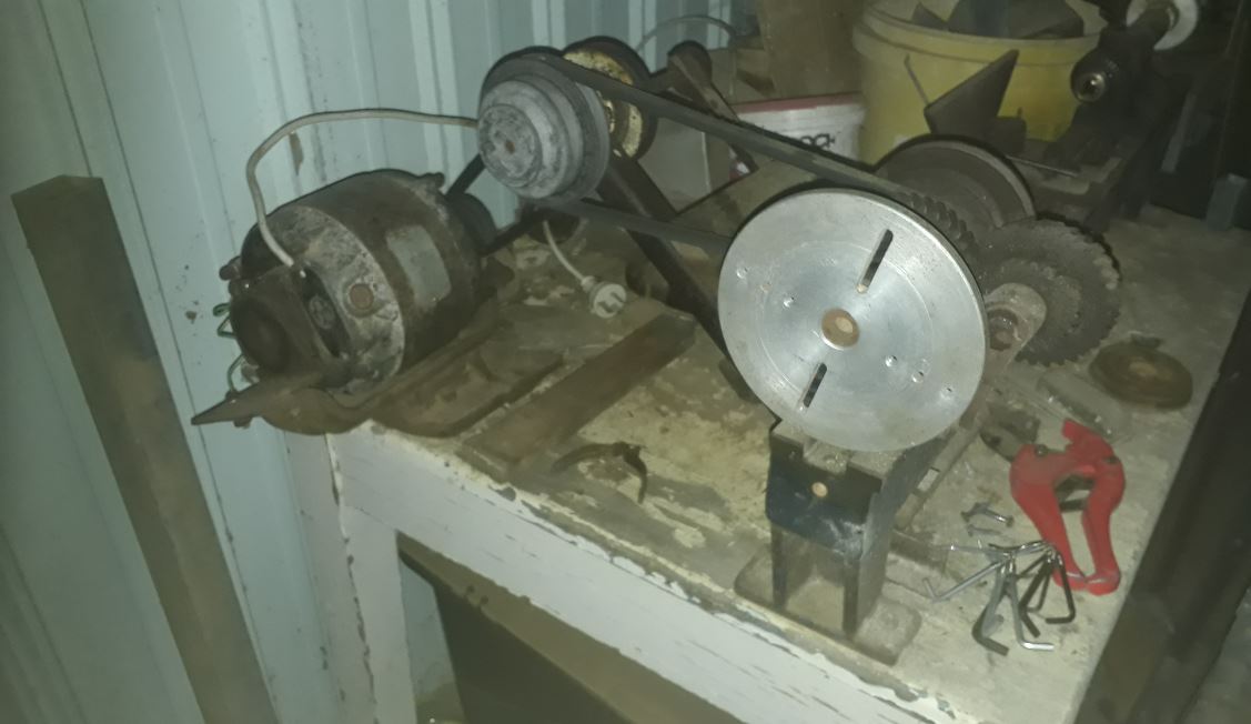

Had a tough day at work, felt the need to do something to take my mind off it.
I've had this old lathe seems like forever, but is in reality only about 20 years.
Another garage sale special.
Had pretty loose head stock bearings, but for $40 I figured I could live with them.
When I got it home I found I could rebuild the bearings with "new" balls from an old bicycle.
So I got almost all the play out.
Best bit, I can turn the head stock around and turn big stuff. I made some 22 inch rings for a project once.
However, I burned out the original motor.
On the weekend, another garage sale came to the rescue - an identical motor, same brand, same frame number, same corrosion on the aluminium end plates. :)

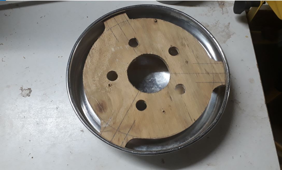

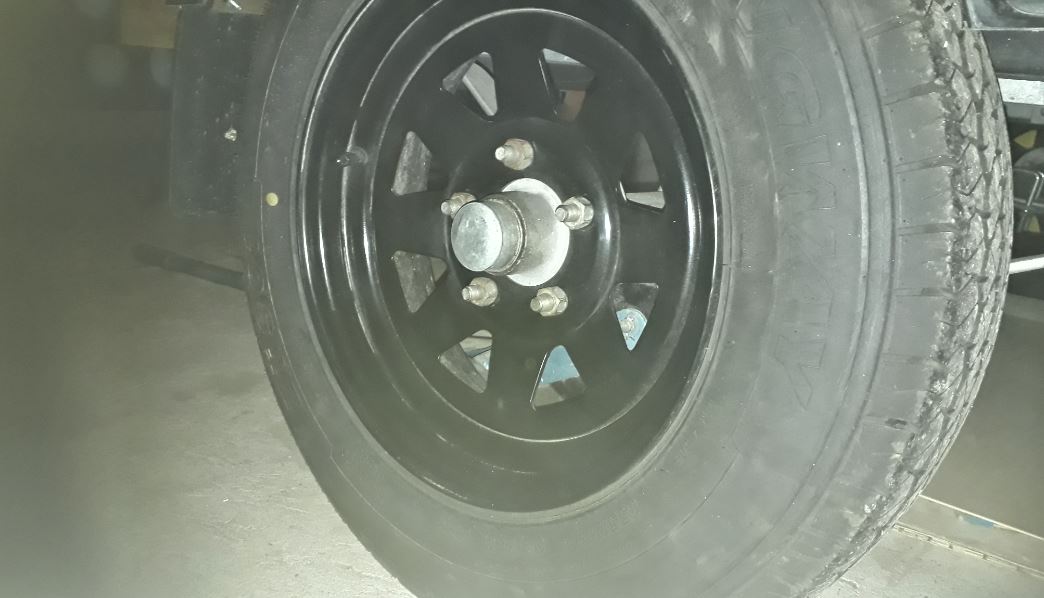

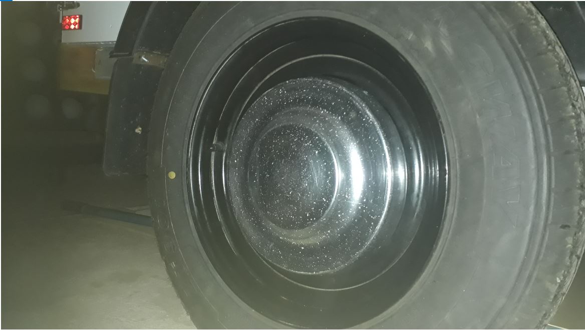

So tonight, I had a lash at making mounts for my hubcaps.
The "Sunraysia" style trailer wheels don't have anything in the way of bumps or nubs, so I have to invent something.
First attempt below.
Three point snap on style. Not sure how it will mount to the wheel yet. Don't want to drill anything, so cable ties are looking good. :lol:
hup cap adapter.JPG (83.98 KiB) Viewed 2185 times

I am biased of course, but I do think the trailer will look much better with hubcaps.
More crap photography - squeezed in between the trailer and the boat for these shots. In the dark.
Bare nekkid.JPG (71.68 KiB) Viewed 2185 times
Ol' skool.JPG (84.45 KiB) Viewed 2185 times

No successes with mounting the hubcaps, and very grateful I used the roughest looking one for trials - it's not survived well. The aluminium is very soft and so easy to scratch and dent.
Decided to stop trying for a while. When in doubt, give up. :D

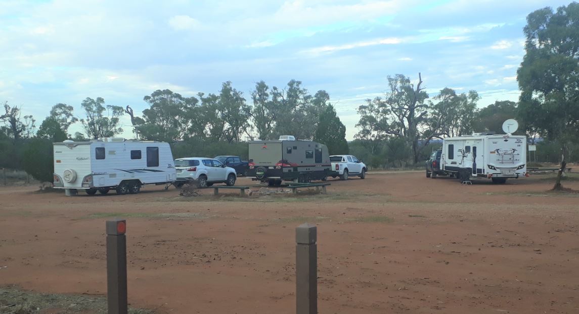

8 RV's in the park when I got there.
4 big caravans
one Kombi van
A Toyota Landcruiser with rooftop tent
Another Japanese truck with slide on motorhome body
And a 5th wheeler towed by a Toyota Landcruiser traytop.
And lil' ol' me. WAs still able to get a good spot.
SBS World Movies was playing the Blues Brothers, so I watched that for the umpteenth time, and crashed.
During a late night visit to the toilet, I noticed the interior light on in the Toyota towing the 5th wheeler.
I thought he might think I was breaking in if I just shut the doors properly, so I knocked on the old blokes door and let him know.
In the morning he came over to thank me. Said he would have been in a pickle as he couldn't get his generator started to charge anything.
So we fiddled with the almost new generator, got it fired up and all was good.
Old bloke reckoned the 5th wheeler was a piece of crap.
Modern campers, built with weight and low labour costs in mind, have lots of bespoke fittings and materials to make them light and quick to assemble, but some don't stand up to Aussie conditions so well. He'd stopped the day before on the Eyre Peninsula and persuaded a local agricultural engineering firm to weld a busted bracket on the chassis.
His 5th wheeler leaks at most of the seams. He showed me his impressive collection of sealers and caulks.
The thing is covered in caulking repairs and at nearly 15 years old will need a full refurbishment soon.
He mentioned he saw a teardrop similar to mine - only a double mattress, not full queen sized like mine - at a RV show recently for $24K :shock:

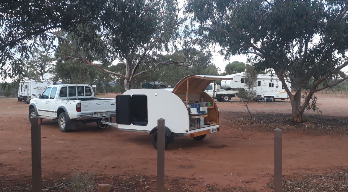

Four $100,000 outfits
Park 1.JPG (97.05 KiB) Viewed 2124 times
Lil' ol' me with 5th wheeler in background
Park 2.JPG (179.4 KiB) Viewed 2124 times

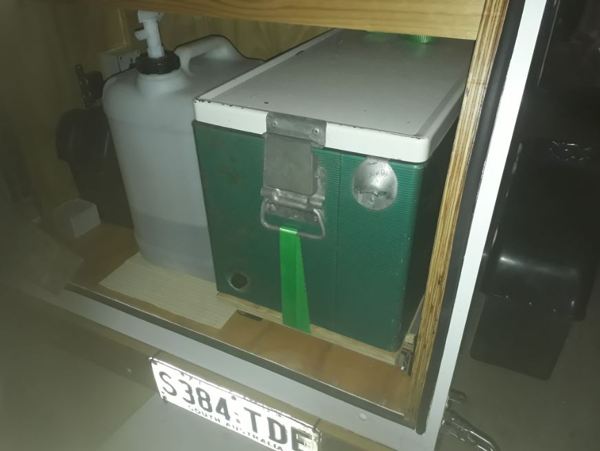

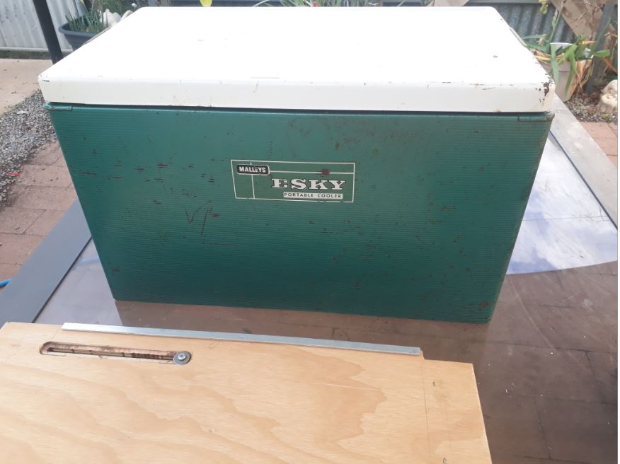

My vintage Esky arrived. Quoted postage was pretty steep, but something happened I'd never seen before.
When the seller took it to the post office to send to me, the postage was $10 cheaper than the on-line calculator.
He refunded the $10! Anyone else would have called that $10 a little bonus for all their troubles, and kept it!!
Lovely old Esky steel inside and out. Will probably not be very well insulated, but if holds ice over night, its good enough.
Main reason I bought it is because I think it looks cool and is almost period correct!

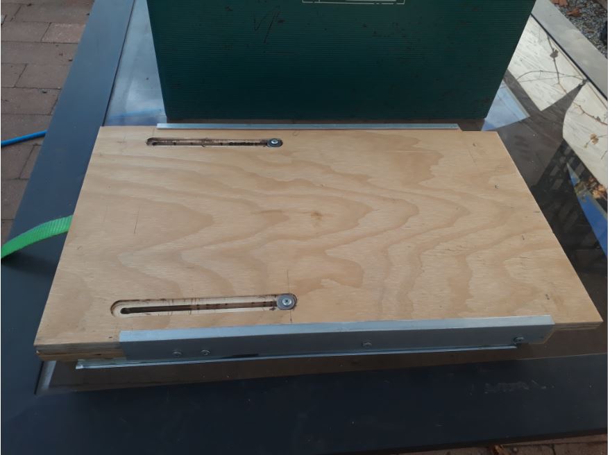

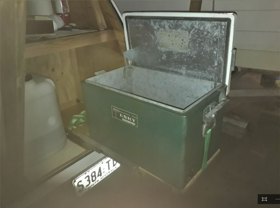

First job was to extend the slide. The slide has to come out a little more to allow the hinged lid to be lifted.
Can't put longer slides in, they would foul the hatch frame when it closes.
Couldn't get any drawer slides up here, anyway, except for super light duty ones sold for indoor cabinetry.
It'll be quite some time before we head for the smoke again, so improvisation was required.
I cut some aluminium angle from an old shop display shelf, screwed that to the sides of the original slide, and cut a piece of 15mm ply for a snug fit.
That gave me a slide out piece, like an extra stage in the telescoping function.
But no limits to stop it coming out too far, and nothing to stop the Esky from being slid into the bulkhead between the cabin and the galley.
So I put a handle on the under side at the front that doubles as a stopper to prevent the added slide from going in too far.
To limit the extension, I routered a couple of grooves into the extra piece, and added some screws with washers rebated in to the timber. These stop the slide coming out any further than necessary and contribute a little strength, so not just the aluminium angle is stopping the 15mm slide and my new Esky from tipping over the back. It'll have to pull the heads off those screws and stretch the aluminium angle for that to happen.
Now I have a 580mm long Esky in a 600mm space, with just enough clearance all round.

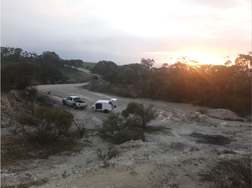

Postby MickinOz » Sat Jul 17, 2021 6:47 pm

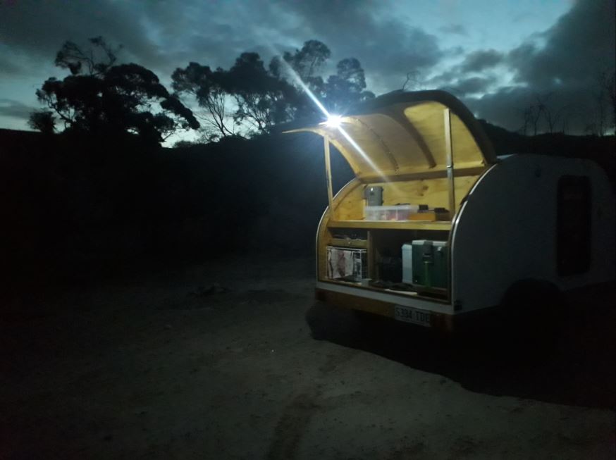

Saturday night, time to get out of the house.
I've been watching a lot of videos on Youtube of guys, and gals, who "stealth camp".
Involves finding a patch of nature in and around the city where they camp for the night without others knowing and, often, without permission. :shock:
It's kinda interesting seeing the ingenuity they employ.
Of course, I don't need to search the city for forgotten pockets of nature.
The countryside is only 5 or 10 minutes away, pretty much in all directions.
Plenty of secluded roadside spots that offer peace and quiet, no rules broken.
Last night was a disused limestone quarry on a very quiet back-track.
15 minutes from town, coulda been anywhere. Saw 2 cars this morning during breakfast, not a thing overnight.
Took a spotlight, but the only edible game I saw was rabbits. :(
Not that I'd be able to shoot anything last night.
The idea was that if I saw anything, I'd go back later and see some of the surrounding landowners and ask if I could hunt their land.
Most likely answer would be no, but not always.
Learned a bit more.
Woke at 4 am to fairly heavy rain on the roof.
Opened the door, water ran in!
When its raining the water runs off the roof onto the frame of the door, and when you open the door - in it comes.
WE need gutters over the doors like the old time 'drops have!
Research time.
The other thing I need is some sort of emergency toilet.
The old "when you're a man, the world is your toilet" idea might hold true for urine, not so true for poop.
Good thing I was only 15 minutes from home after I packed up this morning.
I'm not keen on a porta potty type setup. I'm thinking a folding stool with a seat, and a plastic bag with kitty litter.
Or just put it over a hole in the ground in easy digging country.
New cooler set up worked well. Slide her out to get the dinner fixings out, then close the lid, put the offcut of plywood I'm using for a cutting board on top and she makes a handy workbench.
Quarry Sunset.JPG (50.21 KiB) Viewed 1670 times
Quarry at Dawn.JPG (75.94 KiB) Viewed 1668 times
