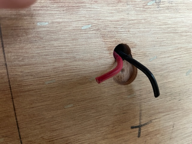

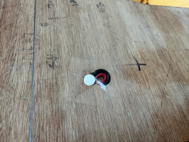

On another note.... preparing to install the large side sheets of aluminum tomorrow. I remember seeing another thread how the poster used magnets to locate the holes in the trailer where the wires extended from and to transfer where those holes are to be cut in the aluminum. That was/is a great idea and I've saved that thought for this next task. I was unable to stuff both the wires back into the holes in the cabin AND insert the neodymium magnet in the hole....so cut another recess and rested the wires there, freeing up space for the magnets. Will fill the holes with bondo prior to final install of the aluminum. But whoever it was that provided that technique, beer on me for the tip. Good one!

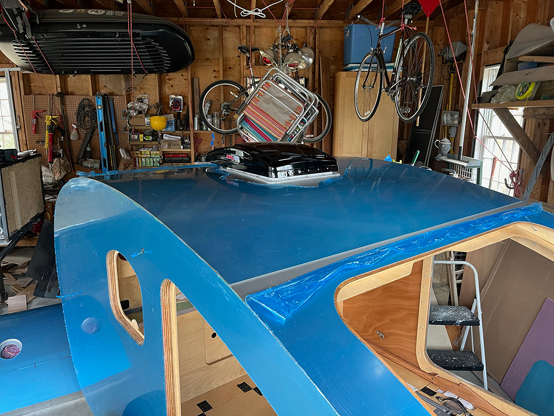

4.7.22

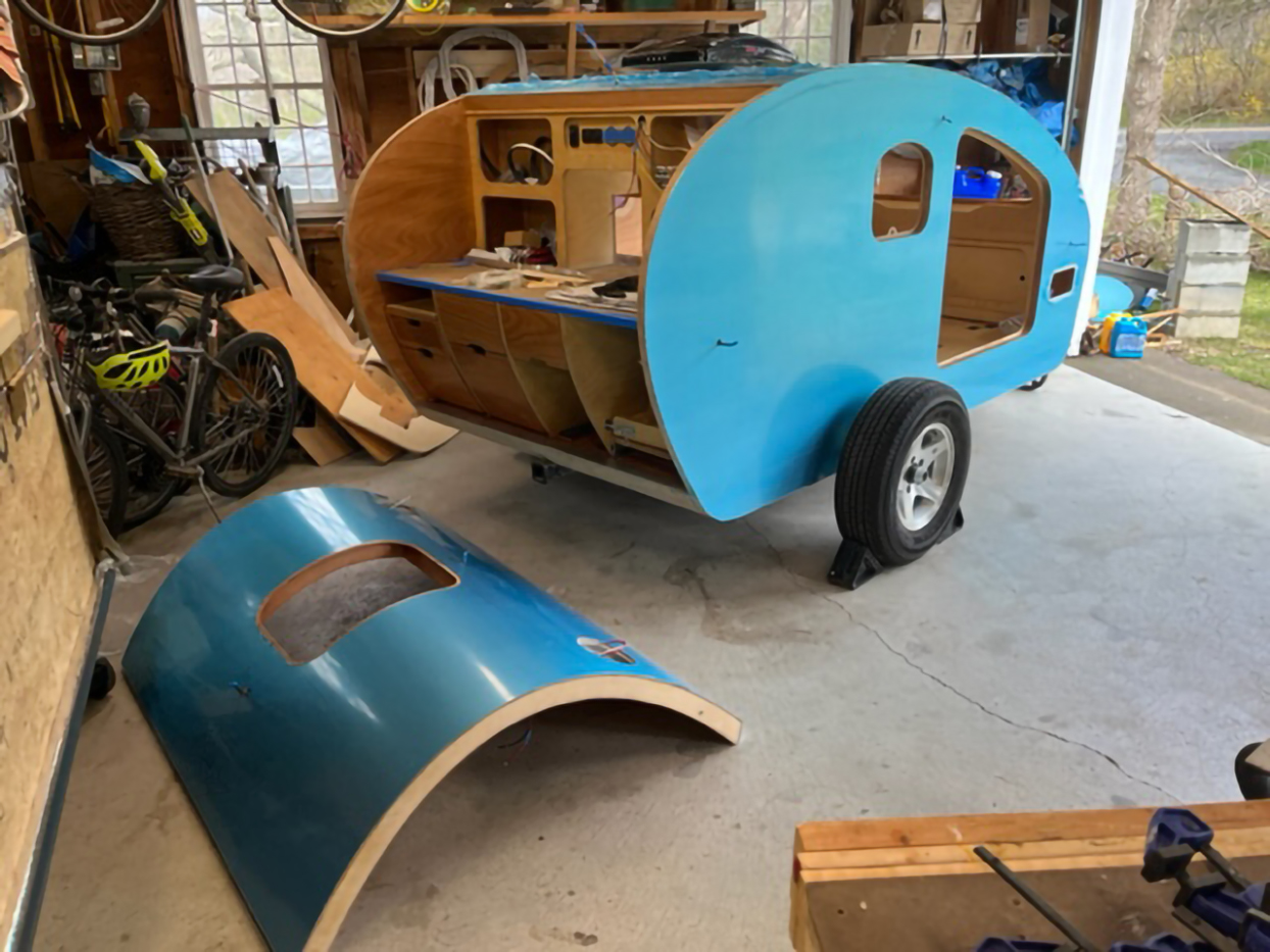

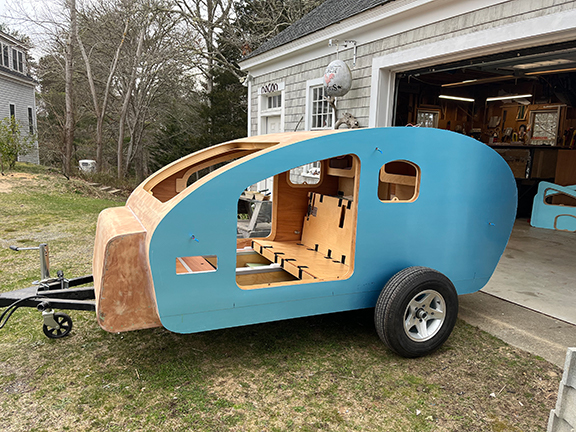

Installed the right and left side sheets of aluminum. I'll need to make some revisions to the opening for the pop open vent
(make the openings a tad larger. Better than having to make them smaller).
Once again, the technique posted by another member of using magnets to locate the openings for the wires to pass through worked great.
I'll have to do a little research and find out who that was so I can thank them.
John

Postby halfdome, Danny » Thu Apr 07, 2022 8:57 pm
Looks great John, nice and tight.
Is that the plastic cover or the color of the aluminum?

Postby Capebuild » Fri Apr 08, 2022 6:16 am
halfdome, Danny wrote:Is that the plastic cover or the color of the aluminum?
Danny
Hi Danny. Thanks! The blue color is just the protective covering. The aluminum finish is clear satin anodized. Nice blue color though :)
I following your directions in your post and all went well.... so thank you for those "instructions". Used that J roller to press it down. My
arms are feeling it today.
John

Postby Onajourney » Mon Apr 11, 2022 10:04 am
Looks great John!! How did the contact cement go?

Postby Capebuild » Sun Apr 17, 2022 3:42 pm
4.17.22
Onajourney wrote:Looks great John!! How did the contact cement go?
Thanks!! The contact cement "method" was good. If I had to do it again I'd probably apply the aluminum the same way. There were some hairy moments getting around the curves. On one sheet (I think, if I remember correctly, the larger roof sheet) we (my wife and I) kind of lost control of it and it stuck down in one spot. In a panic I ripped it off. We started over. Got it down okay but then I noticed a small "imperfection", a dimple of sorts, where it stuck and I ripped it off. Luckily that spot will be covered by the solar panel. There's a few other areas where the roof sheet meets the side sheets on the curves that didn't adhere perfectly (maybe a 3/16 gap) but I'm thinking they will pull in when I get the moldings on. The overlaps with the VHB tape worked great. Glad I don't do this for a living.... but all in all..... turned out well. I used .040 aluminum and wondering if using .032 might have made life easier??

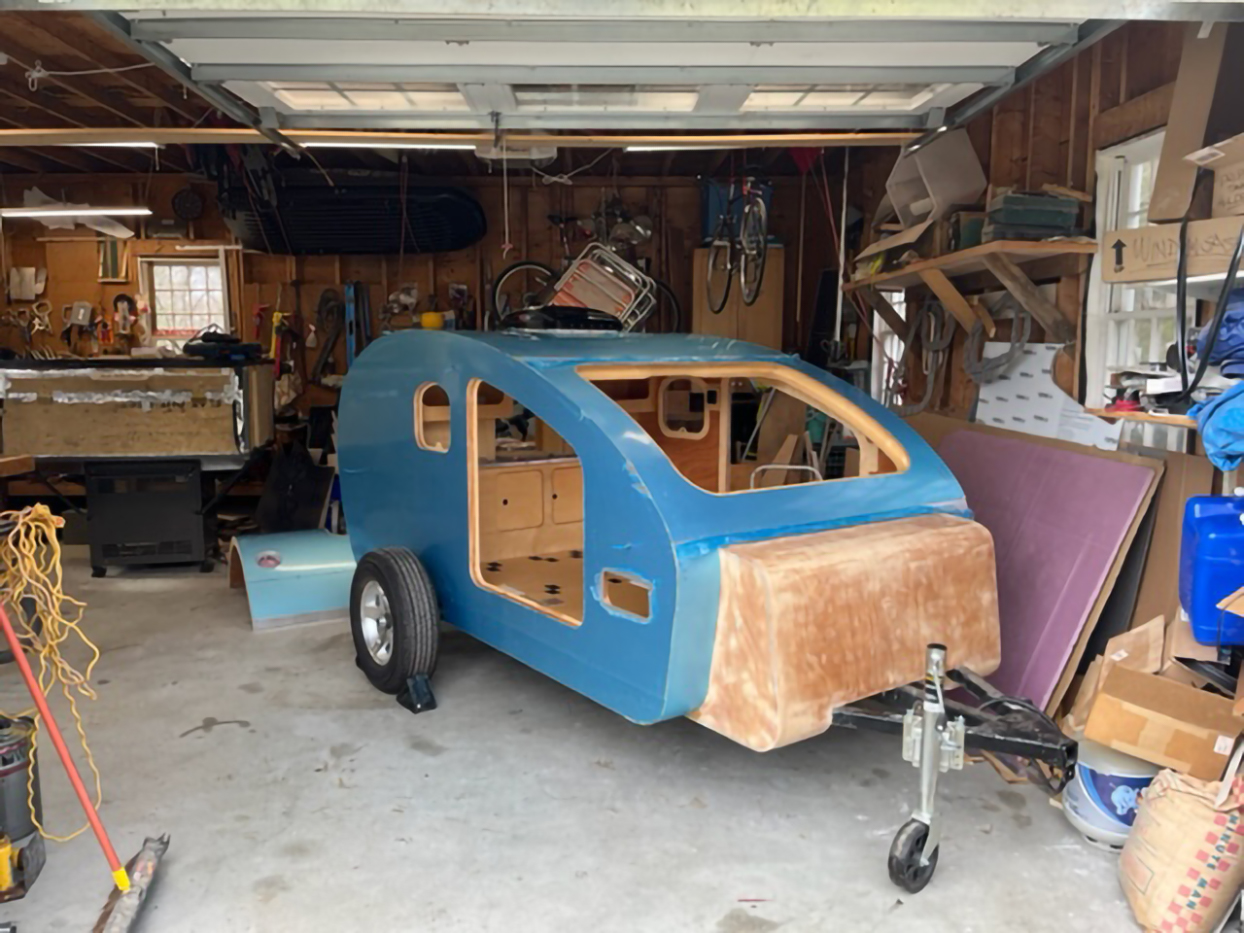

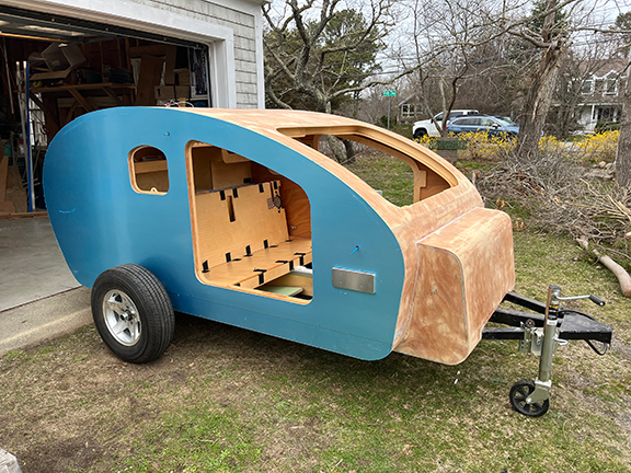

Also got the Maxxair fan installed.
Will probably look to install the hatch and hurricane hinge tomorrow and see what kind of challenges that presents. I feel I really need to get that settled before I install the moldings. Also have a bit more aluminum work (the rear roll pan and the front bump out). Should be real easy :lol: :worship:

Postby halfdome, Danny » Sun Apr 17, 2022 6:55 pm
John, if you ever lay down contact cemented sheets again and have premature contact use either a spatula to cut the glue or a squirt bottle of lacquer thinner.
Then refresh that spot with more glue and go at again.
Been there done that, :D Danny
