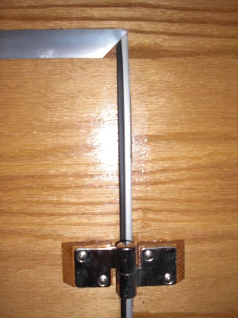

Postby Sparksalot » Fri May 22, 2009 11:47 pm
Pics of both sides. They both seal very nicely, just some finesse left to do.

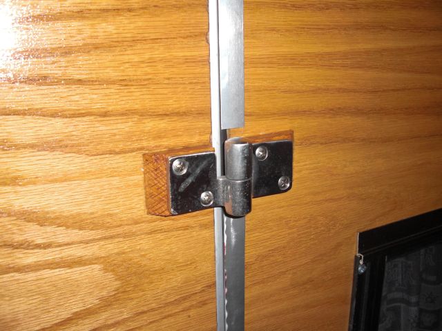

Postby Sparksalot » Sun May 24, 2009 8:15 pm
2bits wrote:I just set mine up in place with a spacer to lift it up like you did and and it seems OK and no trimming would be needed, is there something else I am forgetting about? (I will probably do a block like you did, not this strip, I just had it handy)
Look carefully at the photo below. The "leading" edge of the trim has been cut back about 1/4". Gotta love tinsnips. If I were doing it again, I'd offset the hinge center line forward of the door/wall gap to allow the door to swing away from the wall quicker. That would allow for the full width trim.
