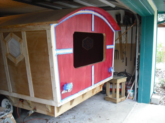

Steve_Cox wrote:A little trim work and a 1st coat of paint.
Steve, get rid of that blue accent striping! :lol: :lol: Looking good and love the color ;)

Postby CAJUN LADY » Tue Jan 20, 2009 12:28 pm
That color matches the window glass. Lookin' good Steve!

Postby S. Heisley » Wed Jan 21, 2009 12:03 pm
Hi, Steve:
That caravan fits in the garage and it's a standy! WOW! :o That's impressive! You really planned this well.
There's no tongue showing in the front of the garage...it's in the garage backwards and you don't have a pull-through garage! But, that caravan is heavy! Did you use one of those two-wheel hand truck thingies to manually pull it in?
The first layer of paint is on and the wood grain is still showing through, even in the pictures. Is that a special staining paint or did you thin it down a lot? Is the plan to always have the woodgrain show through?
Dang! Are we all gonna hafta come to Florida to see it? You'll have so many people coming down there that the whole state will fall into the ocean! :lol:

Postby Steve_Cox » Wed Jan 21, 2009 5:05 pm
Hi Sharon,
I got rid of the blue pin stripes today. Just didn't have enough time to do much else. I had no real plan, just an idea and it kinda evolved into this. It has been entertaining to say the least.
S. Heisley wrote:Hi, Steve:
There's no tongue showing in the front of the garage...it's in the garage backwards and you don't have a pull-through garage! But, that caravan is heavy! Did you use one of those two-wheel hand truck thingies to manually pull it in? I do have one of those two-wheel hand truck thingies, and I put the trailer in tongue first so to have more room at the front of the garage, also depending on which end of the trailer I want to work on. I would guess the trailer weighs about 1400# right now, about the same as my teardrop.
3 layers of CPES and 3 layers of gloss alkyd enamel and still have grain showing. I sanded with 220 grit after each coat of CPES. The CPES raised the grain a little. I was hoping for a wood grain look. I think if I had used a few coats of primer it would have hidden it.
Dang! Are we all gonna hafta come to Florida to see it? Yup 8) You'll have so many people coming down there that the whole state will fall into the ocean! :lol:

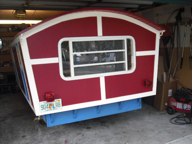

Another new picture
Postby Steve_Cox » Sat Jan 24, 2009 1:36 pm
Just a couple of pictures and a little closer to finishing.
Steve
