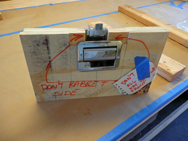

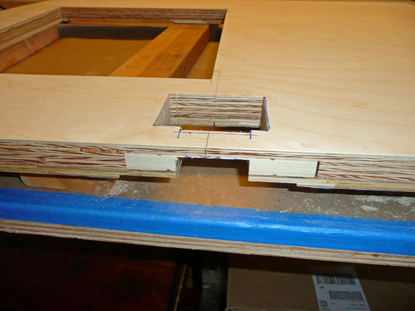

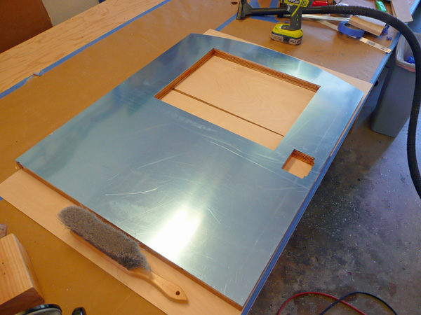

The biggest focus was on the doors. I liked the look of the RV locks that Mark (Planovet) used, so I changed my plan to use these. I had already mortised the doors for mortise locksets, so the first thing was to fill the mortises. Then I went about trying to figure out how to install the RV locksets.
Using a series of different jigs, I cut and routed the lockset openings.

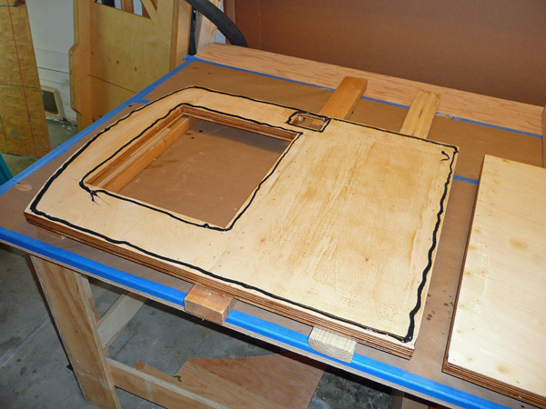

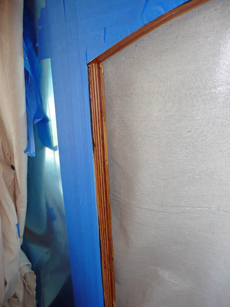

I then epoxied the outer plywood skin of the doors and door edges. After the epoxy cured - I waited until the next day - I applied 3M 4200 around the perimeter and openings to hold the aluminum in place.

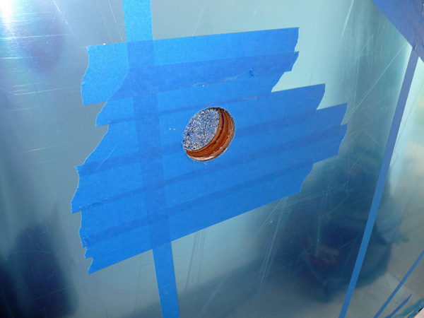

After the sealant set, I routed the openings in the aluminum.

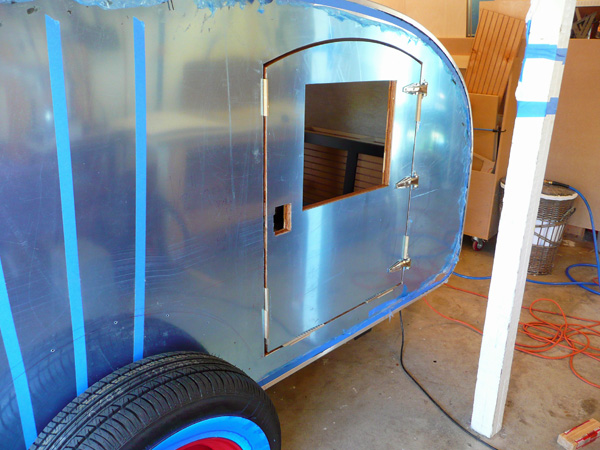

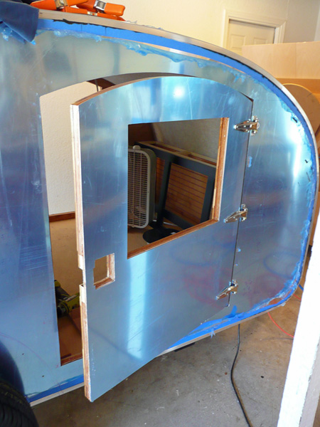

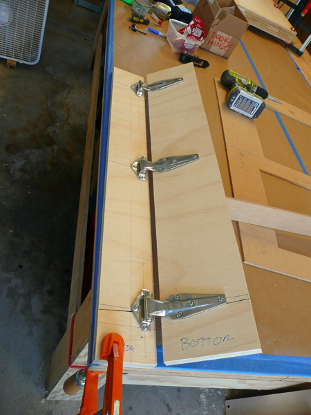

The last thing I did related to the doors was to mock up my hinges to be sure they were aligned and would open. I'll take off one side of the plywood and use this jig to drill the hinge holes into the teardrop.

I like the way you did your locks. I didn't use a jig, just cut the hole and then trimmed away wood a little at a time until I could slide the lockset in. Also my door was completely finished when I did mine, made it much harder.

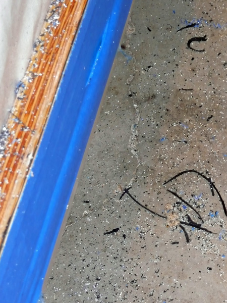

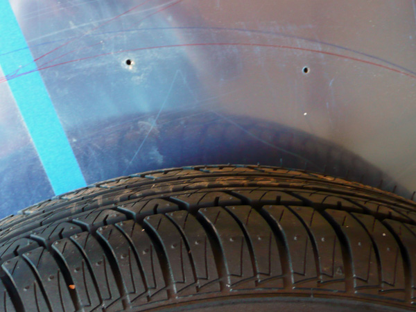

The heat has slowed me down but not stopped me. I've been busy doing a bunch of uninteresting details the last two weeks. My main projects have been: finishing the aluminum work, building the interior door surrounds, and deciding a fender location and drilling holes for the carriage bolts to attach the fenders to the sidewalls.
When I attached the aluminum to my teardrop, I rough cut the door openings. I needed to come back with a router and trim the aluminum to the openings in the sidewalls.
It's kind of messy, but a router does a nice job on the aluminum. It does throw aluminum "sawdust" everywhere.

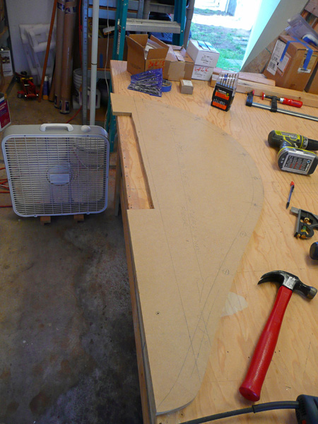

While I had those tools out, I also cut out and trimmed the opening for my electrical inlet.
I agonized over where to locate the fenders. Once I found a location I liked, I traced the outline on the sidewall. Stainless steel carriage bolts will be used to attach the fenders to the sidewalls. Rather than freehand drilling the holes, I made a template out of some scrap 3/4' mdf.
The template is in place. Now its time to gather courage to drill the holes.
Holes are drilled in the sidewalls.
Now its time for for the fender holes.
I drilled the holes in the fenders 1/16" larger than the sidewalls to give me a little wiggle room when installing them.

I didn't get much time to work this weekend, but I did get the doors hung. I've been putting this off, not wanting to mess up the aluminum with a bunch of holes. As it turned out, they almost fell into place.
And they even open without binding.
Now, I need to pull them off to add the aluminum trim to the doors and the opening and add the door surrround.
