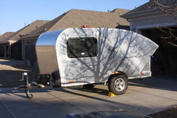

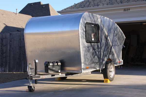

I got the hatch on this evening. It's not attached yet, it's just sitting in place.

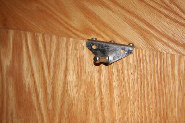

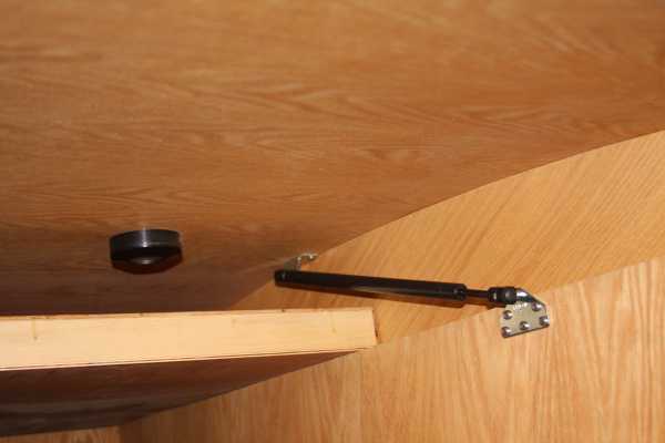

I managed to get the hatch attached today and even installed the gas springs (aka lift supports, aka gas struts). 150lbs gas springs are actually strong enough to lift the hatch and hold it completely open!!! I couldn't believe it!!! Unfortunately, the brackets I bought were a bit too weak and the weight of the hatch managed to bend one of them pretty badly. I'll either fab something better or see what I can find at camping world tomorrow. I didn't really like how these fit anyway.
It was very cool giving the hatch a gentle push and watching it open all the way up...

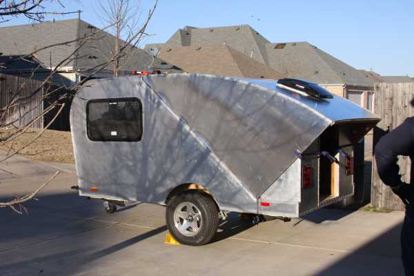

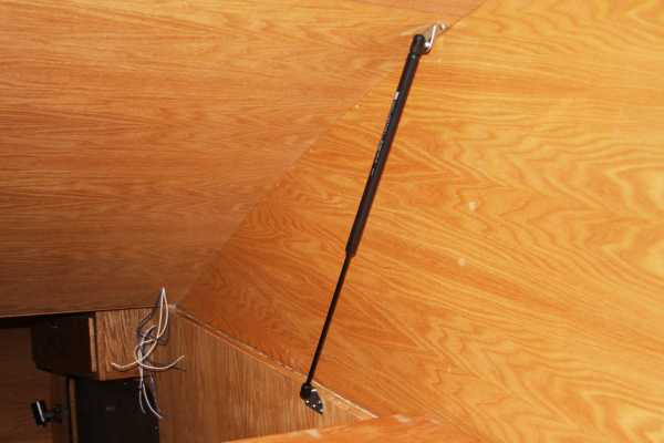

Postby wlivesey » Sun Feb 07, 2010 4:21 pm
I got the damage spring mount replaced. Everything is working great now.
Hatch closed:
Hatch open:
