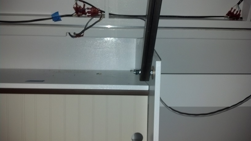

I also fixed the hatch rod's bolts, but for some reason now the pin is harder to insert than it was previously. :thinking:
20141012 Hatch bolt 1 small.jpg (65.28 KiB) Viewed 2675 times
You can see the carriage bolt I added to the hatch side, I still have to cut it to length so I can disconnect the prop rod from the hatch...

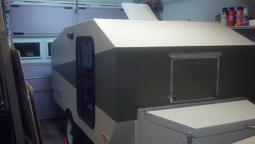

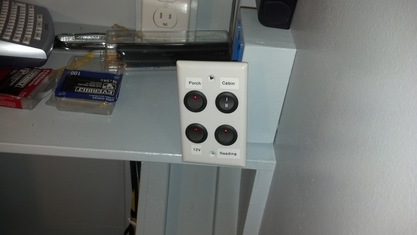

I started slow today, I installed the hatch and AC door seals, finished the hatch latch plates (the curb side one still rubs the paint a bit if you're not careful in opening/closing the hatch), cut each of the latch screws to length so they were flush with the back sides of the plates, and installed the latches. I also installed the license plate bracket and plate, turns out I didn't need to cut a hole for the prop rod's carriage bolt.
Next I installed the tongue box outlets, so I have 120v in (20amp), 120v out (20amp GFCI) and 12v out (switched inside the tongue box) available with the rest of the trailer buttoned up.
Then I labeled all of the switches in the cabin.

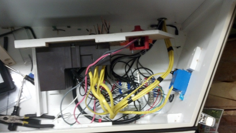

And finished all the tongue box wiring under the power panel.
20141013 tb wiring small.jpg (114.15 KiB) Viewed 2636 times

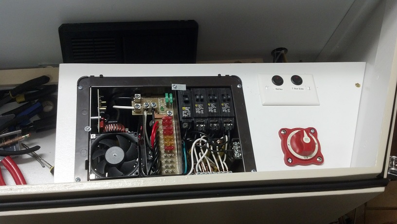

Then I set the power panel in place and pinched and stabbed myself all the way through wiring the circuit breaker portion.
20141013 power center small.jpg (110.29 KiB) Viewed 2636 times
The two small switches are for the tongue box's external 12v outlet and the galley's 12v outlet. I wanted the ability to control both of them and I couldn't figure out an easy place to put the galley switch in the galley without building another electrical ring so I settled for in the tongue box.

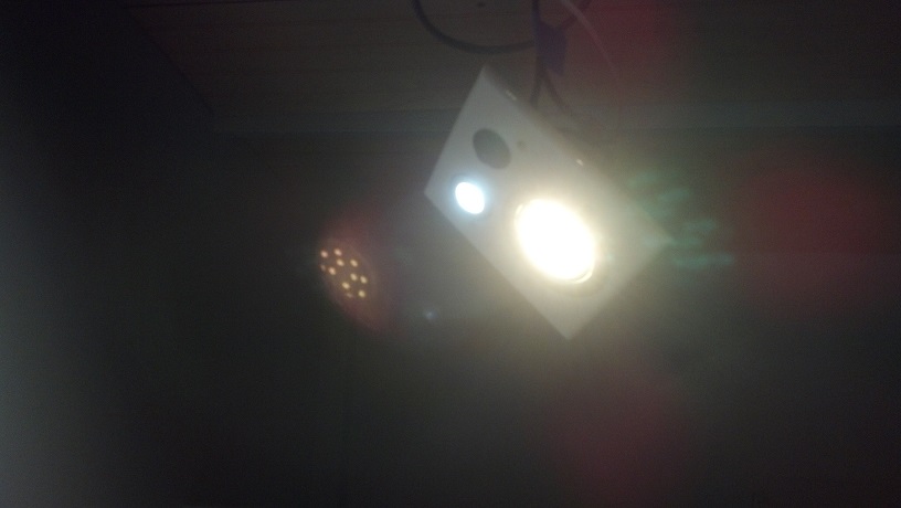

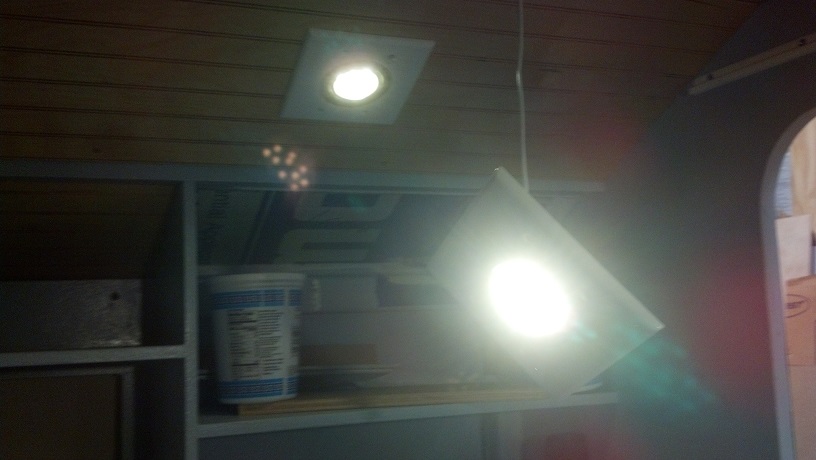

Then I hooked up the deep-cycle battery, flipped the selector to #1 and prayed I didn't have to use my fire extinguisher which I had handy, just in case...
And I saw:
20141013 reading and cabin light small.jpg (89.72 KiB) Viewed 2633 times
20141013 bunk light small.jpg (62.83 KiB) Viewed 2633 times
All of those switches were down when I turned on the battery power. :thinking:
It turns out I misunderstood the switch design, I assumed the little LED would be on the depressed side when the circuit is closed, it turns out to be the opposite so all of my nicely labeled switches are upside down. :oops:

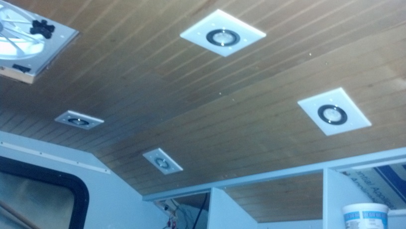

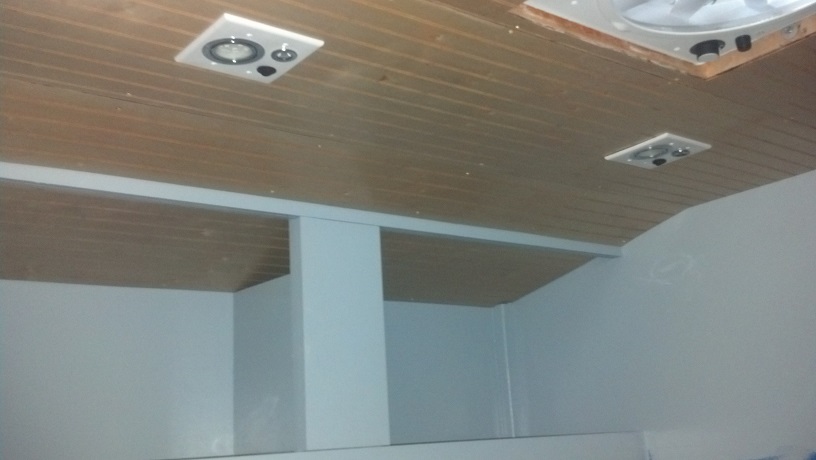

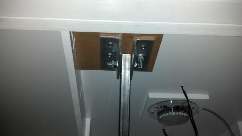

So I installed the light fixtures last night. My original idea was that old work low-voltage double duplex rings would be the perfect size for all my lights, they'd grab the beadboard and hold themselves up, etc. Only problem? The rings were twisted and bent in various ways and the beadboard isn't thick enough to hold them straight or give the arms something to grab onto. I had to improvise and used four #4-1/2" screws per ring to fasten each one to the ceiling. I also installed the rear cabinet dividers.
20141014 forward lights small.jpg (88.35 KiB) Viewed 2582 times
20141014 rear divider small.jpg (73.04 KiB) Viewed 2582 times
I still need to cut the access slot in those two ceiling panels before I can install them.

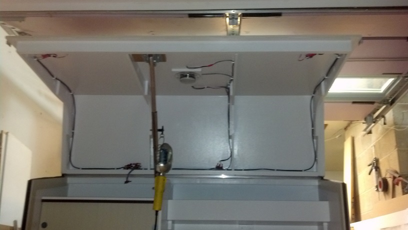

I also dressed all of the hatch wires.
20141014 dressed hatch small.jpg (84.97 KiB) Viewed 2582 times
I'll have to dress the lower galley wires this evening, and install the galley's 12v/USB box. The 120v line is just getting a wire nut and a note on the breaker for this trip.

Postby capnTelescope » Wed Oct 15, 2014 11:16 am
Kharn wrote:Only problem? The rings were twisted and bent in various ways ...
Good recovery. :thumbsup: Your light fixtures look like they were planned that way, not like there was any problem.

The low voltage rings are still in there, a normal #4's head isn't big enough to bulge the faceplate.

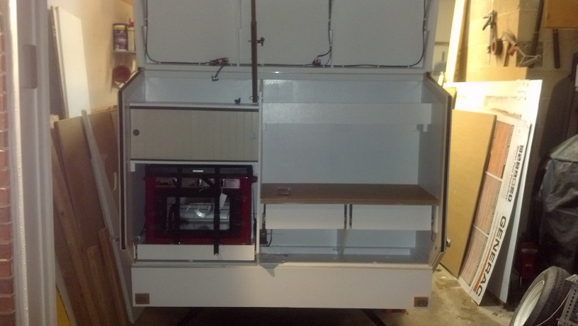

I also put the oven in its drawer and installed the footman loops and set the webbing to secure it.
20141015 oven small.jpg (98.54 KiB) Viewed 2526 times
When I put the oven in the drawer and went to close it for the first time I almost had a heart attack because it didn't fit under the cabinet by about 1/4". I pulled it all apart, measured everything, compared them to the CAD model, etc, trying to find the problem but everything checked out except for not fitting. Then I realized the problem, the oven has a bump on the rear of it for gas to get to the oven's bottom-mounted burner, and the bump is just slightly lower on the oven than the height of the drawer lip. I'd put the oven too far back in the drawer, so when I moved it forward a bit, everything worked out and the oven now slides under the cabinet without problem. :BE

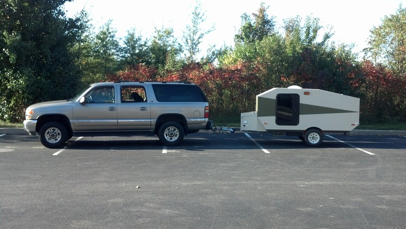

So after a 322 mile round trip, we've returned from our maiden voyage. :P
We hit the weigh station, the tear's axle only weighed 1300lb but I didn't unhook it to get the total weight. I was really surprised by that, I expected 200-300lbs higher, but the air conditioner wasn't installed and the two easy-ups, dry food, cooler, spare tire, 20lb propane bottle, 5gal of drinking water, dog cage, and fire extinguisher were all in the truck. The tongue box was absolutely stuffed to the top with our two folding chairs, dog tent, stabilizer wrench, wheel chocks, folding stools and 20amp electrical cord.
We stopped for a break on our way down. The camper towed wonderfully, with the truck in tow/haul mode, I didn't even notice it was there except when I'd glace in the rear view window, I could just just barely catch a glimpse of the porch lights in my side mirrors.

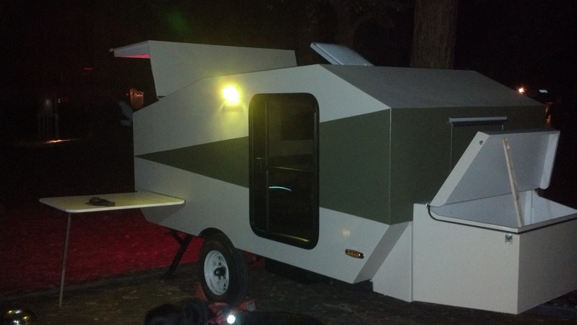

Then we had to set up in the dark.
20141017 arrival small.jpg (97.76 KiB) Viewed 2378 times

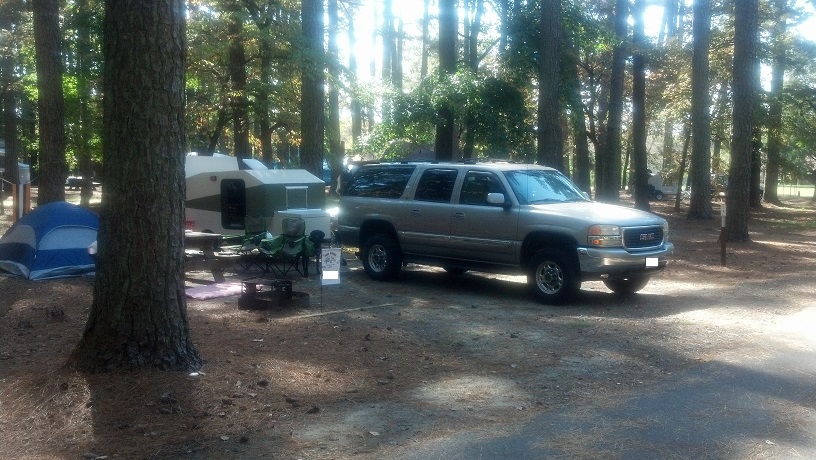

Our whole site in daylight:
20141019 site small.jpg (193.3 KiB) Viewed 2378 times
My wife agrees that this trip was incredibly relaxing vs our previous tent camping adventures. The dog's tent is really easy to set up, and although the weather could not have been better for Friday and Saturday, it was comforting to know we'd stay dry even if it took a turn for the worse. The temperature was about 74 degrees Fri/Sat, but it dropped to 54 degrees last night. We didn't even have to fire up the electric blanket, but we will during our next camp out in a few weeks. :snowstorm:
