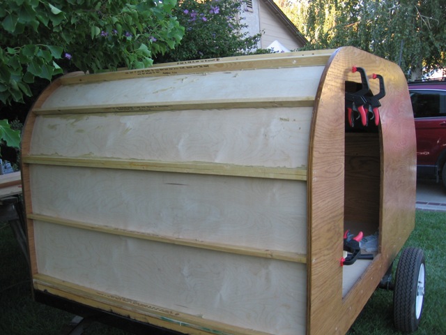

We cut, spliced and painted the ceiling in anticipation of getting it in this weekend. We had a separate post with a question regarding this:
Frosteez wrote:Question: It (the Generic Benroy plans) says to cut 5x5 plywood to 2 pcs 48" ea plus 1-12" piece. Why not leave 1 piece a full 60" plus 48"? Is there a reason I'm not seeing to have the 12" piece if you glue them together anyway?
We didn't really get an answer sooo...we left one piece 60" instead of 48" plus 12" and only had one seam. This seemed to work for us, tho I'd still like to know if there was a reason not to do it this way??!!

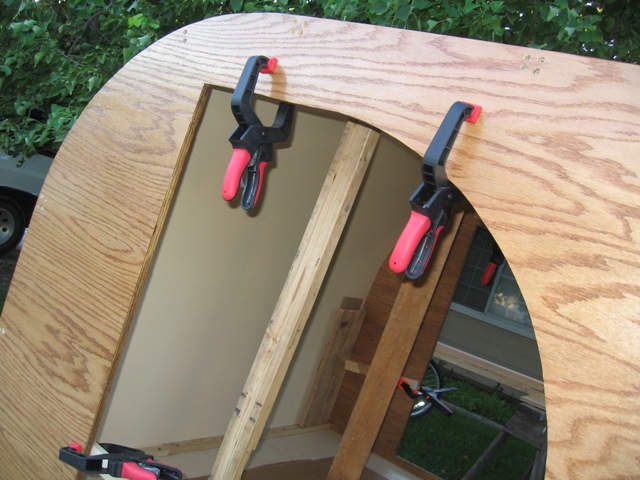

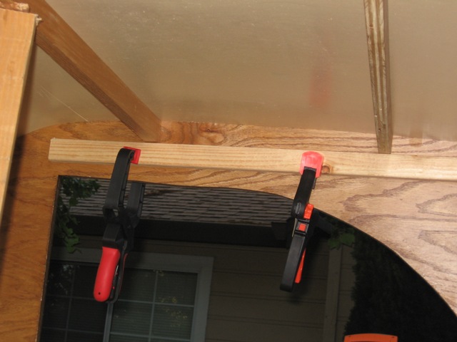

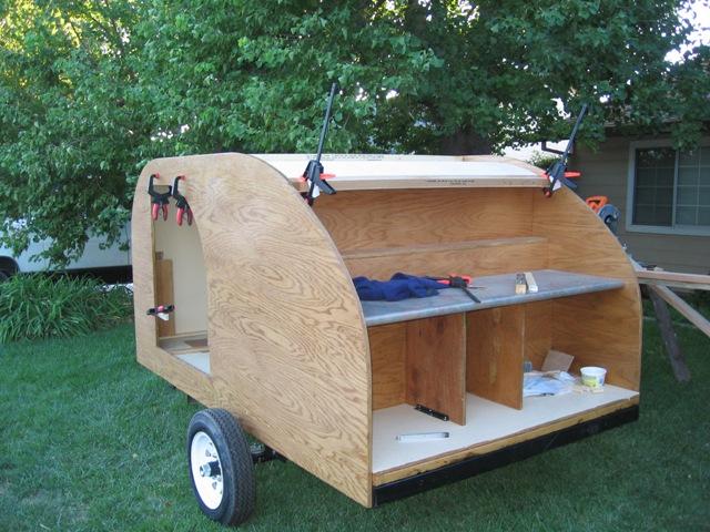

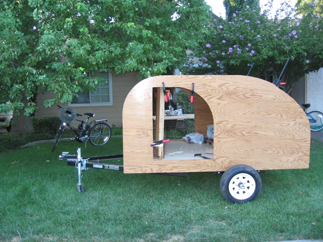

Friday and Saturday were stormy. but today was beautiful , so we pulled her out on the lawn and got the ceiling in!
Blocked and clamped
Front Yard "Workshop"...someone else mentioned how nice it is not to have to sweep up sawdust.
Really excited about the progress...feelin' like a trailer!

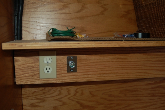

Now that we've reached the point in the build of wiring for electrical, it seems we both have serious cases of TD induced ADD. We have spent much of the last few days going round and round not only about HOW to do it..which I think we've finally got our heads wrapped around...thanks to so many helpful posts! ...but then there so many decisions! to make!
Ultimately I think we've decided to place the battery and Power Tender in a divided tongue box (thank you Larwyn, Mary K, MJ and Mandy for your recent discussion) and to place our S/P outlet and our GFCI in the other side. We will also be using an extension cord with built in circuit breaker similar to MK's.
Yesterday, we installed our Valley hitch on the CRV (I forgot to take a pic!). Not that we're hauling anything soon, but at least the box is out of the garage! It took longer than the 15 minutes described by others online, but once Leo figured out which muffler hook to undo it went on fine.

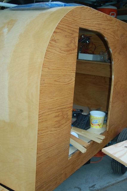

We did get the insulation in today and started the wiring.

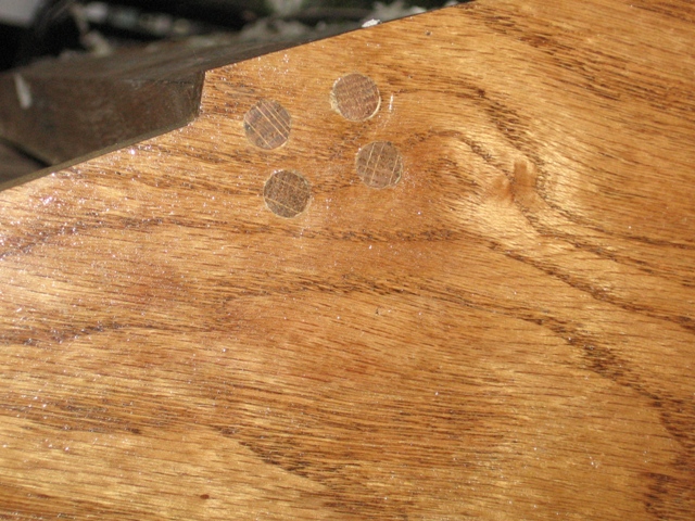

And I managed to get most of the holes in the sides plugged...all 80 of them!

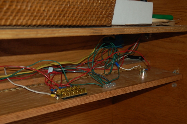

On rainy days Leo has been making his way through some electrical...so far so good!
We installed a piano hinge on the raceway for easy access...

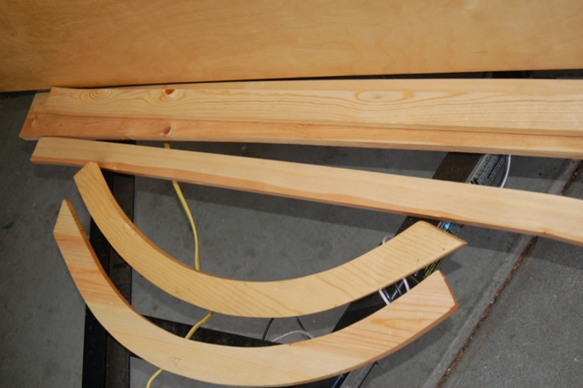

We have been working on wooden trim for weeks and weeks! Leo is a router newbie...and has had great success using a bottom bearing bit for all our applications so far. We were able to successfully mount and rout the top edge of the trim..but then....despite multiple attempts and using a router fence we ruined several pieces of trim trying to route the lower edge. Finally, I have to admit, we took the pieces, with top edge routed, to a friend of ours who has a cabinet shop, who, used his mojo to "make it so"!
We then started the process of multiple coats of CPES followed by multiple coats of varnish to all sides except for the face of the trim. We won't do the face until we've installed the trim, countersunk and plugged the screws.

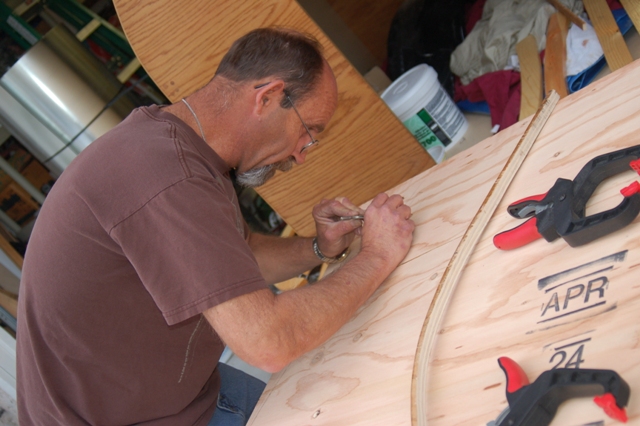

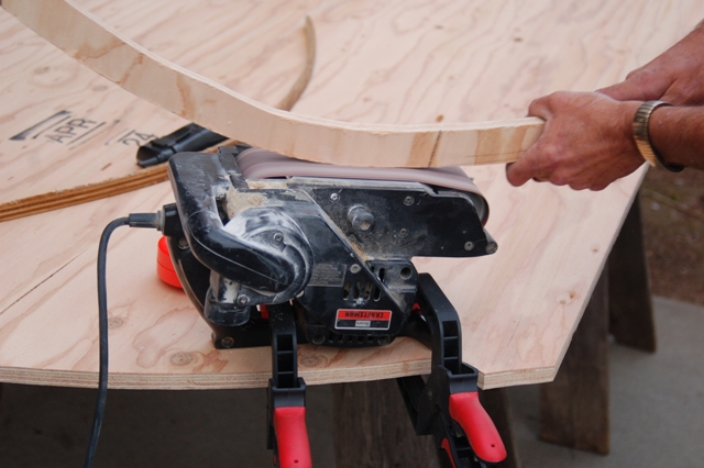

We've started the hatch. Here's Leo marking the template for the hatch ribs.
And his "table sander" to smooth the template. We'll use this one to rout the addl ribs.
