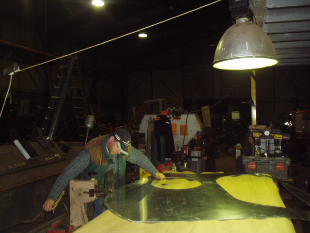

Postby dandan » Thu Nov 27, 2008 1:43 pm
only 1 hour on it today.
made some body ribs out of the off-cuts.
allways s good idea to remove the plastic protective before the welding.
wondered why it was a bit difficult to get it to run.
just getting things lined up & its time 2 pack-up again.
may not get on it again for a few days.
watch this space!
rgds dan.

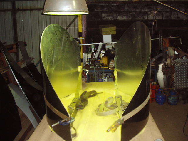

Postby dandan » Fri Nov 28, 2008 1:01 pm
sneeked 2 & 1/2 hours on it today.
i decided not to tack it together without putting a swage 15mm in from the edges.
this will catch & absorb any distortion from welding the open corner joints.
this is what the end panel looks like at the top.
will flatten the seam which joins to the roof.
probably wont get on it again till next thurs/fri. :)

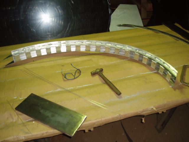

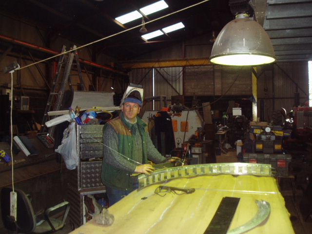

Postby dandan » Fri Dec 05, 2008 3:40 pm
hi 2 those who are watching.......
you are more than welcome to comment on what im posting.
please keep it clean, told my mother-in-law about the site & why the wife is being neglected lately. :lol:
not alot to report on, been building the stiffening ribs.
got 3 of these this size to make & a few more smaller ones too!
saveing the pretty welding for the outer skin.
will post again monday pm all being well.
feel free to make comments on what im posting. good or bad.
best rgds dan.

Postby angib » Fri Dec 05, 2008 4:28 pm
Those ribs look amazing - though I can't for the life of me work out what exactly I'm looking at. Is it two angles with lots of braces welded between them?
