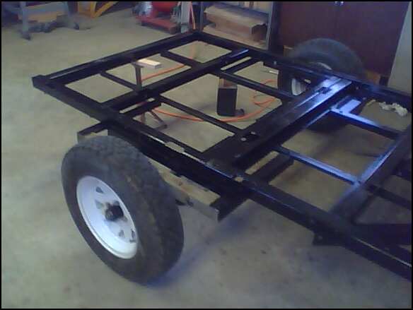

I'm going to be critical here. I'm glad your topic says: "my first teardrop".
That frame could carry a car.... on your second one, think: lighter.
Not that it won't work... just not necessary.

Actually, when you see it in person, it's quite light duty and not terribly sturdy. It is all open channel 1/8th wall and was originally rated only for 1100 lbs. When we used it as a utility trailer, we beefed it up slightly with about 25lbs of add'l angle iron to help with some of the flex. I estimate the new weight at about 140-150 lbs with axle.
I will admit, the new tongue is overkill!

Not a ton of progress, but here's what there is:

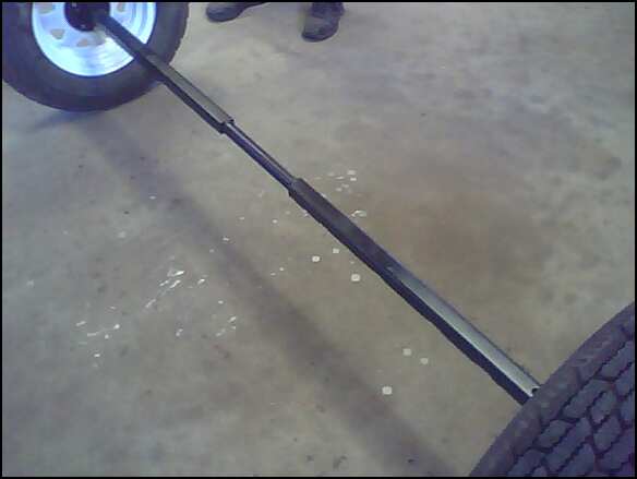

Finished painting the axle. As you can see, I cut the axle tube in the middle and inserted solid steel pipe and welded it up. This added some weight (about 35 pounds) but I trust it more than the old open wall tube axle.

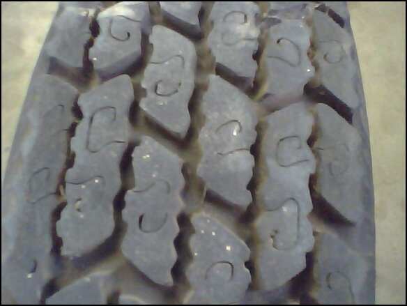

The old tires from great-grandma's Chevy II are mounted on the new wheels. Not too bad for about 40 years old...no cracking or noticable wear. The new rims will get a coat of black paint and I'm crusing eBay and local salvage yards for cool old hubcaps.
Here it is all installed.
We installed the tongue (another weight penalty at 44 lbs) and took it for it's first test drive. No wiggles, jiggles or otherwise! It tracked well with no tendency to sway (up to 70 mph which is faster than this trailer will ever see).
Weight with frame, axle, wheels and tires: 260 lbs
Tongue: 44lbs
Add $67 for new wheels. Total: $97
Next up: floor. Unfortunately even though my wife works for the areas largest building supply company we are having problems finding plywood in oversize dimensions. Updates to follow...

don't risk it
Postby ssrjim » Sat Jan 10, 2009 4:40 pm
Brad
You are not really going to risk 40 year old tires on this? 6 years is the max from every thing I have read. 7 or 8 maybe if you want to live on the edge but 40 is a no brainer. It is not safe. Get new tires after you are done. Those will make nice construction tires but don't put them on the road.

Postby bbarry » Sun Jan 11, 2009 7:45 am
I appreciate the concern. The elastomer rubber in tires is broken down by several things: a dry environment, exposure to UV rays, weather and of course, physical abuse. These tires have been stored in a dark place for their entire life and have seen none of the above. They were winter tires for the old Chevy II and probably don't have 5000 miles on them. I carefully inspected them for cracks, weatherchecking, etc. and am comfortable with them for now.
This trailer won't be venturing very far from home and never at highway speeds for extended periods of time. If the time ever comes to take a longer trip, I'll replace them with a modern bias ply trailer tire.

Postby Nitetimes » Sun Jan 11, 2009 9:08 am
bbarry wrote: If the time ever comes to take a longer trip, I'll replace them with a modern bias ply trailer tire.
Brad
Actually most of the modern trailer tires are going to radials. Much better ride and handling characteristics.

Postby Wolffarmer » Sun Jan 11, 2009 9:52 pm
I often wonder if there isn't a difference in tires of today compaired to 40 years ago. I have a tractor that has tires that are probably 40 years old. Still working great. Of course I don't get them hot with high speeds. No weather checks yet.
But I have seen some old pickup tires come apart in 3 miles
