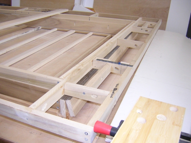

Before I finished gluing and screwing the stationary roof, I drilled and de-burred (smoothed) all the holes that the wiring will run through and added wood for light fixture support. (It’s much easier to drill holes in flat, un-joined wood, especially when that area is only a little over 6” wide on the sides and 8” wide in the front and back.) In these little trailers, I think it is usually suggested that the wires be run 3 to 6” from the sides; but, in my narrow area, I went with 2” from the outside wall; 1.25” from the inside wall. The holes may not look like it in the picture, but they are pretty much centered, top to bottom of each board. This will allow me to use 3 layers of ½” Styrofoam for insulation, with a channel cut in the middle layer to accommodate the wires.

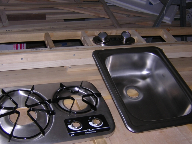

When planning and fitting for wooden supports, it is best to have the actual item that will be used. I special ordered brushed nickel, double directional reading lights to match over the stainless sink and stove and for over the bench beds.
