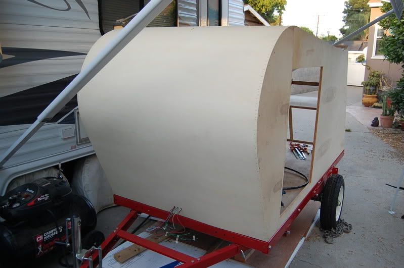

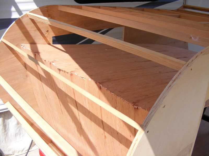

failure. i had some 1/8 hardwood ply, so i though i'd experiment to see if it could make the curve. it didn't. it went in nicely during the test fit, but when i pushed it away from the spars so i could add glue, it boke.
today i found some bendable poplar ply (at a really cool, 60-year-old lumber company in Long Beach). i've never worked with bendy plywood and i'm impressed with the small radius this stuff can conform to.

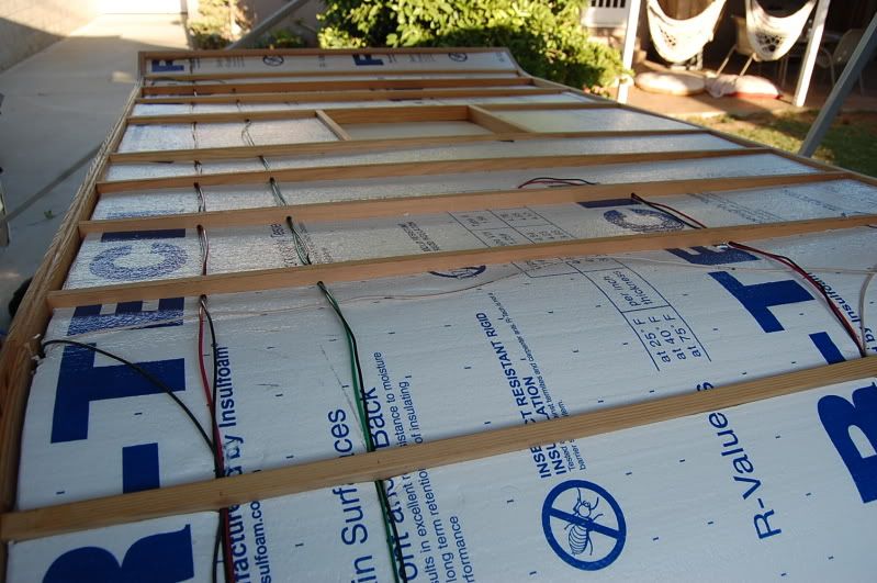

i love working with the bendy plywood! i cut it to width with my table saw, but when i cut the second piece to length, i was able to use a utility knife. it's like butta! i will install edge trim along the contour of the ceiling.

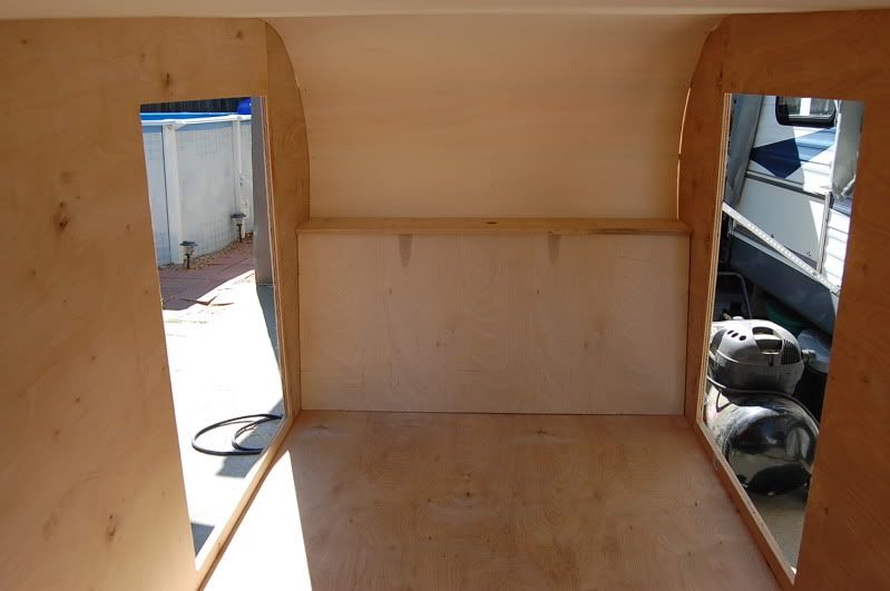

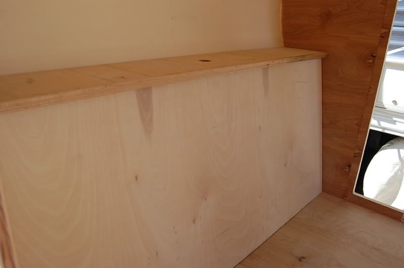

i built a headboard with a 10-degree lean so i can read in bed...i usually end my nights with a book and a glass of Maker's Mark. :wine: the shelf will have a 12-volt outlet.
the EPS was easy to work with, but it was messy. cutting it with my table saw made the backyard look like a snow storm had passed. my wife said the stuff even got in the house
three holes are visible in the lower spar. these will be my wire runs.

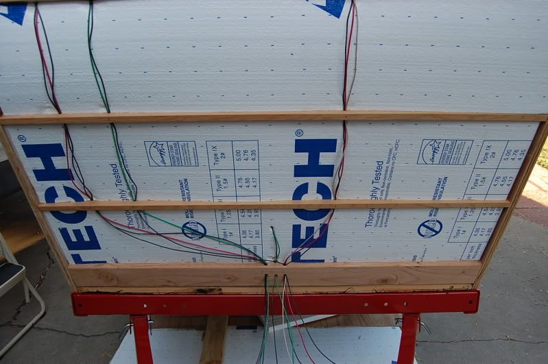

i ran the wiring. there will be a deep-cycle marine battery mounted on the tongue with a solar panel for re-charging.

i had enough bendy ply left over to skin about 3/4 of the roof. i'm waiting for the lumber company to get more (hopefully by the end of this week).

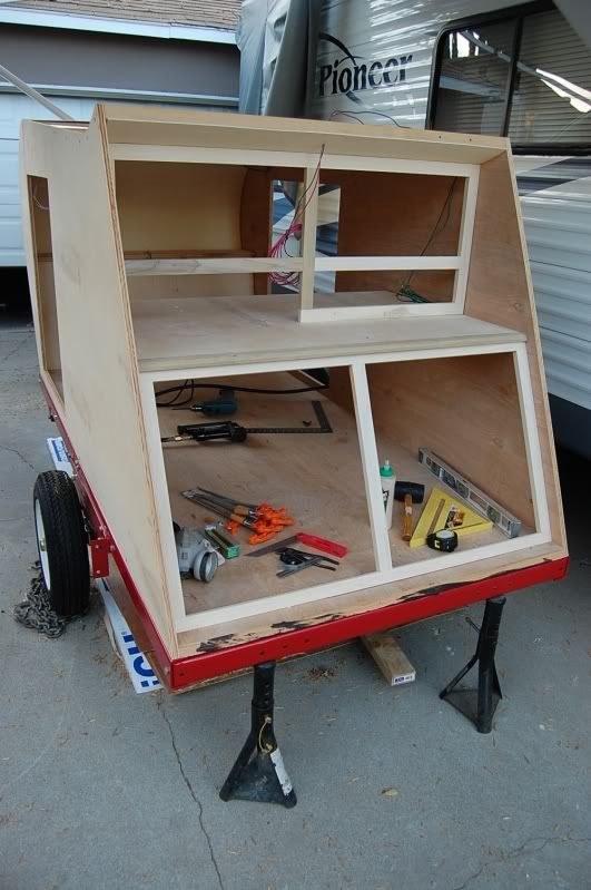

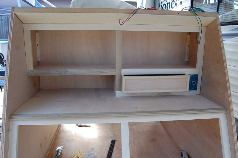

galley cabinets...i still have to build the doors. the dark spots in the vertical cleats are knots, not bolts (i don't like any fasteners showing anywhere). the empty space on the left will hold a stowed camp stove.
the stile just above the stove space was originally from the same length of wood that the stile above the drawer came from so they'd match, but i screwed up the cut and had to use a piece from another length of poplar. i didn't pay attention to the color. :(

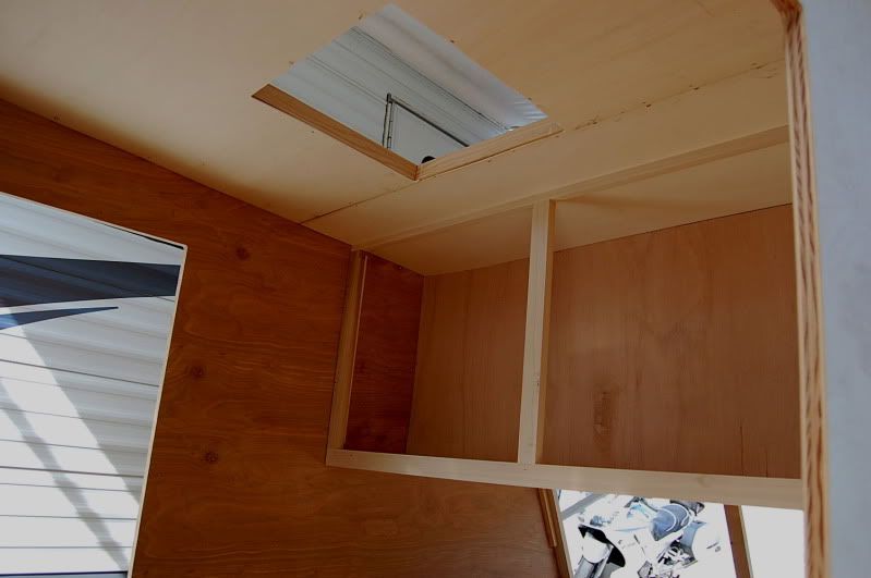

cabin cabinets...still have to build doors for these too. the seam running across the ceiling will be covered with a trim piece.
