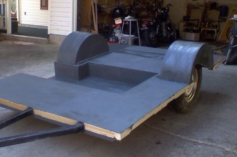

Postby Chip » Sun Nov 08, 2009 2:31 pm
well I did an oops! I got the floor installed before I put the wheel drums in sooo,, I hadda take it back apart (modular is great aint it) and install and waterproof them,,, put a fresh coating on floor and well while it was appart,,, anyway,, here it is :sans previous work,,,
this is spose to be fun aint it :thumbsup:

Postby doug hodder » Thu Nov 12, 2009 12:26 am
Chip... What are you going to do on the interior walls? Was yours originally done in a speckled finish? I'm thinking I might do that on the one I'm building. I'm tired of doing the finish on the natural wood. The Zolatone is a bit much, but on Steve E's he did a finish using a nylon bristled brush and we were able to speckle it so that it wasn't too overpowering. It appears that you have plenty of clearance over those wheels in those tubs! This'll be fun, we are about at the same stage of build so I'm looking forward to seeing your progress as I go along. Doug
Postby Chip » Thu Nov 12, 2009 5:42 am
Doug,,, I havent a clue as to what the original walls were,,, when I acquired the frame, it had a bit of the floor behind the foot well, the wheel tubs and the exterior side metal and windows stacked on top,,, I roped it all down and pulled it home,,, I told my daughter COME LOOK WHAT i GOT, at which she rolled her eyes and shook her head,,,, Dang,,, I was proud of my treasure,,, :D I plan on using some natural wood inside but paint is prob gonna win out on ceiling and cabnets just to break up the all wood thing,,, The tubs have good clearance but what the pic doesnt show is tallllll 15 inch tires sitting under them,,, I since pulled the 14" rims off the tear, switched them out and dropped the floor 2" which is mobetter for me,,, since I am not going to try and restore the scotty but build a Scotty like trailer, I can use about anything I want and still be right :thumbsup: I have reinstalled the bed frame, cabnet base and now trying to figure out the doors,

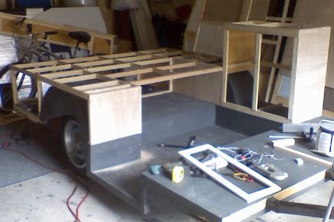

Postby Chip » Thu Nov 12, 2009 4:04 pm
bolting stuff back on,,,,, hopefully no more oops

Postby Alfred » Thu Nov 12, 2009 4:44 pm
Chip wrote:bolting stuff back on,,,,, hopefully no more oops [/img]
chipper
Hey Chipper,
Now that you've had your one allotted 'oops' for the build, I think you're good to go!
Still looks great!
AL in Asheville :thumbsup:
