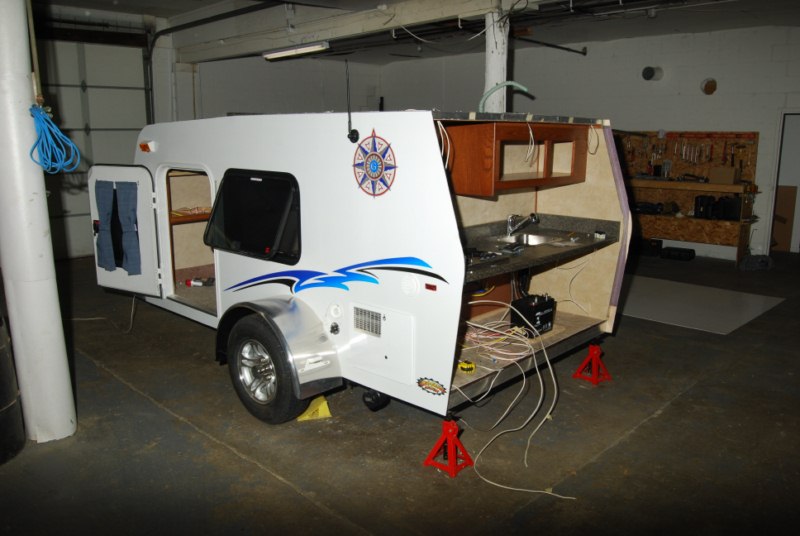

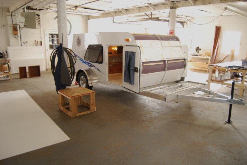

I have been looking for a generator to supplement the solar panels and happened on a Kipor 2400W new used as a display for 300$, in Elkhart. So I stopped in to visit and see progress at Eye4Design.
Front view
Side

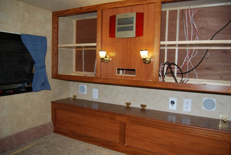

Galley

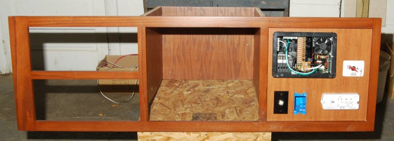

Lower cabinet (upside down :roll: ) There a shelves for the center a drawers for the right side.
Inside
The plumbing is done, and the wiring is with in a couple of hours of complete.
