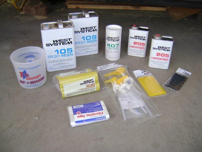

Donutboy wrote:Caught the final day of the West Marine sale today, and loaded up on West Systems Epoxy. Guess I gotta figure out how this stuff works now.
:shock: Wow looks like you're set, I'll be watching because I'm gonna be doing the same thing here in a few months
The first time I used epoxy was on my build. I had put it off because I thought there was some mad scientist, weird alchemy aspect to it. Actually, it was no trouble at all. Just measure correctly.
I don't know what speed hardener you have (I used Raka) but if it is a slow or medium, and we're having a cooler day here in Texas, you may want to heat the mixed batch for 10-20 seconds in the microwave to make it thinner. By the way, the plywood for my teardrop had sat around for about a year before I applied it. You'll be amazed at how much of the first coat is absorbed.
Gig'em, Tom :thumbsup:
Postby angib » Tue Dec 22, 2009 11:19 am
aggie79 wrote:The first time I used epoxy was on my build. I had put it off because I thought there was so mad scientist, weird alchemy aspect to it. Actually, it was no trouble at all. Just measure correctly.
And, on the first one or two jobs you do, think how much resin you will need and then only mix up half of that.
You will be caught out at some stage by the epoxy going off before you have used it all - everyone, without exception, does this once or twice - so you might as well make the mistake with a small quantity rather than with a large one...... :thinking:

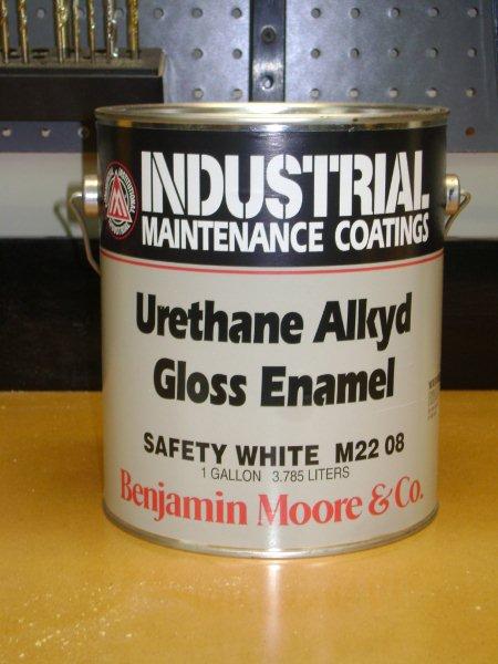

Bought the paint today, ending one of the more difficult decisions I had to make.
Editing the post to add the name of the paint for search purposes. Benjamin Moore M22. This is similar to P22. One replaced the other, but I forget which.
