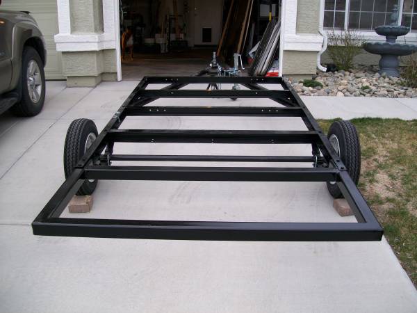

Here is the after picture of Pam's chassis. It took longer than I thought it would, but it turned out very good.
Here is another angle of the frame. I did not use any mud on the frame to cover up the welds. That is all steel. I did grind the welds to get a nice finished look. I used 45 degree corners at the rear so it all was enclosed and it looks better and more appealing to the eye this way. We hooked the trailer to the TV and we both jumped up & down to see if it was OK. It did not budge at all.
