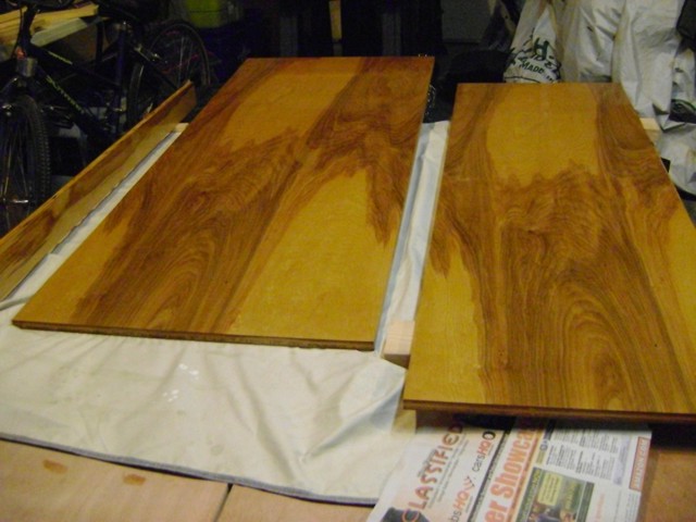

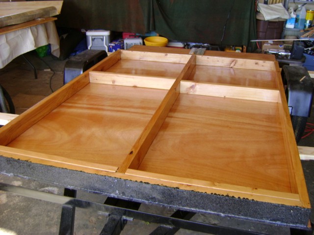

I take Sundays and Mondays off at my shop, so Sunday I continued applying coats of Helmsman Spar Urethane (HSU) to the underbed storage and bed platform. I figure I might as well try to make as much of the teardrop water repellent as possible. I had the unattached pieces out in the driveway on sawhorses since the sun was nice and warm but the wind was cool.
These three pieces have 3 coats of HSU and I did them along with the outside walls so they're much smoother and "glassier" than the above pieces.
I think it's because:
1) I did a better job of sanding and wiping between coats. Also the 3/4" plywood is much better quality than the 1/2". You can actually see through parts of the top veneer of the 1/2" so I didn't sand it much especially pre-HSU.
2) I didn't work the brush so hard and fast just tryin' to get it done, and
3) possibly because the outside walls and these three pieces were first coated with CPES and not the cheaper alternative of 75% mineral spirits 25% polyurethane like the underbed storage and bed platform. Any thoughts on that?
Sunday I applied another coat of HSU to floor and storage pieces. Was going to start assembling this:
but since it was Halloween and there were MANY parts, I thought better of it and just put it away until Monday after my dentist appointment. I narrowly averted a $959 crown and got a $243 filling instead. Our insurance covers about $50 on a filling and zilch on a crown. :x What a deal! Send your kids to dental school!

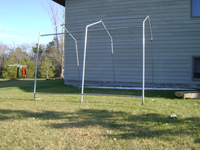

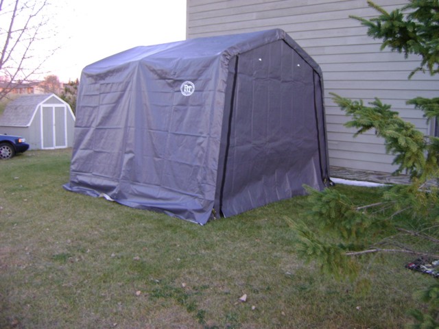

So Monday the teardrop winter quarters/building space went from this:
to this (done all by my little bitty 5' 2" ol' self):
Then my friend and neighbor happened to walk by and I roped her into helping me get it to this:
BTW, if you notice in shed pic 2, I don't usually hang clothes on the line in November. No. 3 Son is preparing his wardrobe for Deer Hunting Opener tomorrow morning.
These clothes have been on the line for a week to get the smell of civilization out of them before he heads into the woods and shoots Bambi. :cry: You see, I grew up in a big city where I neither hunted nor fished. In the years that my boys and husband have hunted deer (not very many as husband is not an avid hunter/fisherperson), I've told them I don't want to see a dead, gutted deer hanging in the garage or off the deck, just bring it home in white freezer paper and I can eat it. But I do really like the venison sausage that the local butcher makes. Am I a hypocrite or what??

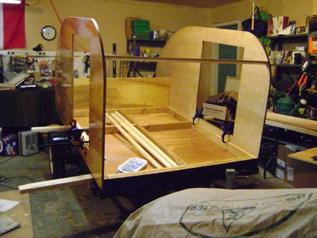

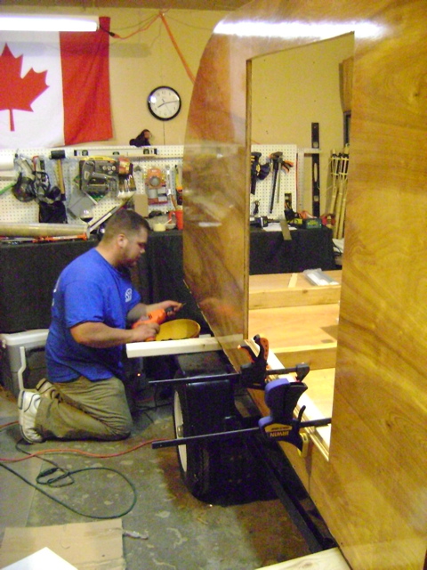

Wednesday was a monumental day for the Lily Pad!
The walls are now firmly attached to the floor system, and one spar has been secured to keep things square as the PL(can't recall the number right now) adhesive dries. (The lower bulkhead is just wedged in there at the moment.) Oh joy! Oh joy!
Here's pics of the process. No. 3 Son manning the drill:
and (drumroll) now you're watching adhesive dry:
We had one small booboo. Andy screwed one of the screws a little high. :( It will show even when the teardrop is dropped into the frame of the trailer, so I figured that's where I'm going to put the penny that marks the year the teardrop was built. I thought I'd drill a very shallow hole, CPES the bare wood, epoxy the penny in, caulk or somehow seal any space, and give the outside walls another coat of Spar Urethane. Any thoughts on that idea?

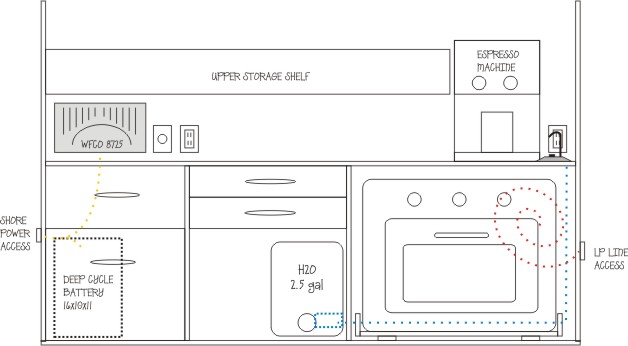

Now it's on to plan the galley since now I can ACTUALLY, PHYSICALLY SEE how deep, wide and tall it will be.
Here's my first plan (although I've already made changes :thinking: ) Fewer drawers for one thing. The espresso machine is optional and only for times when there's shore power.
I was thinking that I could place the WFCO 8725 behind the battery in the lower left corner of the galley, but facing into the sleeping compartment (I'll shorten the drawer to allow space for WFCO). There should be enough room for air circulation for it and the battery in the one space. I'll put a small vent on the side wall to vent the battery as well. Can the two be in the same space? Safety issues?
The Camp Chef Oven will be on the right side of the galley and slide out when I want to use it. I have contemplated putting a protected copper line under the trailer, but that kinda stumps me as to how to connect things. I already have this black gas hose that will reach from the galley to the 5# cylinder mounted on the tongue. I thought I might drill a hole in the side wall so that, when I'm ready to cook, I just pass this rather large fitting attached to the end of the hose through some kind of weatherproof access port and run it under the side of the trailer up to the gas tank. Just detach and place back behind stove when done camping.
I remember our old Bethany pop-up camper had something like that, because I could hook up the stove on the inside or the outside of the camper and I would push the hose through a weatherproof opening on the side of the camper. I've tried to find one on the internet but haven't had much luck. Kinda like the electric or water hookups. Something like a central vac outlet, but weatherproof. Any ideas?

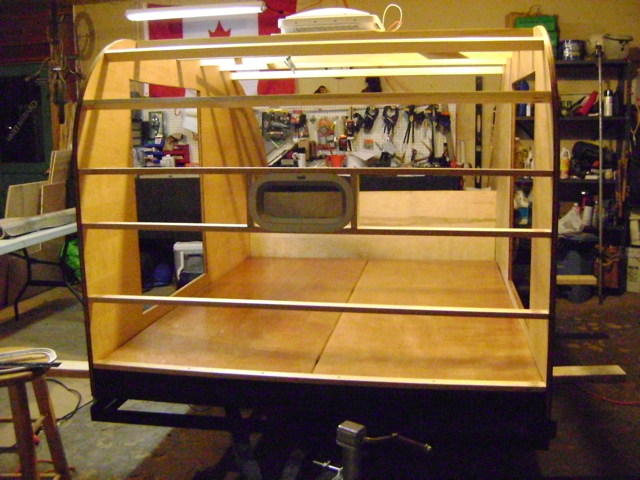

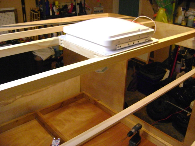

Progress to report. All except the double spars for the hatch are installed. Lo-o-o-ove that little ol' Kreg jig. That Kreg right angle clamp sure would've come in handy, but for $25 :shock: I figured I could just buck up and hold the spars in place. It's a little tricky to keep them from moving. Hey, but I've been doing a women's weights program twice a week for almost a year and I've got more muscle tone than I have had most of my adult life. :ok:
Just had to get the roof fan out of its box and set it in its future home to see what it'll look like.
I put the vertical braces in for the little Gebo window in front. I used the scrap from the poplar 1x2's for the hatch. It was getting pretty late, so I left the double hatch spar to install when I wasn't so tired. Figured I'd just do those two little pieces. First, I had a heckuva time getting the drywall screws to go through the spar into the braces. It was making a loud creaking noise and hard to drive in. (It finally dawned on me that the poplar must be harder than the pine and the screws were Phillips head.) Second, I screwed one brace on the wrong side of the line. Fixed it and then went to bed. Today I thought better of it, took out the braces, used the Kreg jig to drill holes in them, glue and mount them. Much better now.
Notice that I laid the cover for the underfloor storage in place on Photo 2. I'll attach hinges when I get the bulkhead and front wall covering in place. I might have to trim them down a bit.
I'm heading over to Renneberg Hardwoods in Menahga tomorrow a.m. (@ 30 mi.) to pick up some 1/8" 5x5 sheets of Baltic Birch to do the inner front wall and ceiling. I decided against using the white vinyl Polymax for that. I'll have to put it in the pile of stuff to return to Menard's.
I had visions of a white ceiling (hence the vinyl polymax) and a birch "headboard". I toyed with using the piece that would be the galley counter as the headboard, but then that meant finding some other counter material...tile...laminate...butcher block??? Decisions, decisions, delays, delays. So I'm going with the KISS principle (keep it simple stupid). One kind of material for the front wall/ceiling (then I don't have to monkey with working a transition around the little window), and keep that gorgeous grained piece of birch plywood for the countertop.
Trying to make sense of the WFCO 8725. The manual leaves a lot to be desired as far as clarity. Of course, it's not like I have a vast understanding of the basic principles of electricity and wiring. :scratchthinking: Found some great pics from N523RV/George & Sandi's build pics here that are helping me understand how to bring light and power to the Lily Pad. Thanks so much you two!

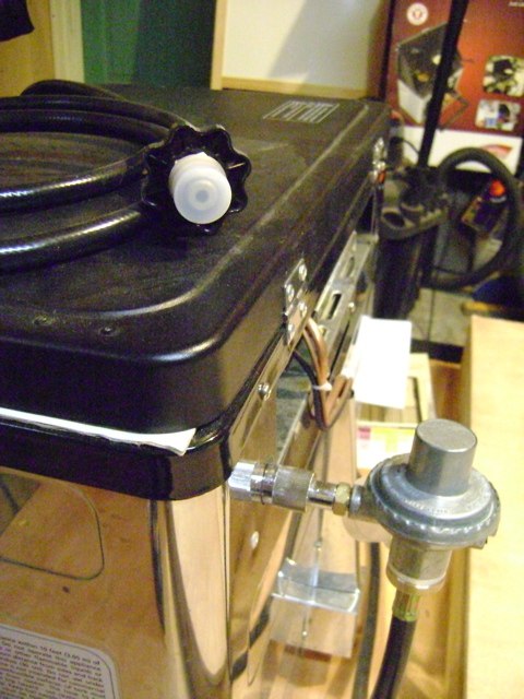

I was studying my WFCO 8725 after looking at your pics, and it looks like the two circles on the backside top right side are knockout plugs, right? Looks like you only had to knock out the one.
And I can remove the front panel and door by releasing the two tabs on the backside top, correct? Would a screwdriver work? I don't want to damage it. I'm really looking forward to your post. I try to ask folks (who I think should be knowledgeable about such stuff) about wiring 12v from scratch and they all just nod and smile and look a little stunned.
