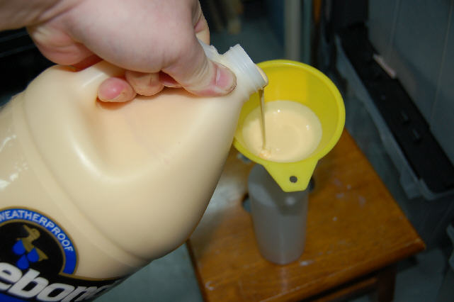

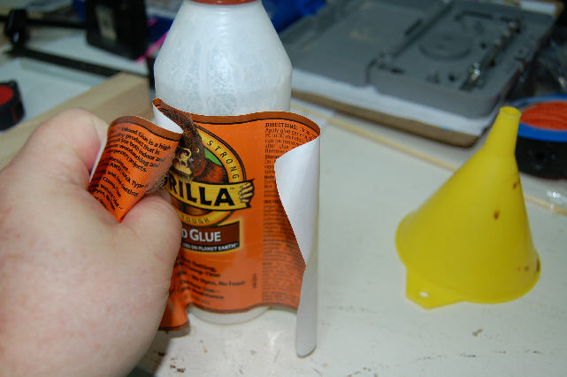

Used up the Gorilla Glue and so its time to switch to the titebond II
I like the size of the Gorrilla bottle applicator so I just used a funnel and poured up some Titebond

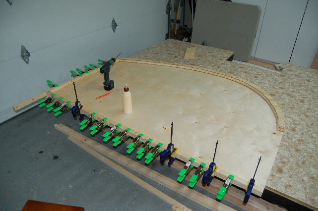

Got a little bit done tonight, a couple of sticks glued up on that second front side panel.

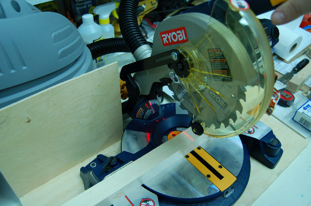

One thing I did during my garage cleanup is move to a small miter saw with a small vacuum to pick up dust.
Cannot say enough good things about this little Home Depot 89 dollar 7.5 inch miter saw with laser. Comes with a good blade and is setup good right out of the box. The small vacuum came from Lowes for 29 bucks. The whole setup is quiet enough I can work a little later at night. The saw has a built in blade brake and makes a cut noisy for only a few seconds. My full size table saw is just way too loud for evening work.
I built a little base and backsplash to block the shavings/dust. After every cut I remove the vacuum tube and clean the whole area. Stays very clean
At this point in the build I only need the larger saw for ripping my studs from 2x4s and cutting panels. The little miter saw makes it simple to sneak up on a cut. I like to cut once a bit long and then make a second cut to make the joint very tight.

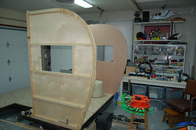

Postby Cyclicpitcher » Thu Oct 28, 2010 4:20 pm

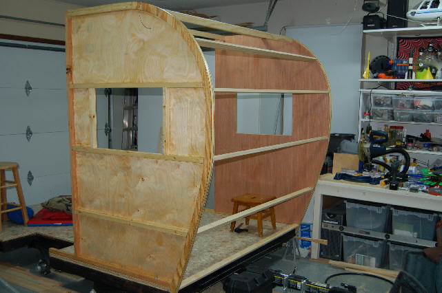

Well today was milestone number 1 for me and that is raising the second wall into place. I can now see the camper rising from the dust!

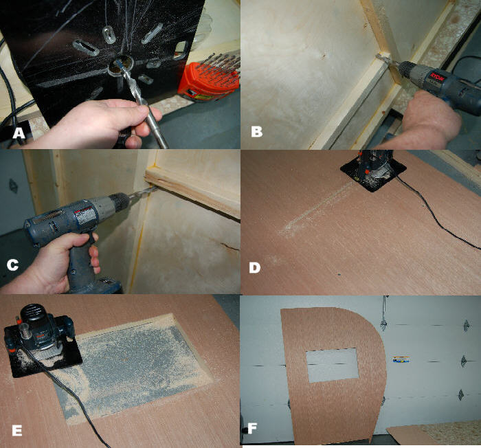

The last thing I had to do before finishing the second wall panel was to cut out the window. A router makes this a simple and most professional job.
A- pick a drill bit that will let the edge router bit fit through the paneling.
B - Drill a hole in a corner but not directly in the corner of the frame
C - I like to drill a hole in all four corners to know where I am going.
D - Place the bit in place and begin to cut in a clockwise direction working to each corner.
E - The panel removed and a lot of sawdust!
F - The final result! Makes me proud when it all works as expected!
And Now the Reveal!!!! Two walls!!!! Yeee Heee!!!! :applause:
For some reason I been holding my breath on the front panels. Now the fun starts!

Postby Cyclicpitcher » Fri Oct 29, 2010 12:33 am
Cliffmeister2000 - I am making it up as I go !!! :lol:
I didn't want to have to deal with each side being 6' by 10 foot long.
My garage is too small for this project and too heavy for me to manage.
I haven't decided what to do fully on the back end. My plans are to do a modern rear like a square box in the back, But if I build from the inside out I can frame in four foot by 6 foot sections and bolt them together.
Once I build the next sections, I still have time to decide if I want to add some curves to the rear. I want to put in a large door and some kinda galley access. Some parks dont allow small scooters and so a different config on the rear door could focus on a galley. A square rear end with a floated panel that bolts in would allow two door configurations. So I have a lot of ideas and that's what makes this project fun for me.
So that's my story and I am sticking to it!! :thumbsup:

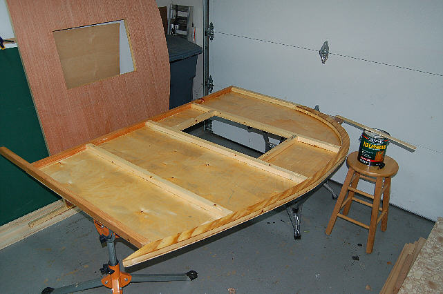

Postby Cyclicpitcher » Sun Oct 31, 2010 1:37 am
Update: Taking some time to paint both front wall panels with Spar Urethane on both sides. Want to get a good seal on all exposed wood at this point before I permanently mount the walls on the floor base.

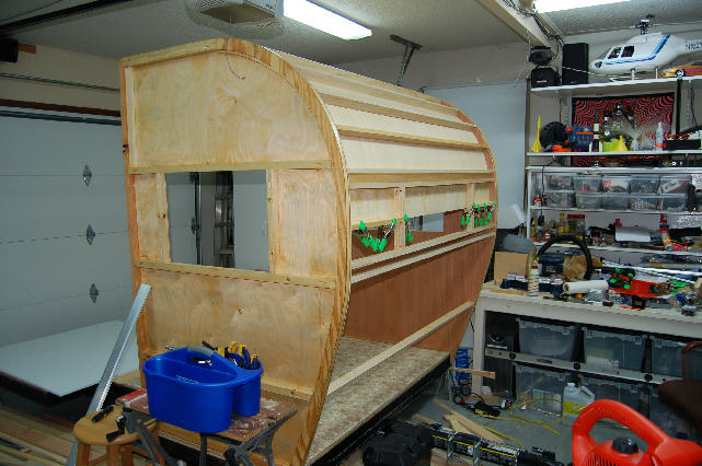

Postby Cyclicpitcher » Wed Nov 03, 2010 1:07 am
A quick update: Urethane dried. Currently installing horizonal spars :D
Purchased Lowes Select Pine 1x4x8 @ $7.20 each and ripped them in half
I found those boards to be perfect! No knots and little to no warp.
When the 1x4 is ripped in half it makes a perfect spar because the KREG jig will allow for both screw slots to be used as fastener points. I found the distance between the two walls to be 70 and 3/4 inches. Next I need to frame the front window...
The harder you work the luckier you get! I believe it! :thumbsup:

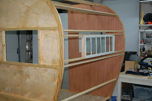

Postby Cyclicpitcher » Thu Nov 04, 2010 1:02 am
Small but steady steps...
Got the front window mount installed tonight!
Cheers!
CP
Cyclicpitcher
Posts: 37
Images: 70
Joined: Sun Sep 26, 2010 7:47 am
Location: Memphis TN
Re: small steps
Postby Cliffmeister2000 » Thu Nov 04, 2010 6:51 am
Cyclicpitcher wrote:Small but steady steps...
Cheers!
CP
Is that a jalousie window mounted sideways? If it is, be careful of leakage. Also, depending on how it was made, be careful the glass stays in tight.

Postby Cyclicpitcher » Thu Nov 04, 2010 3:31 pm
Thanks Everyone for your comments!! :thumbsup:
Cliffmeister2000 -
No, it's not a jalousie window , it's a Transom window for a playhouse/yardbarn. It is one piece of glass and it has small plastic rails that simulate multiple panes. The glass is very tight in the frame and it looks like I could remove those rails to make one solid window.
I do plan on making an outside cover that will be hinged to protect against road rocks when traveling.

bending birch
Postby Cyclicpitcher » Sat Nov 13, 2010 8:44 pm
Well a little progress has been made by adding the ceiling panel made from 1/8 bending birch plywood. This stuff was easy to cut using a straight edge and a razor knife. I placed the seam along the center of the window frame. If I add a small shelf on each side this will hide the panel seam entirely. Once the glue dries I will be able to cut out the top part of the window opening.
