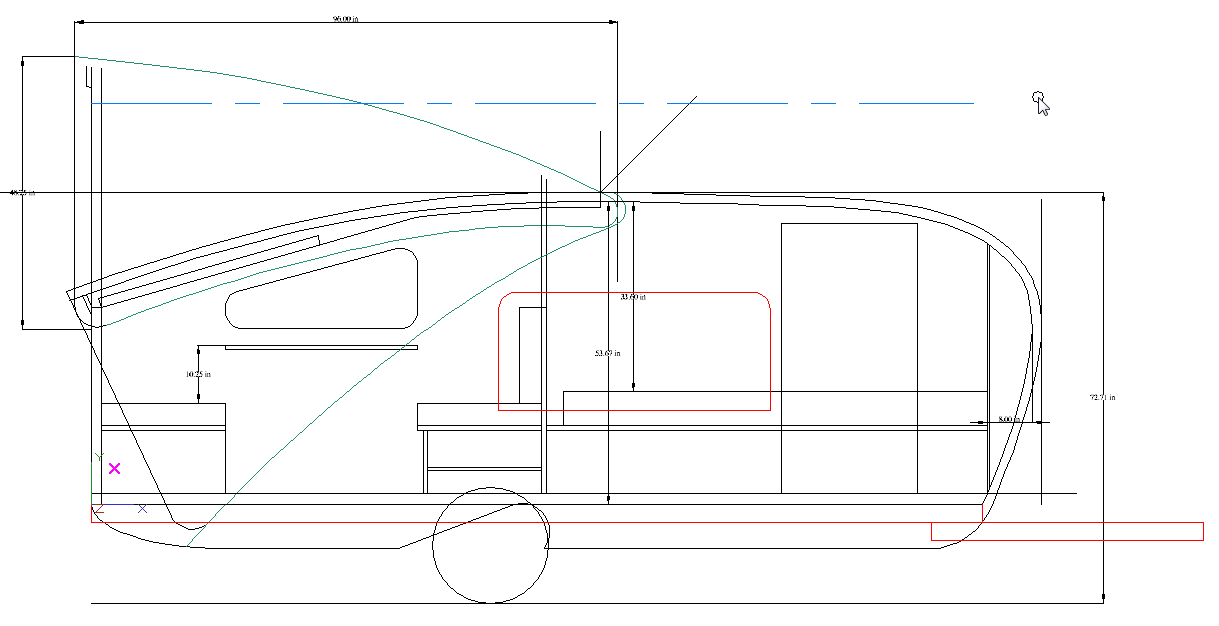

Here's the drawing board as it stands right now...
(sorry about the large image...)

Postby RAYVILLIAN » Sun Jan 09, 2011 9:35 am
Gee Mike you were up late lastnight. Play with going out to 6' wide. It gives you alot more flexibility on the interior.
Our bed room is 6 by 6 which gives room for potty and dressing room and the galley is 6 by 6 also which is really comfortable.
With the chisel nose I don't think it will give you much more air drag.

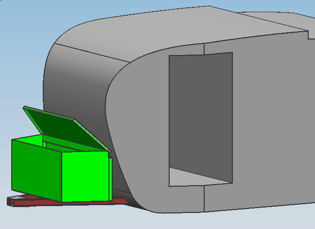

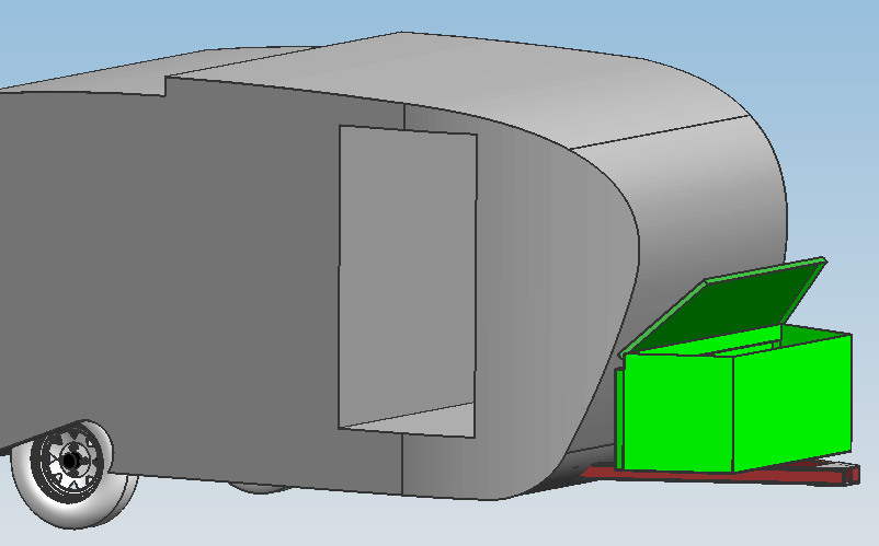

Postby mikeschn » Sun Jan 09, 2011 1:16 pm
I played with the front end a little bit this morning. You can see I made the nose flat on one side and curved on the other side...
It very quickly became apparent that the nose interferes with having a completely flat door. And I'm thinking I don't want to build a curved door.
Any other ideas?
Postby Cliffmeister2000 » Sun Jan 09, 2011 1:45 pm
You could move the door back behind the curve, but that would cause some other interference, probably

Postby High Desert » Sun Jan 09, 2011 1:56 pm
Mike, with the break point for the front sidewall curve were it is in the drawings, will that effect the bed area inside? Does it work to move it forward a bit, in front of the door?
