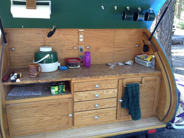

And yes, Bruce, you have seen that cooler cozy! 8)
