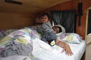

I've uploaded a few photos from my iPad. According to the Tapatalk app I'm using the maximum number of attachments is three. When I get to a computer I'll upload a few more and link them into this forum.

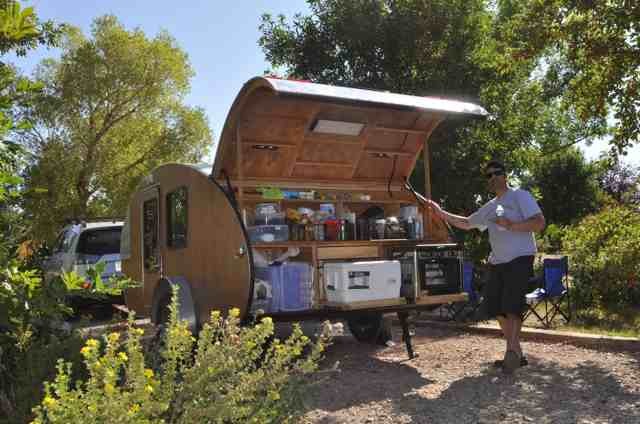

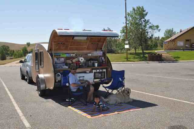

That's nice work - and, to use the technical term, I see you carry 'some stuff' in your galley!
The 12 volt heater is 40 amps, so I think that's intended for use with an engine running. Your typical 80 amp-hour leisure battery can run that heater for 30 minutes before it's half empty - which is about as far as you should empty a lead-acid battery that you want to use again. And the 480 watt output isn't much when most household electrical heaters are four to six times as much.

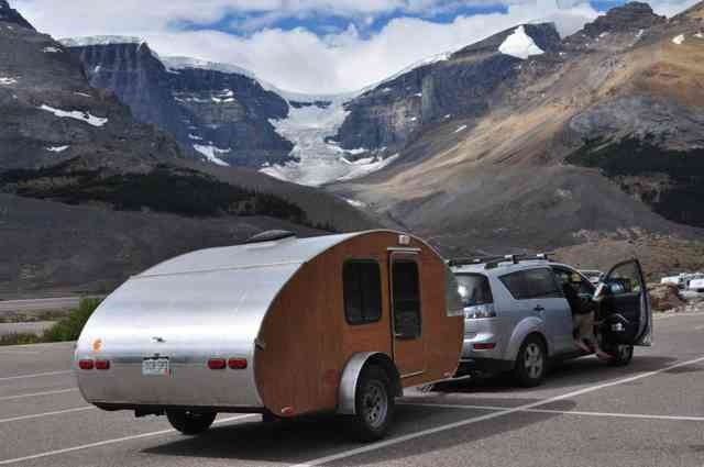

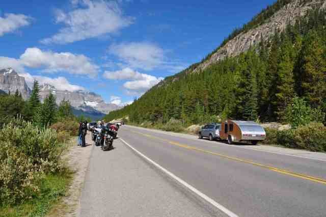

Love the pic of the snow capped ridge. Nice.

Andrew,
Thanks for the designs and the tip on the heater. Half of that stuff is baby related paraphernalia. I'm looking forward to getting some space back when he is big enough to use the single bunk/couch and is no longer on formula. That said we do tend to over pack a little and a bigger trailer means it's easier to get carried away.

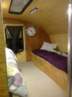

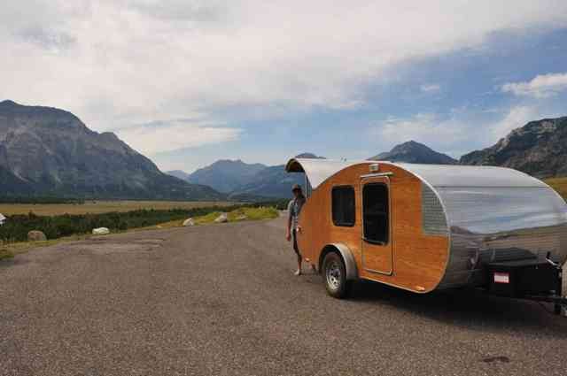

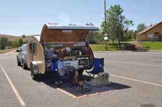

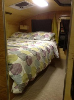

It is definitely nicer to camp in a teardrop. No more packing and unpacking. I particularly like not having to stuff sleeping bags back into their stuff sacks. We could have had a dinette in the bed area but put a restful nights sleep ahead of a diner booth and table. After seeing photos of a cabin car Layout this bed setup I decided to go this way, although I drew the line act the separate bathroom in the front and opted for a simple couch/bunk. In rest areas with no shade if we had space in the carpark I'd just point the car and trailer into the sun and lift the back hatch. This generally afforded us some decent shade while we had lunch (see photo of this attached below - the other is a bigger copy my favorite teardrop photo from our Canada trip). We barely used our flashlights or head lamps and there was no need. Porchlights and the galley light filled this need.
The other thing I loved about the teardrop on the trip was the insulated cabin. We had a couple of cold wet nights in Jasper and while we weren't warm and cosy without our blankets, we weren't freezing cold. Some of the folks in tent campers had there furnaces going. My only issue was the considerable condensation buildup around some of our windows and the skylight.
