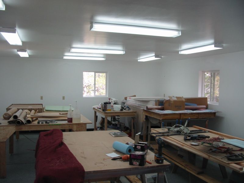

Postby RockyMountainTeardrops » Fri Aug 26, 2011 6:13 pm
Hello everybody,
Been a BUSY summer for me.
Shop is finished!!
Right in time to do a little work on the Justintime and then go camping for 2 weeks!

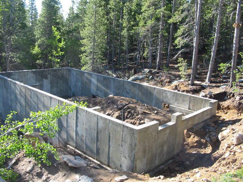

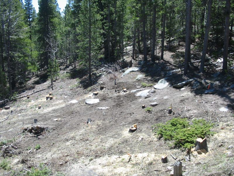

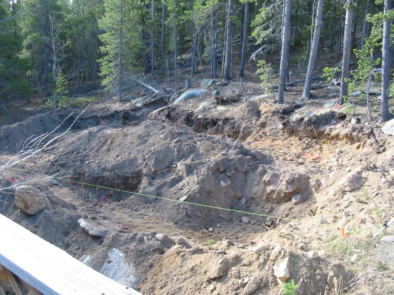

Land cleared, ready for the excavator.
All dug out.

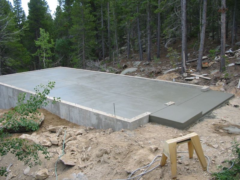

Foundation.
Floor.

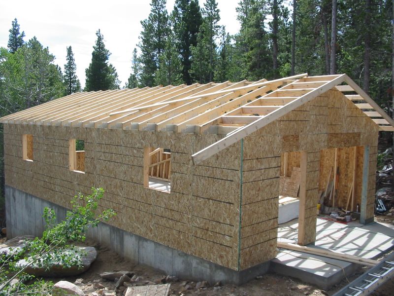

Framing.

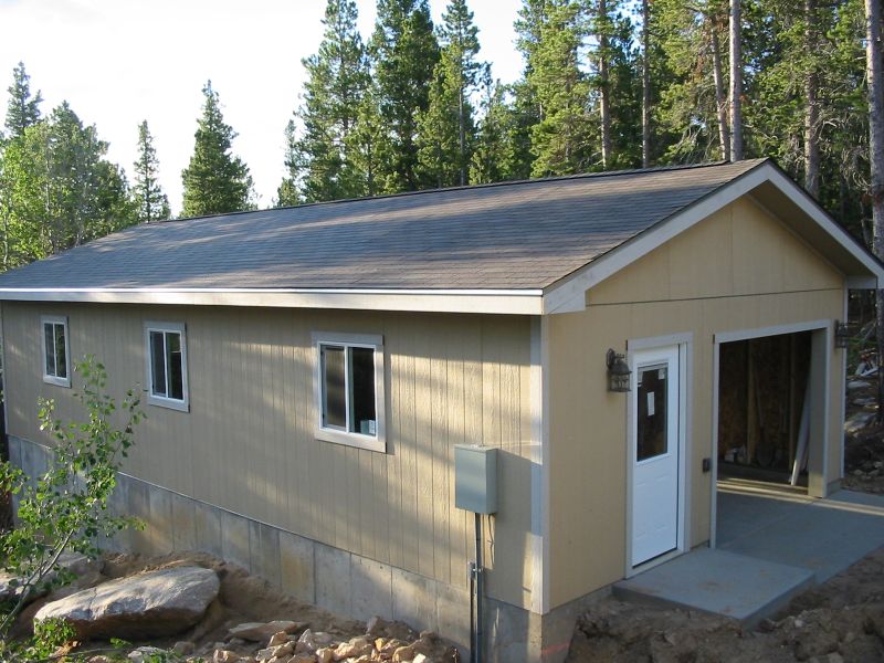

Siding, roofing, electrical, windows, and door.
Insulation and drywall.
Paint.

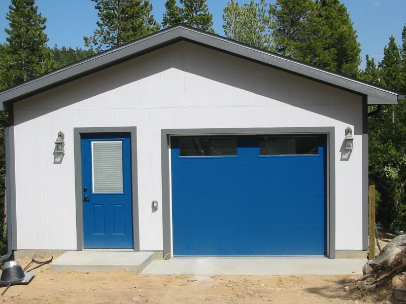

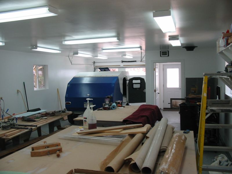

Front of the shop, looking back.
Back of the shop, looking forward. Small office on the right side.
Need to finish putting up a fence for the dogs, but going to order some resin when we get back from vacation and start building campers!!
Lee

Postby RockyMountainTeardrops » Sun Aug 28, 2011 7:43 am
Well....it should be gorgeous....as much as it cost! $>
(won't go into details, but it cost more than a year's salary..pre-tax)
The sad part is how fast it's filling up.
Doesn't take many tables, carts and molds to fill up 675 sf.
I'm following my plan of "everything on wheels". No counter-tops in this shop.
Rolling tool cart from HFT (on sale $99) will keep hand tools close by and organized.
Need to figure out how to get the molds under the big (5'x10') fab table. That will free up a good amount of space. Maybe something as simple as furniture dollies.

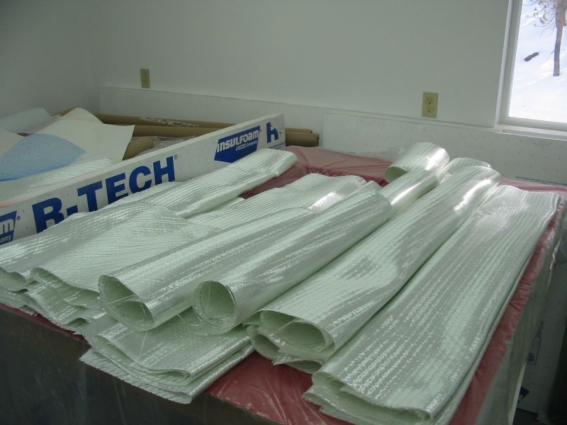

Finally ended up ordering out of Illinois, Florida, and Washington to get what I wanted at a decent price.
:delivery:

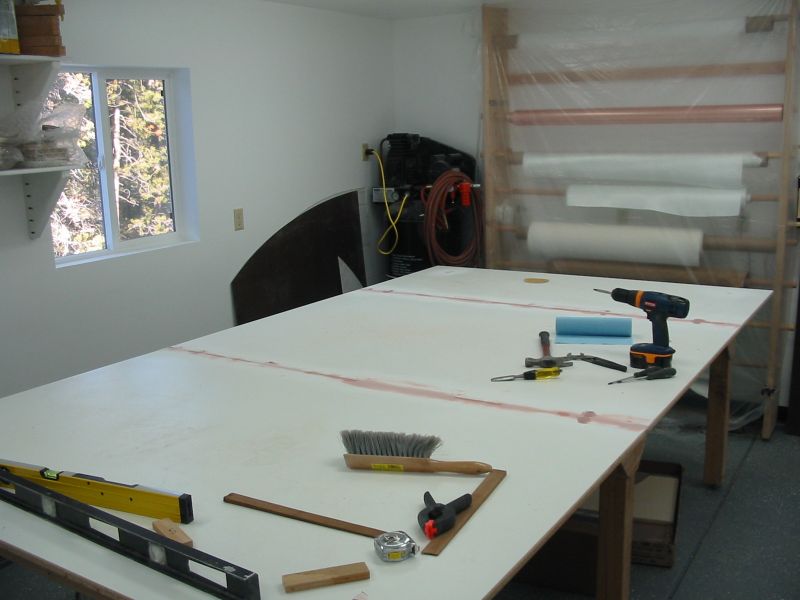

New work bench top. (3/4" melamine)
This caused problems that I will talk about later.

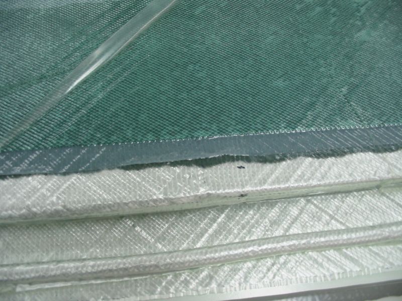

Cutting the fabric for the floor.

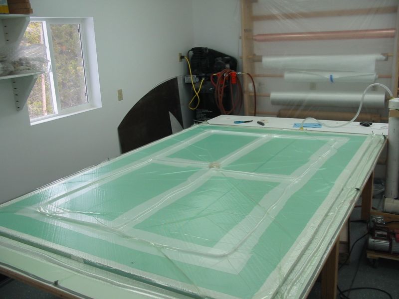

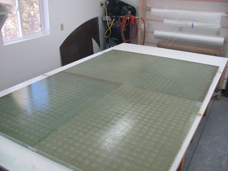

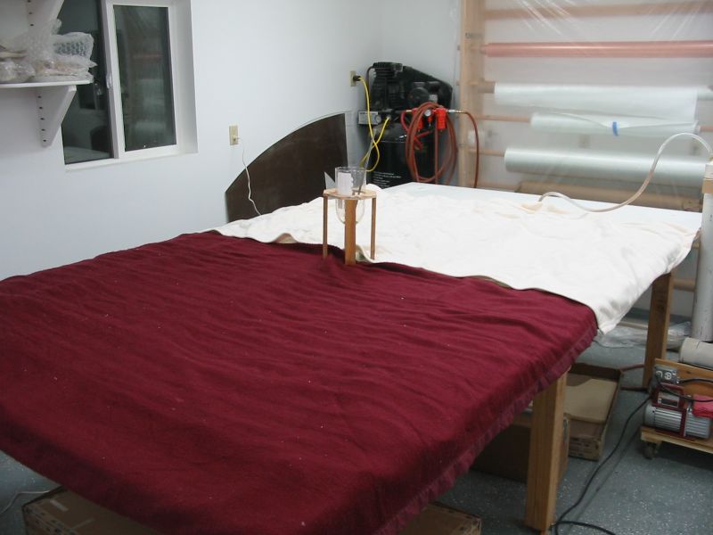

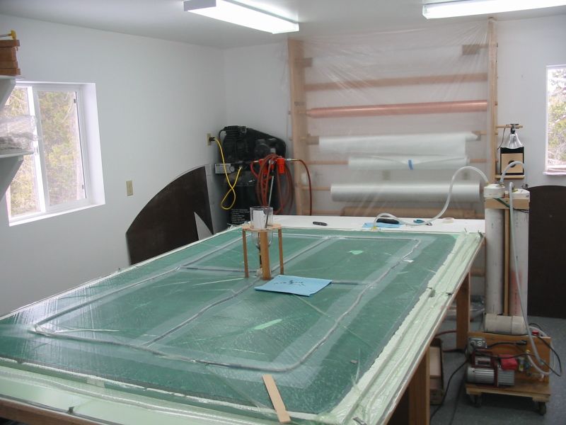

Floor panel under vacuum, ready to infuse the resin.

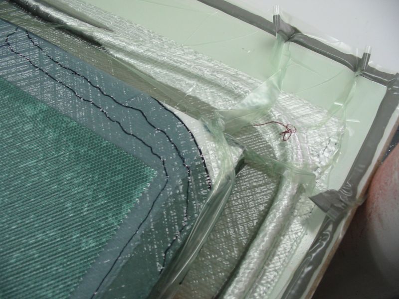

(Green color is flow medium, the while lines are the resin feed lines, covered in peel-ply)
Resin going in, 2-1/4 gallons so far, needed another 32oz to finish.
Getting close, another inch on the edges.
Last corner to get resin, I was starting to sweat, worrying that I was going to have a dry spot. (at tiny as it is)
No worries though, resin got there before it kicked off.
All covered with electric blankets, ready for bed.

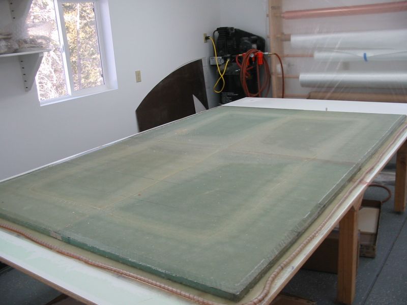

Next morning, bag, flow medium, and peel-ply all stripped.
Funny the patterns that are left in the surface. Areas where just a little bit of extra resin is left.
Bottom of the panel (dark lines are tiny grooves cut into the core to help the resin to flow throughout the panel)
Finished floor panel! Cool!
Now to start on the walls!
The floor is calculated to weigh approx 60 lbs (64"X96")
That compares favorably with plywood. (3/4" marine should be about 100 lbs).
This panel was another learning experience for me. The panel came out perfect...it was the table that was the problem!
Went out this morning to unbag the part, and I noticed that the entire table was rocking. I have adjustable feet on it, and I had spent a few hours leveling and making sure everything was flat and true before starting the floor panel.
I thought everything was fine, but to find the table rocking almost a 1/4" was unexpected. (rocking on the center set of the six legs)
I can only guess that it was caused by the resin kicking off on the top first, and shrinking a tiny bit before the bottom kicked.
The floor panel ended up with a little arch in it.
Thankfully that is not a big deal (I'll just put the curve upwards, it will help with the loading/deflection).

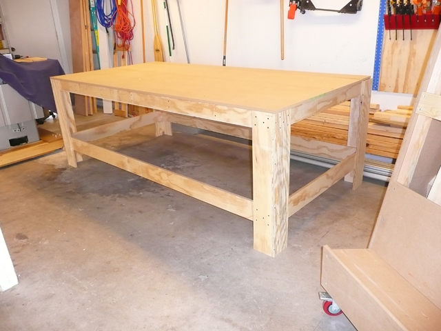

So to make sure this doesn't happen again, I'm going to have to build a better table.
Months ago I did some research on work-benches, and it led me to a "box-beam" type design on this website. Box beam table
So next up is a trip to the lumber yard to figure out how much $$$ it's going to cost to get some TJI's to build another table.
Two steps forward, one step back.:BE

You are doing some very good work. You don't need a better table. If you brace the legs by forming X's between the legs you will have it perfect. Cross bracing will more than double your rigidity of the table.

As far as your layout table, two thoughts come to mind. First, is the melamine on both sides of the sheet goods? If not a single ply can cause an imbalance. Second, you really don't need truss joists to build a flat table. If you build a stress skin or torsion box and then install the melamine on top of it, you'll have nice flat surface.
Before starting my teardrop, I built a torsion box style assembly table. My table has a 5' x 10' work surface. The torsion box is 4' x 8' and is made out of cheap 3/4" ply, 6'' deep. The box is skinned top and bottom with 1/4" ply. This is a picture of it before adding the top. (There is a piece of 3/4" MDF sitting on it that was not installed.)
The top is 5' x 10', 3/4" ply. I added a 2" wide strip of 3/4" ply on the bottom of the top around the edges.
Even with an 8' span between the legs, there is no deflection unless there is a really heavy - 300# + - load on the center.
