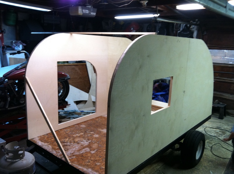

Are the walls skinned on the opposite side of one and other?

Jpageau wrote:Curious why the walls are skinned already. Don't you runs spurs / wire first ? Sorry- I'm a newbie .... :)
Not gonna have any wires in the sidewalls, except a couple close to the edges for a couple running lights. Those couple will be close enough to the edge and I can just poke through the wall with a special electrical drill bit I have. 99% of all the wires will be running overhead though the spars. The spars are just gonna butt up against the walls and get glued and screwed. Only skinning both of the side walls. The front, rear and roof sections will be skinned inside only until all of the wiring, etc is done.

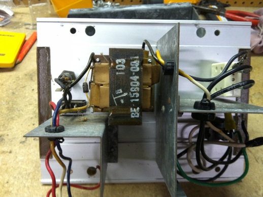

So the 12v power supply works, however it is very basic. It's basically a 12v transformer with diodes for backfeed prevention.
I'm thinking a couple of options here.
  • Leave it as is, as it does work and the transformer windings are good, etc.
  • Add a rectifier circuit, bridge it, add necessary caps etc and install toroids for RF to this power supply
  • Build a new one from scratch with Toroidial Transformer (I have all the parts excluding the transformer)
  • Buy a power supply center
The cheap guy in me says leave it alone, the lazy guy in me says buy a new power center and the electrical engineer in me says build a competely new one as I would enjoy building it or update the current one. Gonna sleep on this one a few days before I decide.

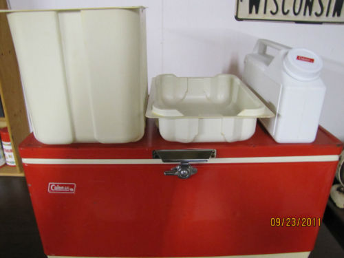

Not much going on the past few days in build world. Waiting on parts and such to come in. The biggest setback was finding the cooler I wanted for the galley. I wanted the 70's coleman metal thats 6 inches longer than the normal size and with a good shell. Finally won it on eBay a couple days ago and should get it in this week. All of the galley dimensions are based around this cooler and want to maximize use of space so waiting til it got here to start framing out the galley.
I did decide to repurpose the old power supply, using it for Electrolysis of old metals. I'm going to go with purchasing a new power supply. I got the water tank installed in position. Other than that it's been alot of standing back, looking at it, measuring and deciding how I wanted things in the galley. I've been getting a whole lot of "Will you quit staring at it and do something!" lol. Spent a TON of time in this album http://s134.photobucket.com/albums/q120/ams-texas/Galley%20Gallery/ getting ideas and such. I have the "have-to's" worked out and will see how much room I have for the "want-to's" when a few things come in this week that I ordered.

I am big on adaptive reuse but Compass Rose came with a Progressive Dynamics power center so I did not face the question of trying to adapt something. I am however mindful of the care and feeding of deep cycle batteries and there are some over voltage and reverse voltage protections built in the PD devises.

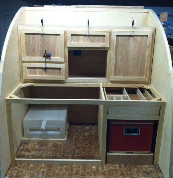

More progress on the galley, Spent alot of time setting up my work area in preperation for winter, since I will no longer have access to outside sawing etc. Got a dust collection system going and trying to clear out a few things to make more room.
I got the cooler slide and utensil drawer built and the upper cabinets finished. Temp hung the doors on clamps to see what it's gonna look like. Taking a little longer than I expected, as it's my first time doing cabinet construction. So glad I really like the shaker style cabinetry as I can;t imagine trying to do more detailed cabinet construction my first time. Also first time I've used my dado even though I've had it for many years, lol. I see alot more woodworking tools in my future as I am really enjoying this work.
Next will be the stove/grill slide out on the left side.
