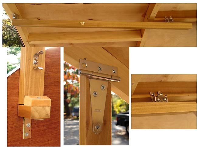

Since each build has its own interesting details, I especially like your hatch
handle/lock and the hatch supports with the stow clips. But I was curious if
they are" secured" when in the opened position, so the hatch can't get
blown further upwards by a wind gust, since that is what prompted you to
change to the new 'secured for travel' supports. I really couldn't tell by
the pic.
Thanks Norm.
It may not have been the wind that got me. I suspect it just the downward weight of the hatch causing the dowel bottom to start slipping on the slippery vinyl tiles, that threw the bottom of the dowel to plunge into the back of the wall.
To answer your question, I currently have no locking mechanism that prevents the hatch from lifting up. It would have to be a pretty strong wind to lift it enough that the hold-open struts would clear the block of wood that keeps them from collapsing towards the centerline of the trailer.
If this does turn out to be a problem I can always add a hook and eye latch or something else to hold the bottom of the strut on the little shelf it sits on when open.
Thanks again

Postby canned o minimum » Fri Nov 11, 2011 7:23 pm
Either a taller block or simply drill ahole on a downward angle and put a nail in it to hold it .. slips in and out easily.. cheap insurance.

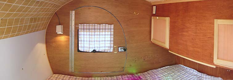

A panorama of the interior, now with carpet padding and carpeting. We found the uninsulated floor was too cold in cold weather. This helps a lot.

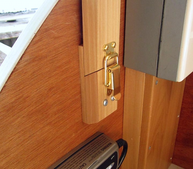

jonw wrote:I needed something to hold the hatch open and I was not enthralled with using gas struts, nor had I seen anything on the forum that I liked. I had been using a dowel with chair leg bumpers on both ends but the wind blew the hatch and the dowel collapsed and nearly went through the bedroom wall. So I designed this simple system that works great:

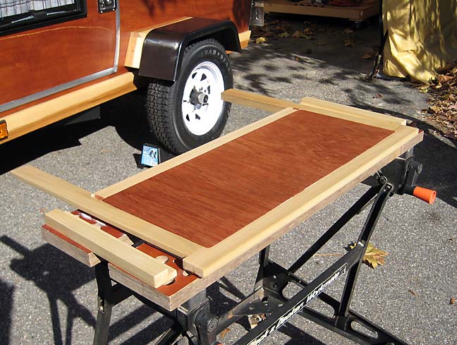

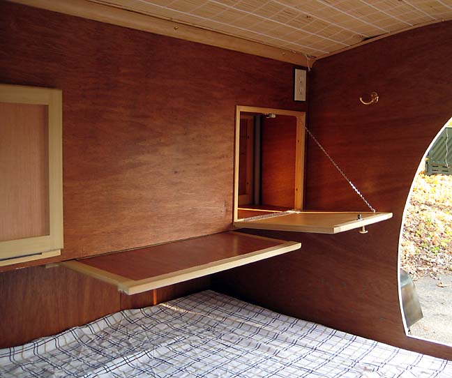

I got ideas for pull-down cabinet doors and a pull-out shelf from some other teardrops at that weekend. Here's what I did:
And here's a panorama shot of the finished interior

lfrazer98 wrote:Loved reading this in its entirety! How did you attach the slide out shelf under your interior cabinets? Did you use "C" channel aluminum? I like the idea and may add one under my interior cabinets! I also really like your "struts" and think I will be making my own as well. Thanks for your help!
Hi Lauren -
The slide out shelf mechanism is all wood and low-tech friction fit. I cut a rabbet on the top of the pieces that screw underneath the cabinets and a rabbet on the bottom of the side frames of shelf. This picture shows them:
Re: the hatch "struts" I strongly suggest doing them as I modified them in my refurb journal after losing the hatch because they were not secured when open, and blew over backwards in a strong wind springing the hurricane hinge. Everything is the same except for the shelf on which the bottom of the strut rests when open. It now is secured with trunk latches (readily available at any hardware store) and looks like this:
Hope this helps!
