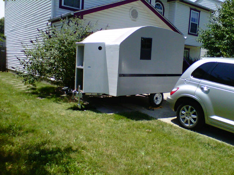

Hello Gang,

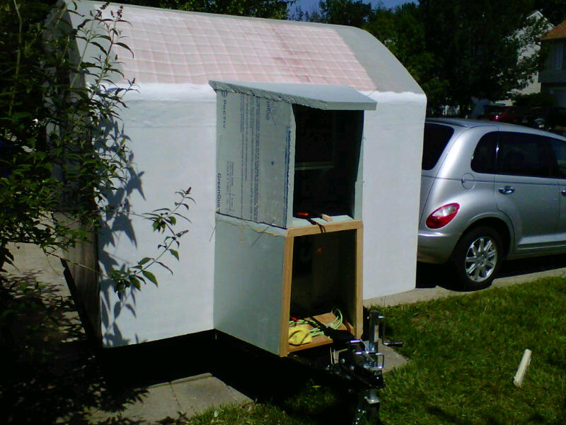

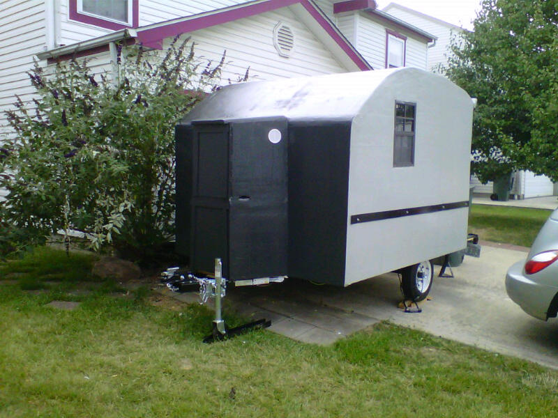

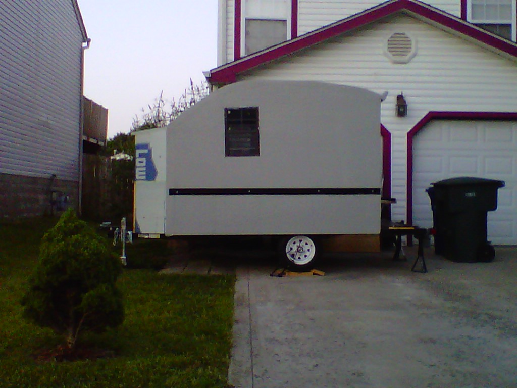

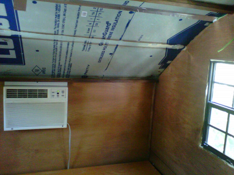

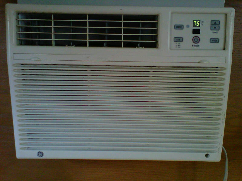

I am feeling better about my workmanship now. I am learning to take more time with the foam especially. I decided that the AC cover had to be replaced. So off with the old. I'm going to try to salvage at least part of it. Maybe make a step?
So I built it like this. I will put a door on the front at some point.

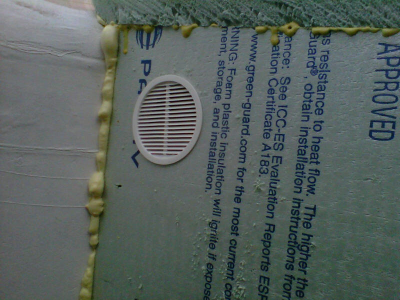

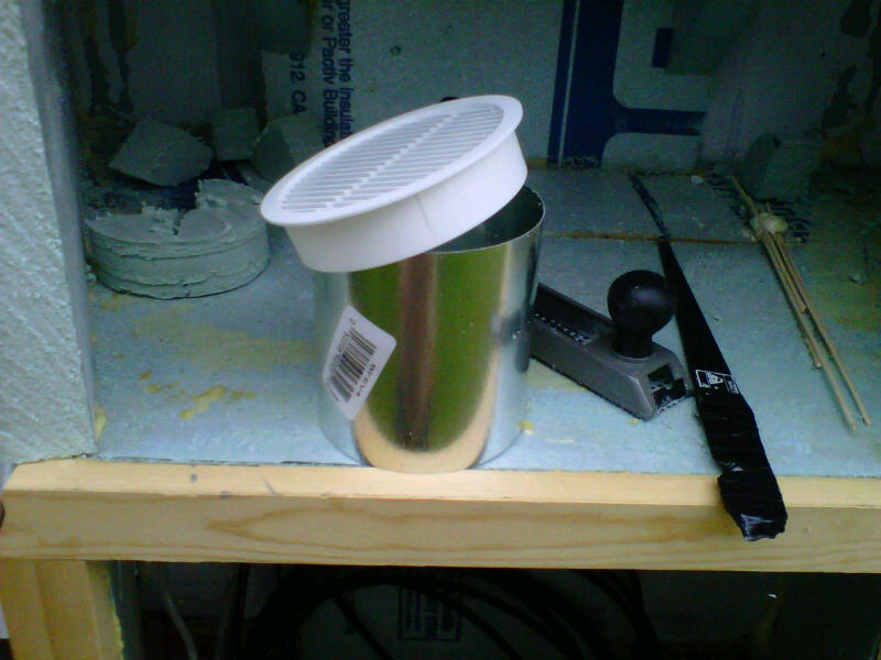

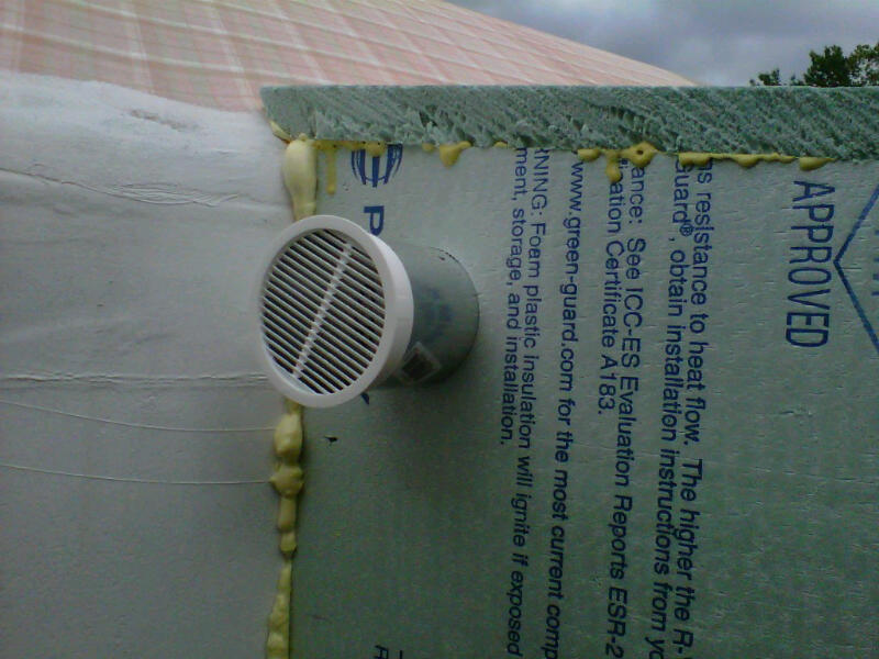

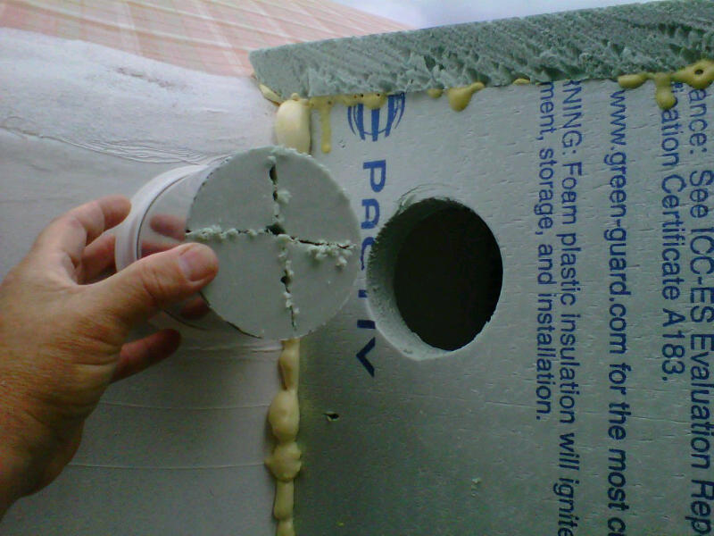

Also installed a couple of vents on the side to help it breath. As you can tell in the pics. I used the vent for a "cookie cutter" to make installation easier.

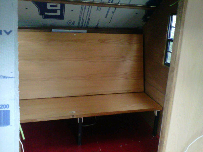

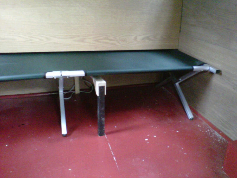

I also stared on the bed/couch futon[?] thing. This is still in design and planning. My wife came out and sat on it with me. She said she wouldn't put a back on it. She would just make it slide out to make a longer platform and just lean against some pillows. Any way, I bought these doors off of Craigslist for a good price for the purpose of making this platform. They are light and strong. they held my 190+ pounds and her[???].I was going to maybe put a hinge and make it fold, now I'm not sure.

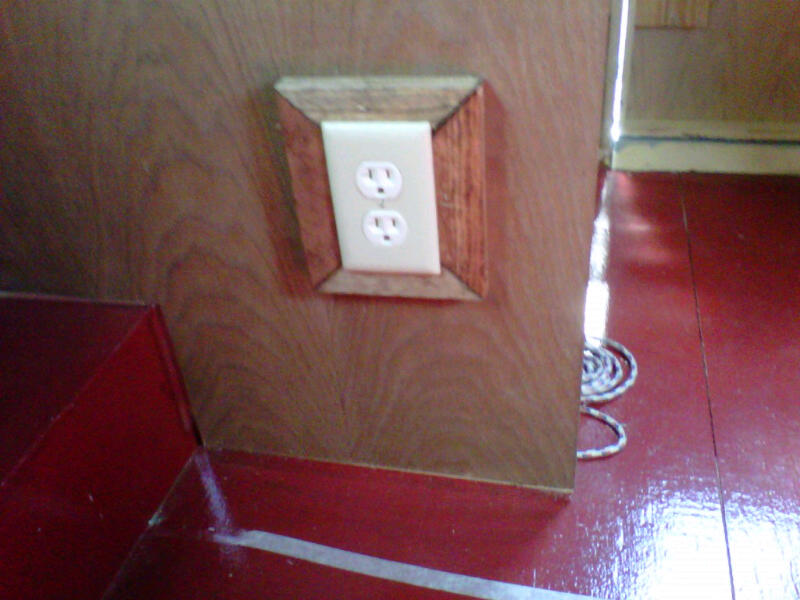

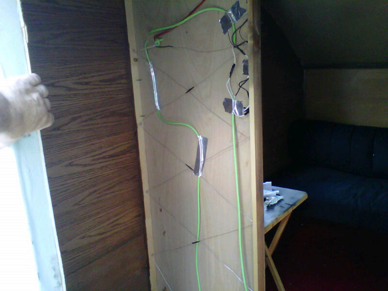

And finally, I got the ac wireing finished. The AC unit works very well. [another Craigslist bargain] I'd like to say thank you to Zach for the idea on the outlet frame buildup. [I think it was Zachs idea anyway]

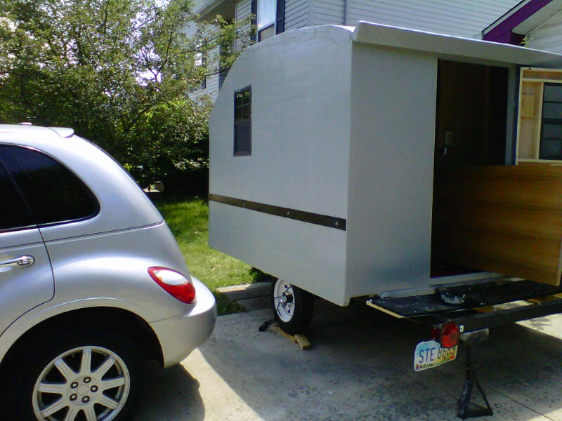

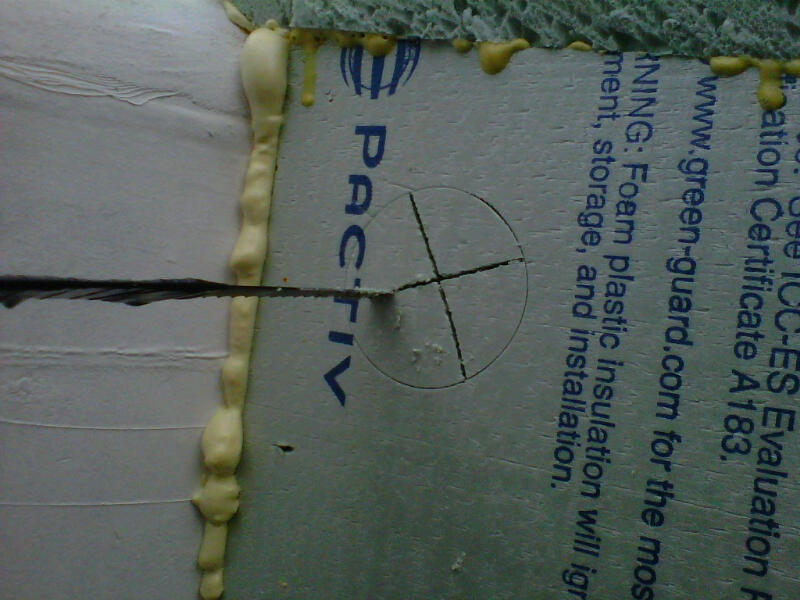

Now, I have a confession to make :oops: . My foam on the drivers side of the body did not bond well with the interior luan. I was able to grab the foam at the bottom of the side and pull if away from the body with ease. I decided to drill 4 holes and install 1/4 inch carriage bolts and secure the foam in this manner. I cut a trim piece for each side to run the bolts through. I think it will be fine. I will put some added adhesive through the bolt holes for added security. I put a strip on both sides.
I like the black stripe. Thank you for checking in on me.

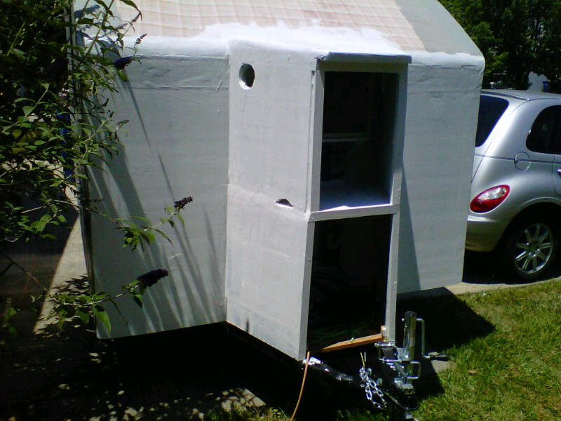

Postby crumbruiser » Sun Jun 10, 2012 4:24 pm
Howdy Folks,
Here is the updates for the week.

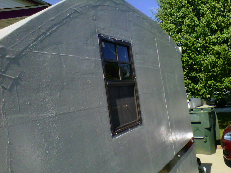

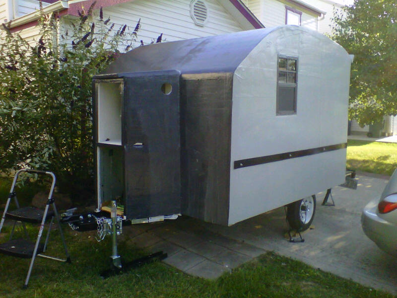

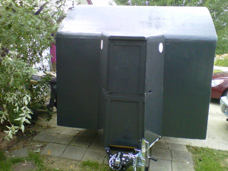

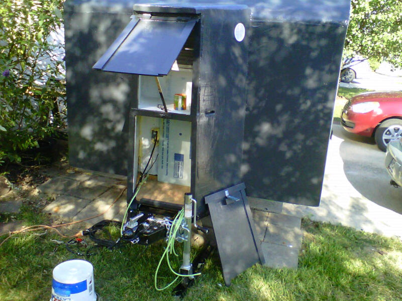

I got the AC/battery box primed and skinned. I used newspapers for the skin, I thought it would be easier. That is not correct. The newspaper will not slide and ends up tearing. I will not do a build involving skinning again. I like doing woodworking but I do not like doing skins. Anyway. Here it is. It looks good from a distance.
Here is what the skin looks like on the side. It will have to do. Maybe after about 20 coats of paint it will be nice and smooth. ;) :crazy: Probably not but thats OK.
Here it is from a distance. A camo paint job would cover up some of the mistakes. :thinking:
So, While I was working on the inside, the AC was blowing nice and cool, I hear a "pop"! 1 of the spars popped loose from the foam. These are brad nailed through the wall from the outside and GG glued or foamed to the foam but this one popped off???? Maybe it was already curved, maybe the cool air on the 1 side and the other side against the hot foam caused it warp. I don't know but I will more than likely be drilling holes in the walls and screwing them on from the outside. I don't think they really support anything, but I like the idea of having them there.

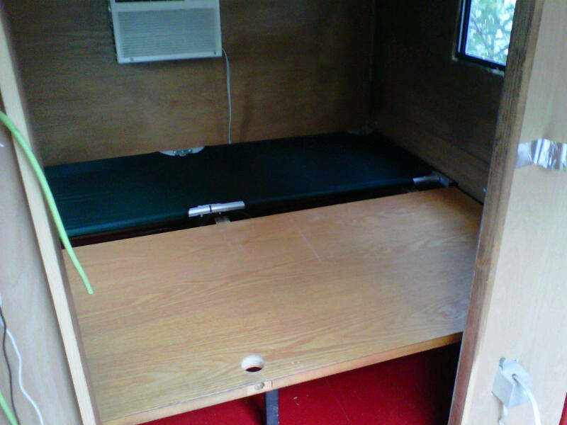

Anyway, my wife suprised me with a camp cot she found at a thrift store, so the bed/couch design may end up changing.
Here is 1 option. This will need some more designing.

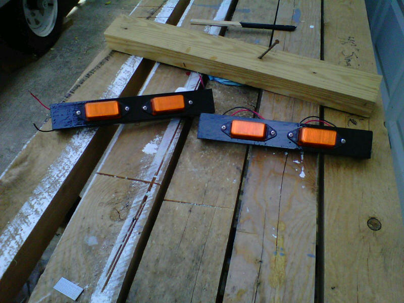

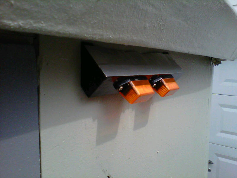

I moved to the back and built the porch lights. The light units are LED's bought off of Ebay. They are clearence lights but I thought they would do the job.
I covered the wireing up with heavy duty aluminum tape.

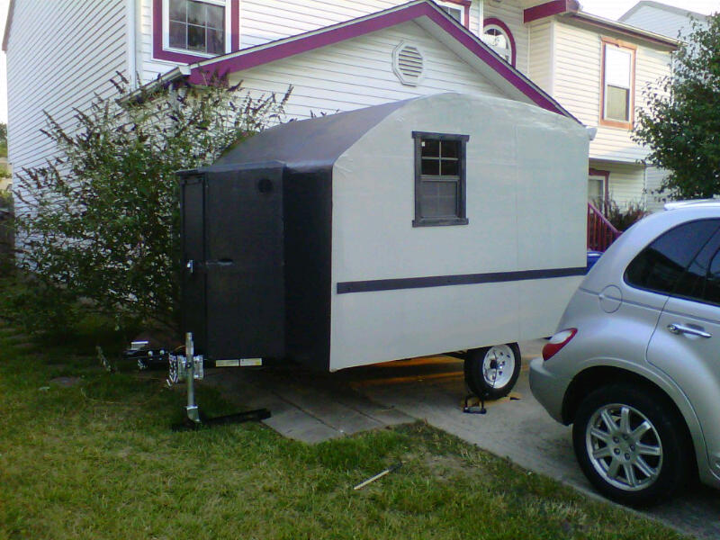

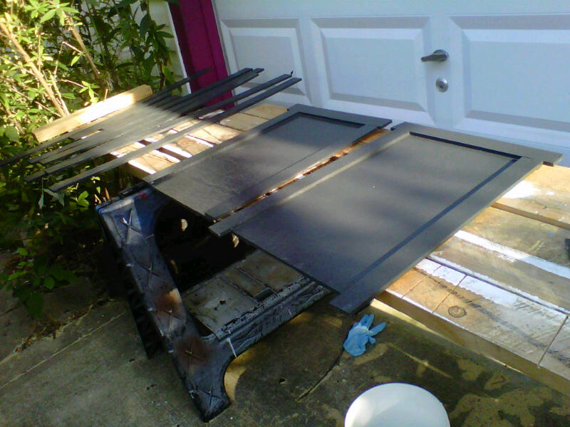

I also made the doors for the AC and battery boxes as well as the trim for the windows as seen in the background.
Together they look like this. This is also with the second coat of paint. The doors are'nt attached yet, I was going to do that today but we are getting some much needed rain. Maybe I'll get to them tomorrow.
My wife says she likes it like this. I do not mind the look, I figure it's waterproof and maybe next year I'll buy enough paint to redo it in a silver color to match the PT Cruiser [TV].

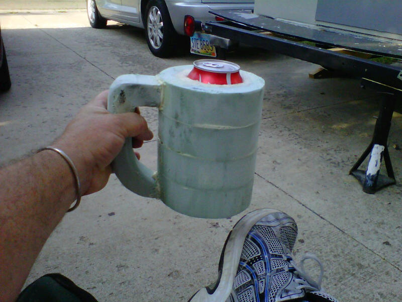

While reading in the Foamy section, they started a "What to do with left over foam" thread. For several years, I have been wanting a cup cozie or cup holder that would keep my soda pop cold. This is my addition to the thread. It is'nt finished yet, but it does work good!
Thank you for the comments, and thank you other people for looking.

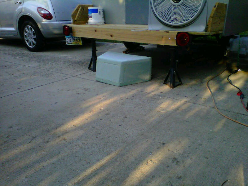

Any way, I made some good progress in the build. Here are the doors mounted. The top door that protects the AC hinges from the top. I use a rod to prop it open so it can breath. The AC works very well with this setup. The battery compartment door has a lock hasp on top, to prevent theft, the door has no hinges instead, you pull the top out a ways and lift it off. I figure it's easier to work inside that way.

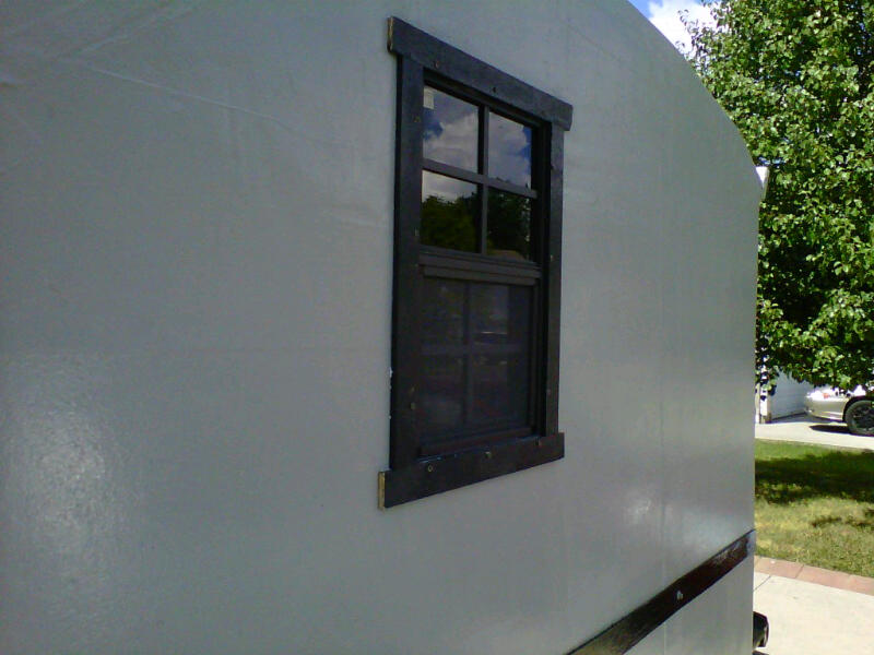

I trimmed out the windows.

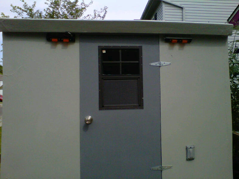

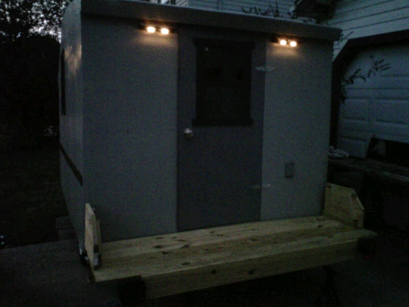

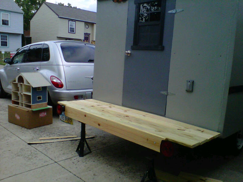

Built the back porch.
I put the little side on it in case I end up hauling firewood on it. I figure it will stay put better that way. I plan to install some tie down rings at some point.

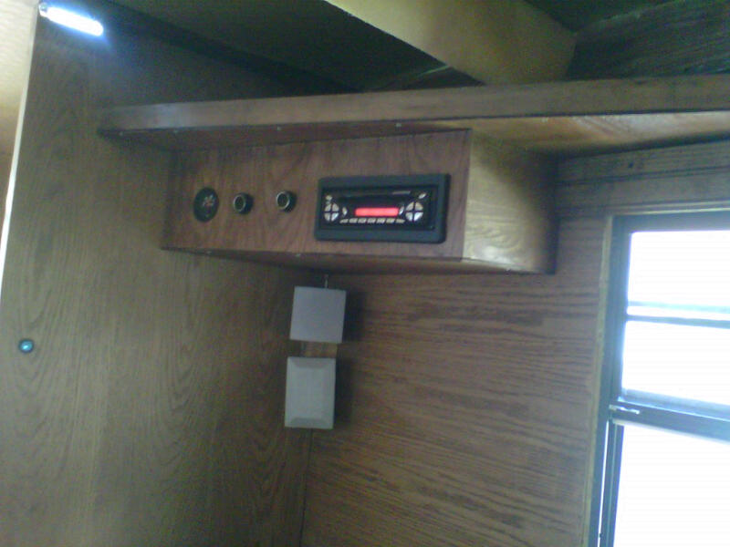

This is a mock up of the radio cabinet. It is on the drivers side as the camper is being towed. There is a 4ft long shelf, triangular shaped above it.

The back porch lights are wired up and working and I've been toying around with the interior lights but haven't commited to any thing as of yet.

Porch lights.

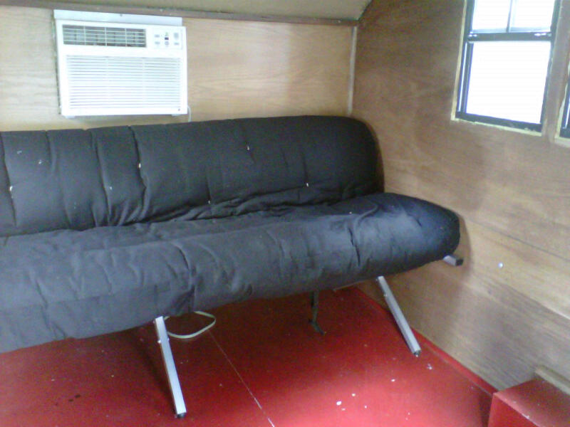

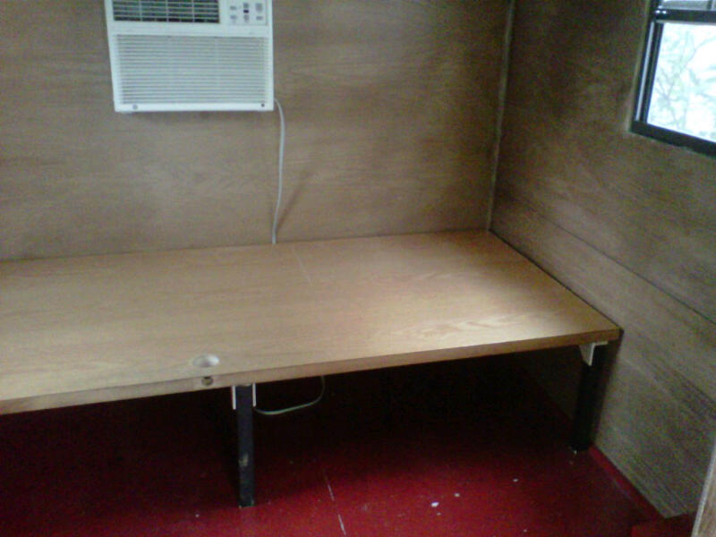

Futon mattress on top of a cot.

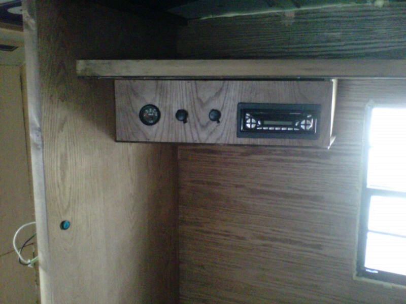

Radio cabinet is done.
Home made antenna for the radio, [the zig zag wire] along with some 12v wiring.

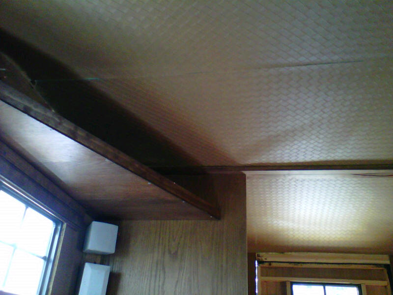

A shot of the headliner along with a shelf.

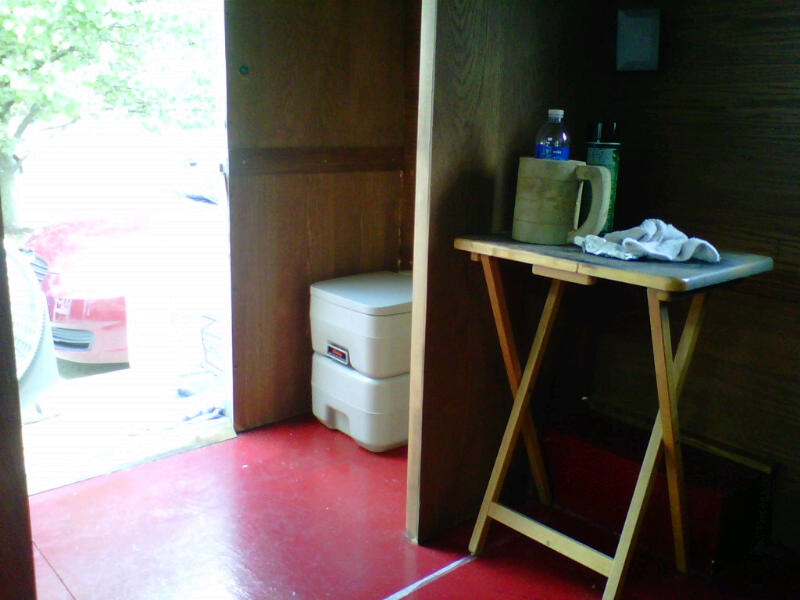

The restroom.

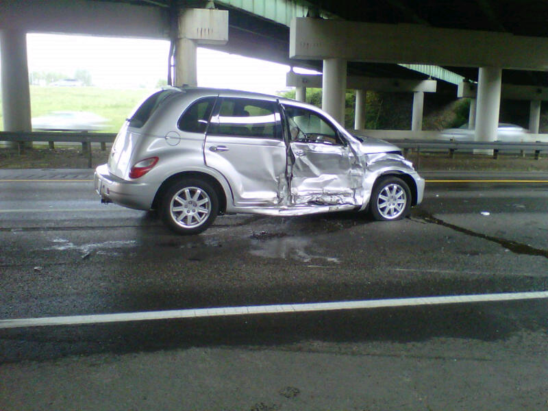

I've been off the build for a while but, I'm back. August 11th I totaled my PT Cruiser. Thank you GOD for keeping every one involved safe.

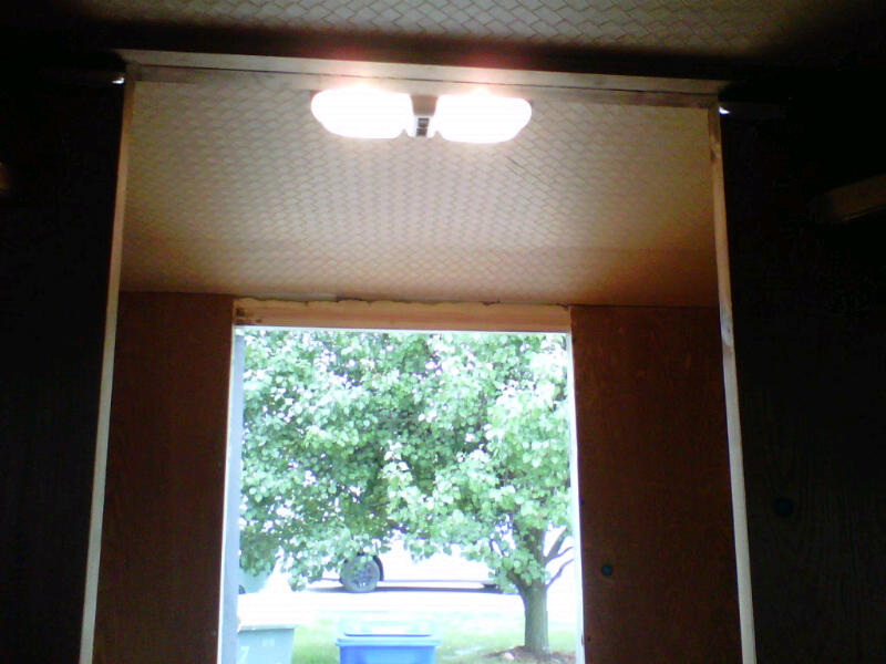

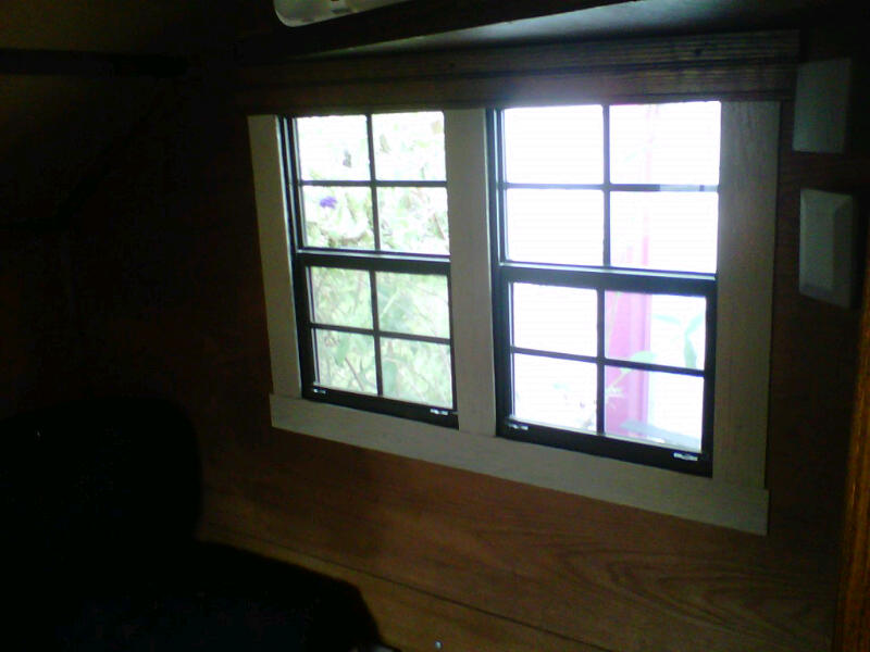

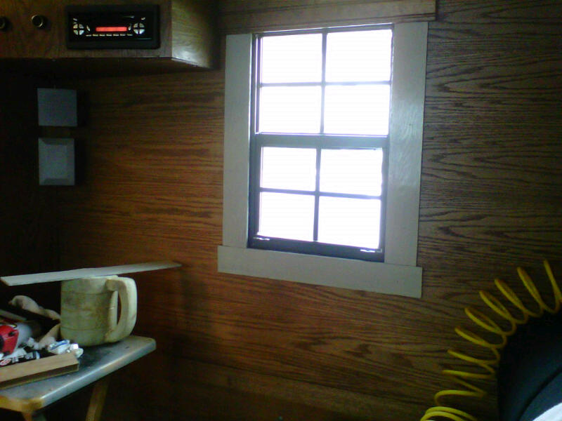

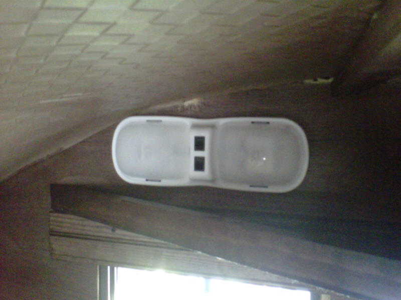

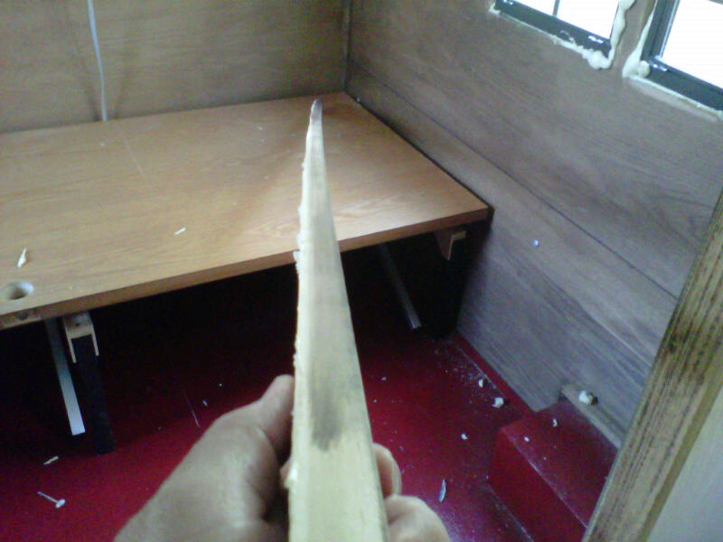

Hi Everyone! The build continues a bit. I got the interior window trim painted and installed.
I bought and installed some new lights off of E Bay. The map lights I bought just weren't bright enough for the space they needed to light. These RV type of lights do a very nice job.

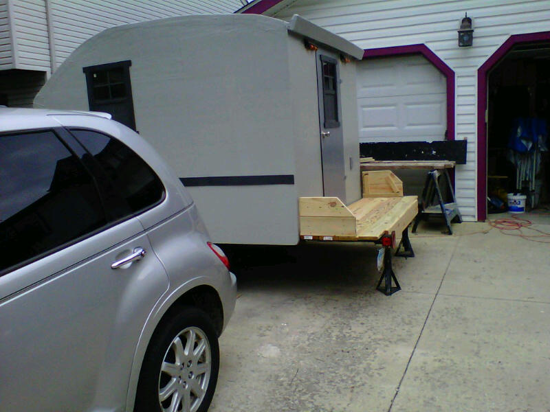

I can't remember if I posted the foamy step I built so here it is.
