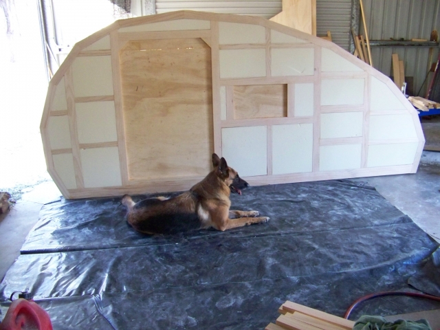

I think I have this worked out at last, it's been hard to see 'cos of eye infections but that's another story.
I'm hoping I can get all the construction sorted out now.

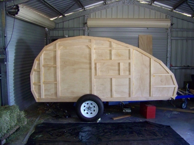

This of course shows the framework nearly finished. The open panel at the end (not the door) was left without the frame pieces glued in as it had developed a huge buckle. I stood the wall upright and allowed the timber to dry out as it felt damp from the humidity. The next day, the entire skin was super tight and no more buckles. The last of the frame pieces were glued in and now begins the inlaying of the foam. I can keep the floor clean, it's really super clean, by blowing it down with the air hose from the air compressor. This works wonders and I can work on the floor knowing the wall be as flat and true as possible. The horse will be leaving us soon which will also mean no more leucerne in the garage. :thumbsup:

The red hose is the air hose from my air compressor. It's being used to keep all the timber, parts and floor clean of sawdust and dirt. It works better than a broom or vacuum cleaner.

The side of the frame is now ready to fit and glue the final plywood skin. The urethane foam was fitted and glued in place then it was sanded with the orbital sander to about 1mm above the frame. The final sanding was done using a piece of the framing that had the sandpaper stuck to it with double sided sticky tape. The plywood skin will be applied in 3 pieces, one at the top, the main lower sheet and then the end on the right. I had lots of help from my little mate who watched very closely as she checked the progress being made. She is a precision fanatic, everything must be perfect for her. I will be gluing the skin on with epoxy as I can't buy urea formaldehyde in Australia in containers smaller than 20 liters. I can buy a 2 liter container from the US but it will cost about $32.00 plus $58.00 for shipping. Shipping is by boat. I'm happy to use the epoxy, I can buy it off the shelf in Rockhampton, 40 minutes away. It was surprising how fast the sanding was to remove the 1/4" required. The sander had to be kept moving all the time or an "Oops" happened. You might be able to see the 2 "oops" in the photo. These won't cause any problems as I am not using a vacuum to suck the ply down. The ply will be fastened with staples and then they will be pulled out. The holes and dents will then be given the water droplet and hot iron treatment to bring the ply back to its original condition.
