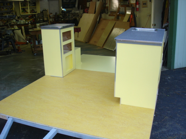

Postby doug hodder » Tue Nov 27, 2012 10:50 am
Dan...the step has 4 bolts welded to the angle iron outriggers. I have taken it off right now, in fact, soon, the entire axle and suspension will be removed and the whole thing put on casters so that I can move it in and out of the garage. I'm going to leave it in until I get 1 wall at least made and positioned so I can check it out. Once the walls go up, it won't fit as is. KC...the only lost space is under the galley cabinet because of the toe kick. There will be tons of storage in this trailer so I'm not too worried about that spot. Besides, it's a ton of work to build it out so that it is usable with a cooler on a slider fit in. Doug

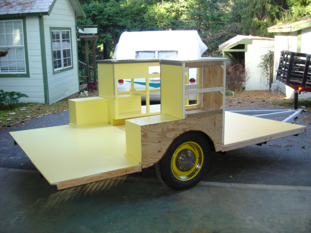

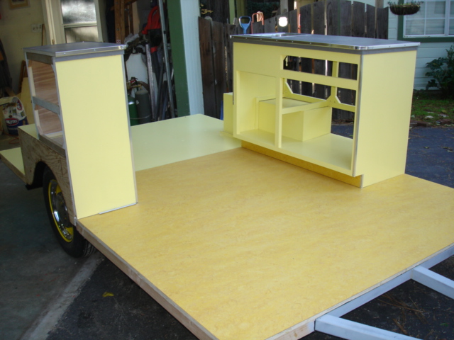

Postby doug hodder » Sun Dec 09, 2012 7:26 pm
I was unable to do any work on the trailer last weekend due to a major storm....too much stuff dropping from trees to pull the Nomad out and I was out of power. It was a Coleman weekend....had 4 going in the shop as I tried to work,...but needed the table saw.
I mounted the tires and balanced them...thanks to my nephews equipment...so I saved some dough there, counter tops are laminated and edge trimmed, galley and cabinets primed/painted, trimmed in aluminum, and cut the flooring and installed it . I also got the necessary supports in for the drawer slides and finished up the magazine rack/compartment under the little cabinet with the 2 drawers. It's not quite done yet...gets some contrasting strips across the bottom and I'm waiting for the aluminum cove material for around the floor and the back splash on the counter. The color on the flooring doesn't show all that well, but Marmoleum is some awesome stuff, It's really thick material so cuts and scrapes from rocks brought in on your shoes don't tear it up like a vinyl might. Thanks to a fellow forum member for saving me some dough on that one! It definitely has the vintage look to it. I also tore into the front window to do some repair work on the crank out....it doesn't want to come apart.
