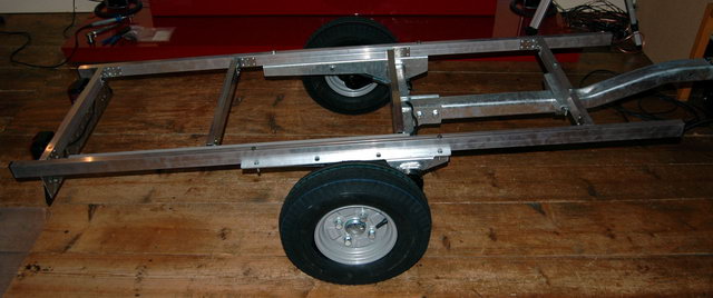

Okay - reaching the first milestone !
My chassis arrived today and I assembled it in my living room !
Weight is 44 kg (97 lb).
Now time to go to bed. I've a bad cold !
Good night - Tom

Postby KCStudly » Wed Feb 06, 2013 6:44 pm
Looks great! :thumbsup:
Hope you start feeling better soon. :worship:

Re: Stainless Steel Micro-Airstream behind motorcycle
Postby RandyG » Thu Feb 07, 2013 12:45 am
That's a nice frame there! So small but it will def fit your needs.

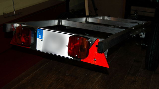

Postby ST1100 » Sat Feb 09, 2013 5:54 pm
All right !
Completed today the next steps.
Made a frame like a ladder from aluminum bars riveted together with stainless angles. 60 cm x 200 cm (2 x 6.6 ft)
Then made a light bar for license plate, reflectors and rear lights including indicators.
And fixed and soldered a cable from the light bar to the tow ball - only the plug to the bike is missing.
So next week I could get my deck and screw it on my ladder.
50 years camper and 35 years biker !

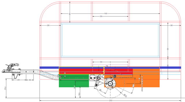

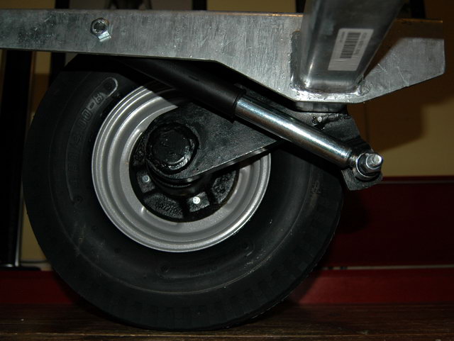

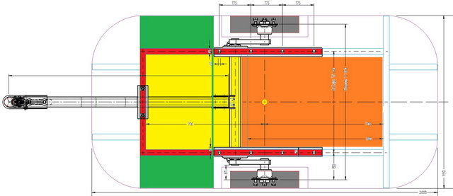

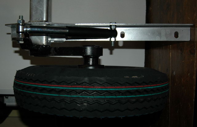

Postby ST1100 » Sun Feb 10, 2013 7:42 am
Thanks Chas for the corrosion hint - I do not drive through the winter with that trailer.
Finished my electric setup - all systems working !
But thinking about the fender problem and plenty of space below the chassis (10 inches from the tongue to the ground, 15 inches from the deck to the ground)
brings me a new idea. As you see at the picture there are only 90 mm (3 1/2 inches) from the axles base to the top of the tires.
Possibly its worth to think about a solid aluminum frame upon the base to lift the floor over the wheels and get 100 cm width without wheelhouses inside the "living room".
The red frame lifts the blue bars above the wheel level. On top of the blue bars lays the deck.
The yellow frame could be a intern baggage compartment between the blue bars for cloth.
The green box a 100 cm wide extern baggage compartment for heavy things like chairs, tools, water etc.
And the orange box a space to step in, possibly with a floor which can be lowered to the ground, and covered by night.
So I can sit on the yellow baggage compartment with the feet on the ground.
And if it's wet outside I can leave my boots inside the step box outside my sleeping room.

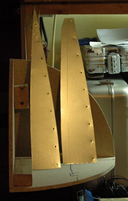

Regarding Airstream Roof Corners
Today I made a mock-up representing the frame of one roof corner and cut one "fish" stencil out of a 0.5 mm zinced tin sheet.
Then a second stencil from the first, adding 20 mm overlap on the left and cutting the tip, so that everywhere only one sheet will lie on top of each other.
With this two stencils I can draw five "underlap fish" and the sixth small fish adding a quarter circle to the tip to cover the gap where the other tips are missing.
