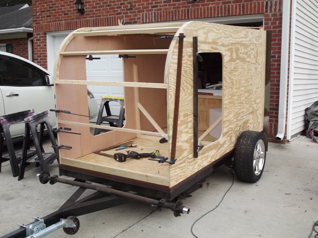

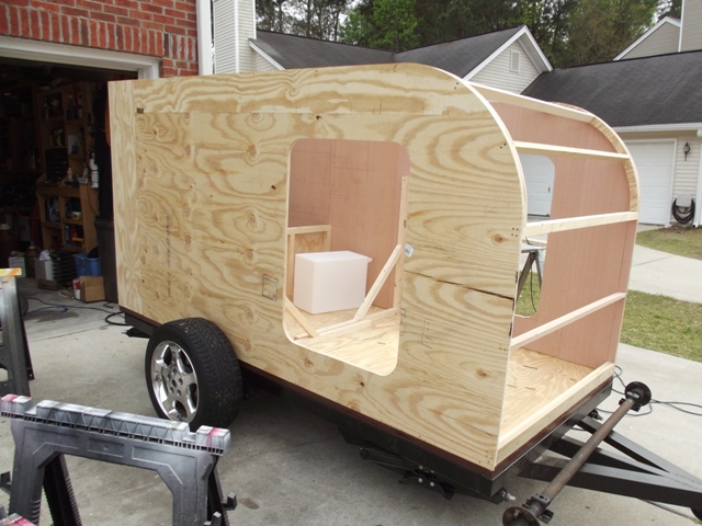

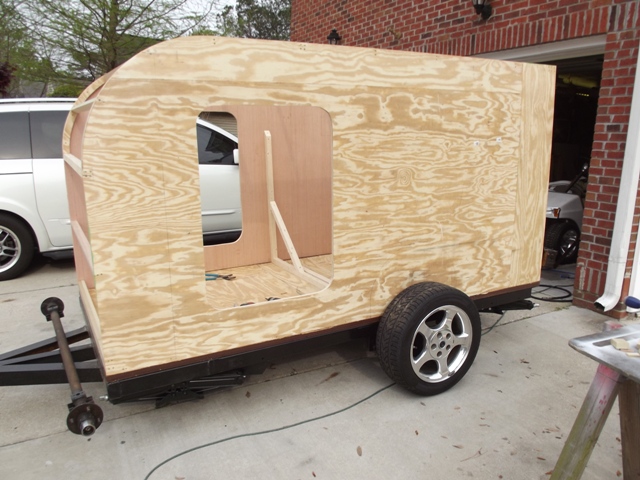

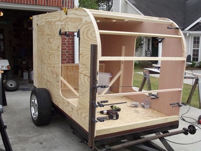

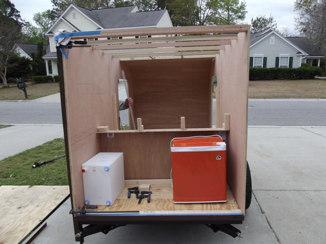

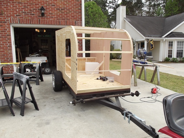

OK... So I had some good weather this afternoon and took the liberty of working on the Palmetto Bug! For 3 hours of work, I made more progress today (physically) than at any other point in this build. Here are a few pix of the walls stood up and the ribs installed. My plywood warped pretty bad last week following 5 days of rain, I had them standing up inthe garage and they warped real bad. As you can see below, I clamped angle-iron and box tubing to the plywood in hopes it'll straighten out.
ON another note, the Elixir converter, as it turns out, is pretty straight forward. there was an extra black wire in the panel that looked like a peice of scrap left over! I got it now too! With everything understood on the wiring side and a very detailed schematic thanks to those on this forum, I'm planning on installing the ceiling and pulling wires soon!
OK... I feel better but knowing I have two days of heavy rains moving in, I hope this plywood reacts to the clamps and straight bar and quits warping. Other than that, I'm planning on finishing the center wall tomorrow while it rains and building cabinets for the kitchen. :D

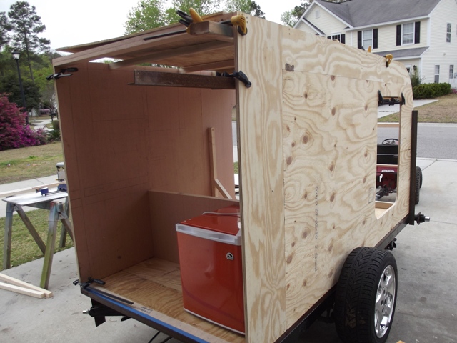

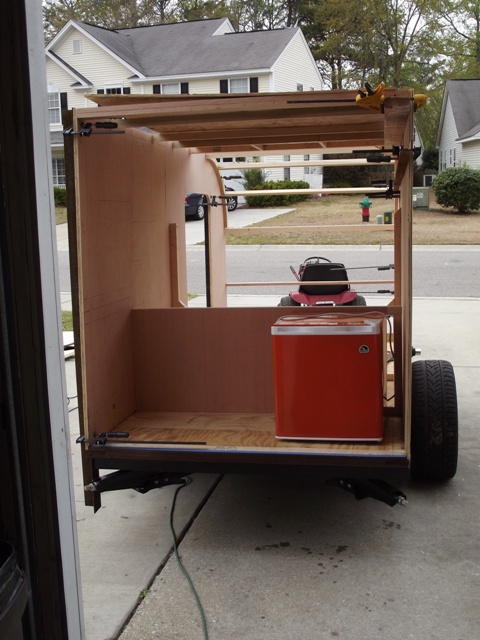

OK, yesterday was very productive despite the 3" of rain we received. I was able to get both pieces of plywood bent (inside and outside), the center wall is constructed, and the overhead cabinets for the kitchen are cut, glued and screwed. Hopefully, this afternoon I can pull the Bug around to start mounting everything in it. If I can get the cabinets in today, I will be able to finish drilling, routing, and pulling wires tomorrow! I'd love to be able to have power by COB Sunday! :shock:
First things first.... I have to get that bent piece of plywood installed for the inside ceiling today :worship: hopefully, it'll fit and the box isnt warped too bad. As of my Tuesday post, I had all that bar stock clamped to the trailer trying to pull about 1.25" of warp and bowing out of the trailer..... when I chacked it last night, many of the clamps were loose and about to fall off which means the humidity and wet weather have had an affect on the plywood (positive one)... pix coming this afternoon! To my "Not so internet savy" Dad in Ohio, Hey Dad! Welcome to the web-forum world. :thumbsup:

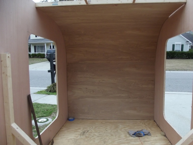

OK, so I had a day off today and instead of working on the house, teardrop, or anything else of importance, I broke out from my normal activities and played paintball with my 12 year old andf his friends. For 7 hours! :cry: WOW, am I going to feel like a Mack truck hit me tomorrow! I did work on the Bug for a couple hours this evening.
I tore out the wall between the cabin and the galley and scraped it! I'm staring over again on the wall. This time, I built a 4" recess in the wall at the lower level so my water tank would clear the faces of the cabinets.
I then installed the interior plywood to the front of the cabin area.... tomorrow, the center wall gets built and paneled, the wires will begin to be pulled and all the 110V electrical will get completed (I think)! Anyway, updates to follow.....
