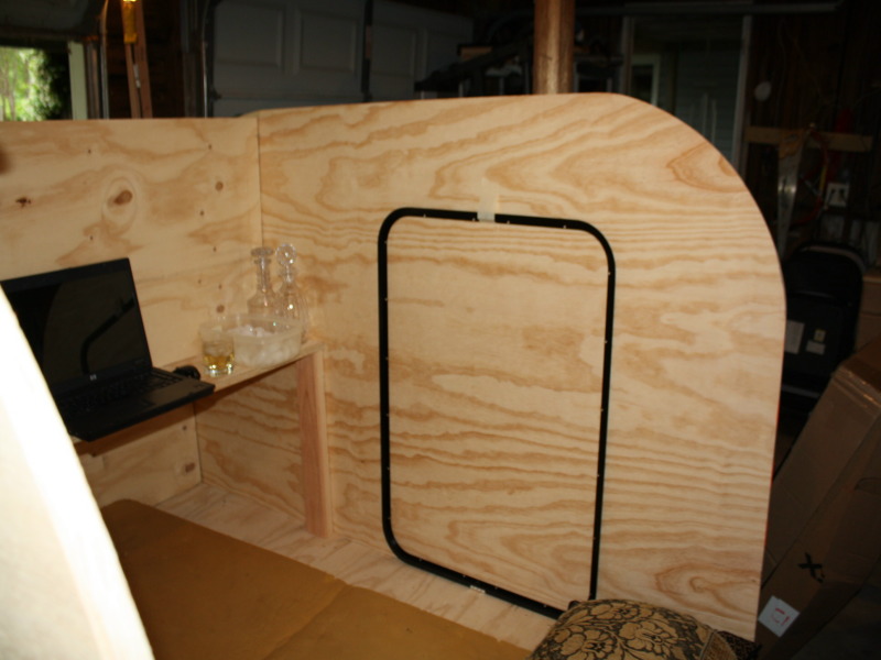

The door template/position

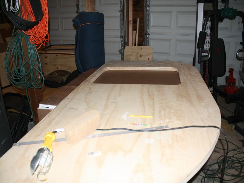

The cut...

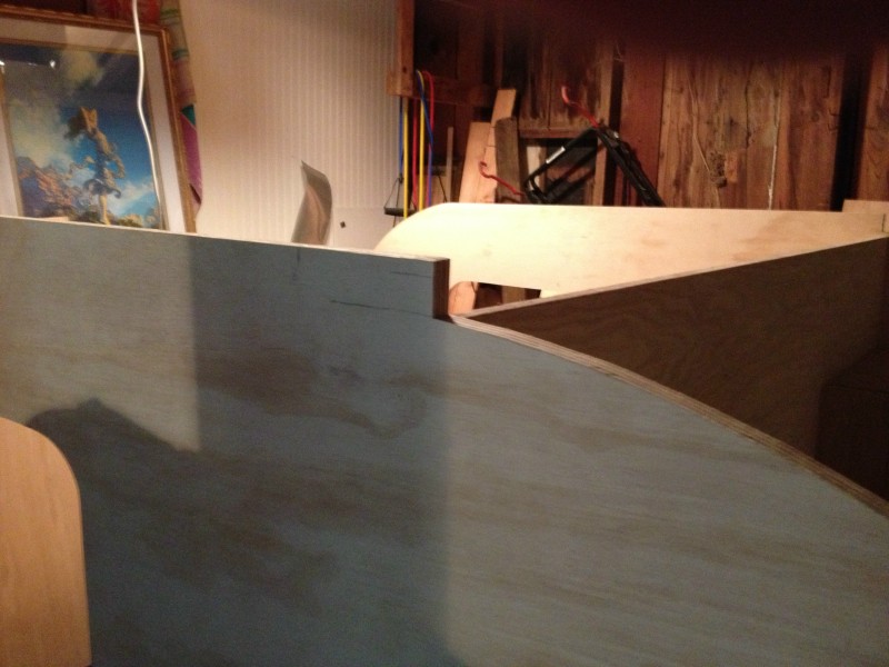

The next picture is the cut I made for the hatch.

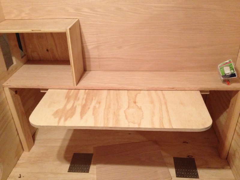

As I buttoned up the walls to the floor and frame I realized that the galley shelf was short. So I had to redo it. I picked red oak and paid a lot more attention to my cut. I then built a slide out table to give me more working space inside the cabin. With the cut right on the money, I went ahead and glued and screwed the walls to the floor and the cabin shelf.

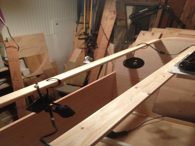

With the walls secured, it was time to screw int he roof struts. Once that was done, it was time to measure off and place the fan and lights.

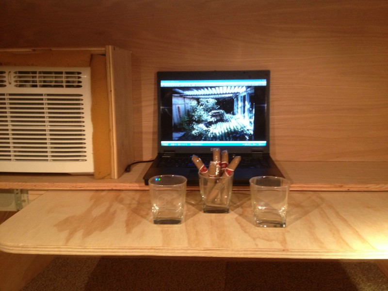

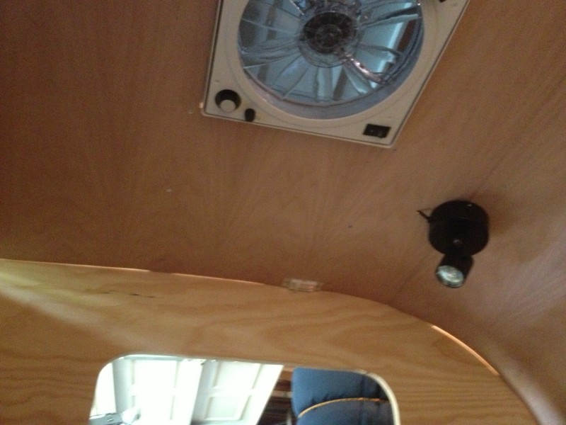

I was feeling down right skilled at this point. So I went ahead and cut the interior roof panel. I realized that I needed to make the interior roof exactly like the exterior roof so the fan would line up and I would know where to put a strut to secure it. So I traced out the fan on some 1/8 inch red oak and made the cut. I slipped that into the cabin. The cut was so tight it was hard to move around in place. I finally decided to pull it back out, sand it down some and try again. It was much easier to handle and the gap by the wall is hardly noticable. I secured the top piece starting at the hatch side going towards the front. ONce that was in place, I cut the other piece that would go down to the floor. I overlapped the two pieces and you can hardly see the seam. I then attached the lights, drilled holes for the cord and wired it up. I spent about two hours making custom light switch holders because they were too thick and would push up my exterior roof panel. BUt once I had the interior panel in place, I didn't need it after all.
Lesson learned: Don't make any decisions after 6 hours of work in the hot sun. Call it a day, have a drink. There is always tomorrow.
In this picture you can see the red oak roof, the flush mounted dimmer switches just above the door (so they are easy to work while standing outside), the swivel lights, and the fan.

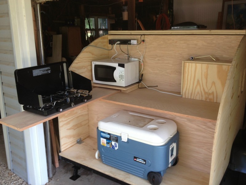

My electrical system consists of two power strips. It does the job. I have left room to add batteries later. My guess is that most, if not all, of my stops will be in a park with hookups. I finished out my portable table. I can use it for the stove when I need extra room. It fits directly on top of the shelf. So when it is not being used, it doesn't take up any space.
