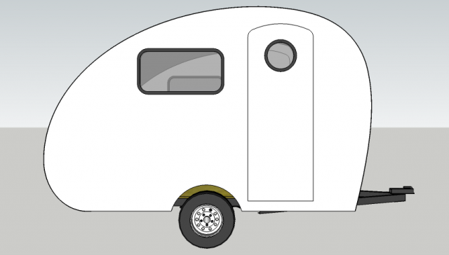

The design would have to be changed if you do not move the wheels back. It will affect the shower room and main entry door location. If could look at the plan when I am home in a few days to see what you could do to not move the axle if that is what you chose to do.

Thanks Dan. I am just having trouble understanding why it's so important to move the axle, could you please clarify for me?

Its about Balance.
With the traditional teardrop having a kitchen in the back you need to balance the trailer by moving the pivot(Axle). This will produce the desired tongue weight.

This is not a traditional TD. It is basically a full camper with the galley at the front.
If I move the axles more to the rear then this would have to mean that the tongue weight will increase as with this van there is not much weight in the rear. I am hoping the tongue weight to be around 35-40 kg's (70-80lbs).

Postby danlott » Wed Jun 05, 2013 11:40 pm
Here is a picture of the sidewall with the wheels in the standard location that is on your trailer. The layout of the cabin would be the same, only the wheel wells would change. With this current layout the wheel size would have to remain the size that came with the trailer. I will email you the file.
Edit: I just looked at your frame picture on the previous page. The fenders you have would probably work for the wheel wells. You would have to close off the side of the fenders that face inward.
