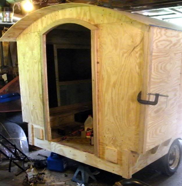

didn't get a lot done today. Fit the windows , did some insulating and insulated and put up some ply around the door opening. So I can bend a piece to wrap the layered opening.

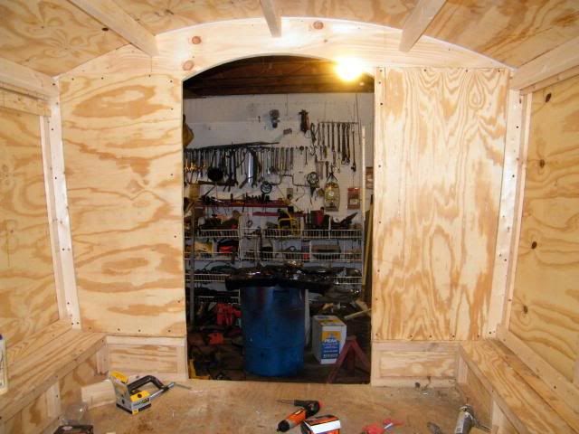

finished insulating the walls today. Then did a bunch of stuff that kinda goes unnoticed. Countersinking screws, seam sealing, finished framing the door, mounting taillight mounting pads selected some nice ash for the door and some nice oak for the frame. I'll spend part of my holiday tomorrow making the door frame and the door. The wood is still rough cut. Time to fire up the 20 inch planer and the unisaw and get building. 8)

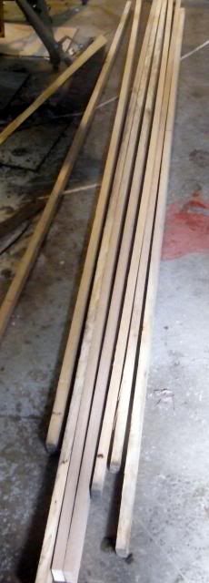

Postby stonykill » Thu Jul 04, 2013 2:35 pm
went through my rough cut lumber pile today. Found some mildly spalted birch. So I planed and ripped to make the trim pieces.
also made the door opening mouldings and test fit one of the corner mouldings.

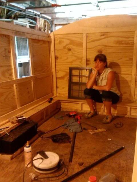

Your build is coming along beautifully, too. I saw the picture of your wife, sitting on the ledge and it made me wonder....What is the purpose of that ledge that goes almost all the way around the bottom portion of the cabin? It's obvious that you added that intentionally as the wheels already had wells built around them. :thinking:
her name is Mama. She broods 3 to 4 times a year. She loves raising babies
Look at the picture of the outside and you will see what the ledge is. Added space. I added the corbels to the outside which added 6 inches of living space on 2 sides. The added foot width allowed us to be able to sleep across the width rather than sleeping lengthwise. Giving us more usable living space. Inother words without the ledge the width is just over 5 feet inside wall to finished wall. With the ledge it is 74-1/2 inches finished interior wall to finished interior wall. I'm 72 inches tall. Perfect. :D

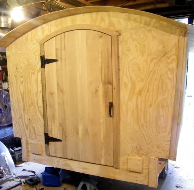

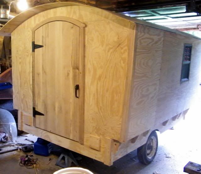

Postby stonykill » Sun Jul 07, 2013 3:30 pm
spent a couple of hours on the Vardo today. The door is cut out, sanded and hung. Bondo'd up a ton of screw holes and seams as well.
it was hot and the baby ducklings (who were raised by a chicken) decided a nap in the pool was a good idea.
