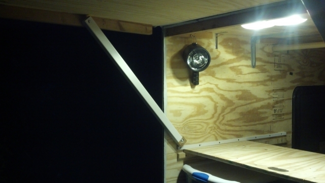

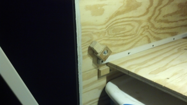

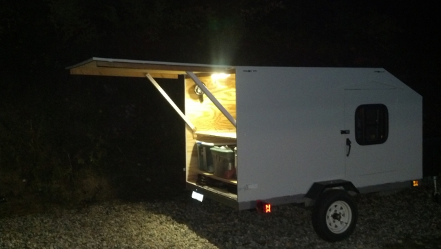

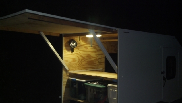

Postby Cantputt » Tue Oct 01, 2013 12:20 pm
Put some "struts" in to keep up my rear hatch and get rid of the pole. Just some PVC rectangular tubing I had from a railing project. Cut a tenon to go inside the tubing. I have locking pins to put through the tenon I can add but I'm not sure I need them, going to see how things go. The hatch is really heavy, the tenon goes into the tube over an inch. That is a lot of lift at the back edge. Probably will do the better safe than sorry and add them.
