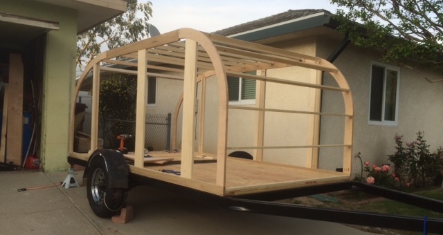

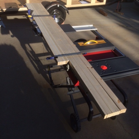

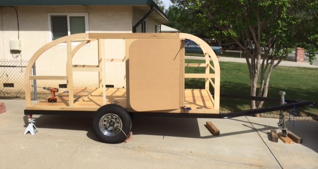

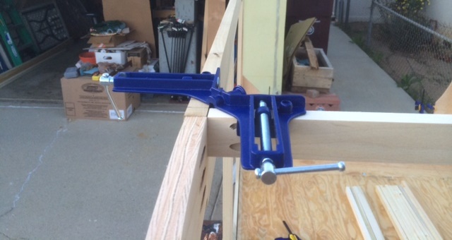

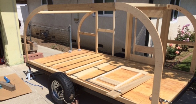

Got a little bit more done yesterday and today after work.
I cut my struts all at once to get them all the same length.
I was wondering how I was going to hold the struts and screw them on and then I remembered I had corner clamps. (I don't remember if I seen it used here on the forum.) It really helped me and with a lot less struggle.
Got all the struts on and the frame for the bulkhead.
I am using the Kregg pocket hole jig and just fitting the frame all together and then I will take it apart to add the inner plywood and insulation. Then I will glue it and screw it back together.

Re: Benroy style build 5x10
Postby S. Heisley » Fri Mar 21, 2014 10:10 pm
The shape is looking nice! Good work! :thumbsup:
No, I haven't seen anyone here use a corner clamp before. ...Interesting.

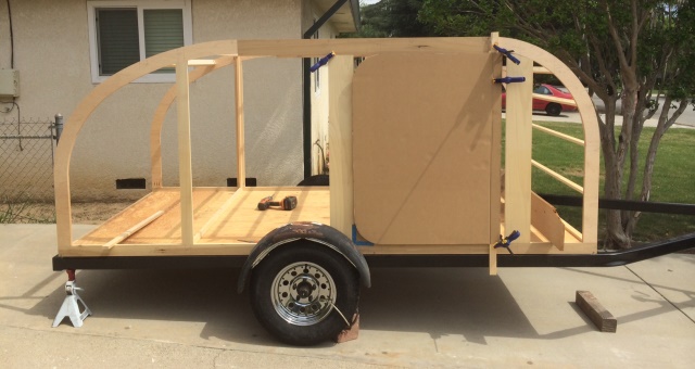

Postby jimun » Sun Mar 23, 2014 11:02 pm

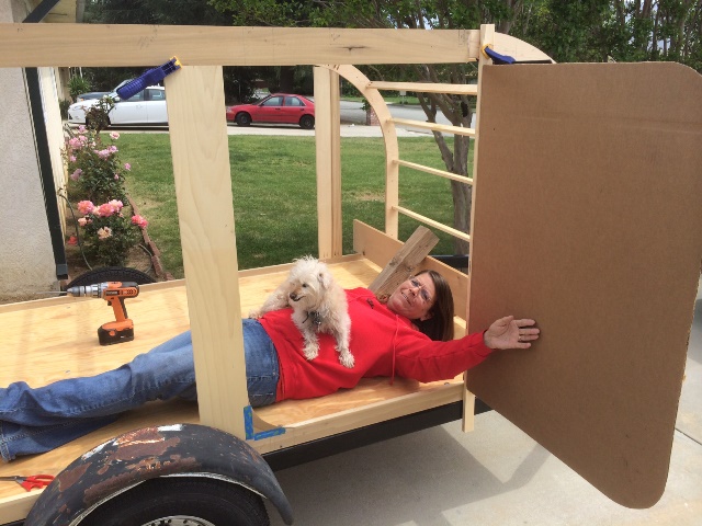

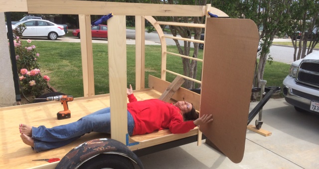

Ok so today I worked on the door location. First I changed the style of door, then I checked the height by clamping a 1x2 across at a 36" opening. 36" is a little short for me. I hit my head sitting down and that is without a mattress. So I decided on 42". Now I made a cardboard cutout of the size and shape of door I want and then I moved my door struts back about 6", as suggested by some that have visited my build here. Then I clamped the door on to check it out. I also place a board at the location of the headboard and tried it out. It worked out pretty good. I also got the vent supports installed between the roof struts.
I asked my wife to come and try it out. She said it works for her.Image
And now the dog had to get in on it.
Then it was time to pack it up for the night and head to hd for more wood to finish the sidewall struts and supports. I will try to get more done this week after work if it is not raining.

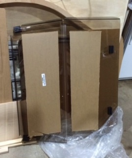

Here is the golf cart windshield. I have to cut it out and test it to see if I can make it work. 8)

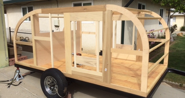

Postby KCStudly » Sat Apr 05, 2014 10:33 am
Looking good and shaping up nicely!
What are your thoughts on stick building in place vs. building flat and erecting the walls as units?
You are getting good results, but I would have thought it would be far easier and take less time to work "in the flat".

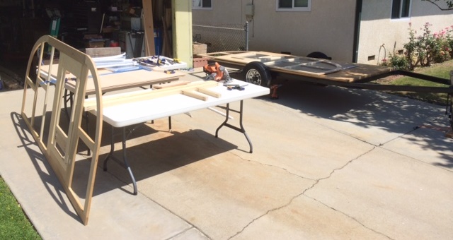

Postby jimun » Sat Apr 05, 2014 5:28 pm
KCStudly wrote:Looking good and shaping up nicely!
Hi KCStudly, I guess seeing it visually as I go helps me bring it together and make things fit. On working out the layout for
cabinets, bulkhead and bed it just seemed easier to me to stick build it as I figured it out. I had the outer wall framed glued
together and just screw the struts and supports in temporarily so I could make changes as did for the door and I could work on
both sides at the same time. If I had built it on the flat I probably would have set it up and taken it down several times just to
see how it was fitting together. Also when I did pull all the struts and supports out I was able to clamp all my joints together
straight as I glued and screwed it back together. I got one side done today.
Struts and supports removed and set to be glued and screwed back in.
Here it is all back together
I also got my inner wall skins cut to fit. I did this first this morning and then I started on the side wall.
After I get the other wall framed glued together I am going to remove the walls to glue the inner skins in place along with
some insulation. Then the plan is to do a little more work on the floor and the permanently attach the walls.
(I Think, I will know when I get there)Image

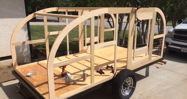

Postby jimun » Sat Apr 12, 2014 8:55 pm

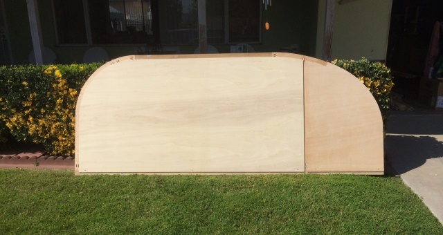

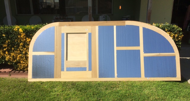

I got my other wall glued and screwed back together yesterday.
Today I took off the roof struts and removed the walls and got the 1/4" ply cut to size for the ceiling.
Got the insulation cut out for the walls.
Glue the inner wall panels and the insulation on the wall frames and stacked some weight on to it.
Tomorrow or later next this week I hope to finish the floor with some paint and finish the inner walls
and ceiling panels with a clear coat, maybe with a light stain before I attached the walls and install the ceiling.
I was going to take a picture of the gluing process but I got busy and with the glues on to keep the glue off my
hands I did not want to get glue on my phone. To glue the panels I used the PL glue and spread it out with
a home made spreader (This is the same way it is shown in Scott's Workshop - Teardrop build on youtube. You
can see his videos of his build here: http://www.youtube.com/user/octopotomus/videos)

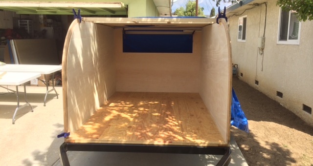

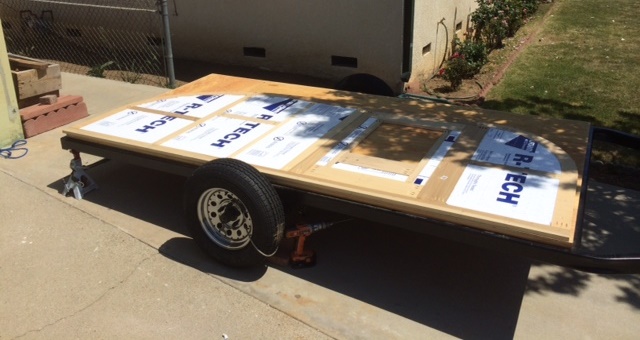

Postby jimun » Mon Apr 14, 2014 11:34 pm
Here is the finished work of gluing the inside panels and insulation on the walls,
